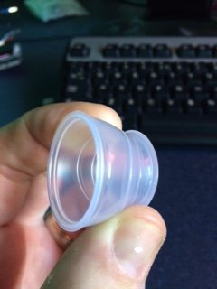

    I don't know about you, but on my sim, my Pots are the only item on it that kind of "stick out" and can be kicked by excited kiddies of forgetful Dads!
    I used to have a plastic box over them but it looks a bit...well... crap.
    I was sat in the car the other day drinking a Powerade and noticed the top cap is pretty much the same size as most Pot's we use.
    Kept hold of it, took it home and sure enough they are perfect for protecting the wires on exposed pots.

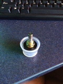

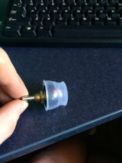

    Simply drill a hole in the back / or side and feed your wires through and then either double sided tape it on or use Hot Glue around the rim of the lid
    Some pictures:
    The Lid:
    Pot inside: (Enough space to run some double sided tape around the Pot)
    Plenty of clearance at the back.
