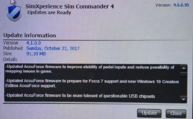

    Yeah I did. My Accuforce now works with Forza 7.
