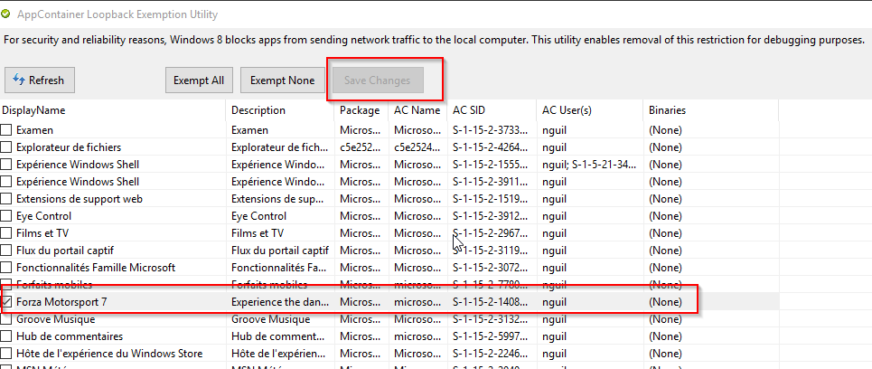

    Hi ! to enable localhost on forza simply use this utility :
    Windows 8 AppContainer Loopback Utility (available here https://www.telerik.com/fiddler/add-ons)
    In the app, check forza and save:
    Then you can use 127.0.0.1 in the game settings and avoid any tricks to get telemetry on local computer.

    i try this.. save, and nothing happens.. any idea? if i put my ip, and 4122 port, ok.. all its fine. But change on loopback program, and save, dont works. This is my point: simvibe works on 127.0.0.1 and 10001 port. simtools works on my ip, and 4122 port. Perfet, IF loopback program works.

    Simvibe adds the exception too, just like loopbackutility does, the issue like you pointed out is that you can't share share UDP accross two ports there can be only one "listener", I don't know if simtools offers a way to broadcast udp data to multiple targets, at least i've not seen it.

    But in this case, the simtools should work correctly through ip 127.0.01 right? but it does not work...
