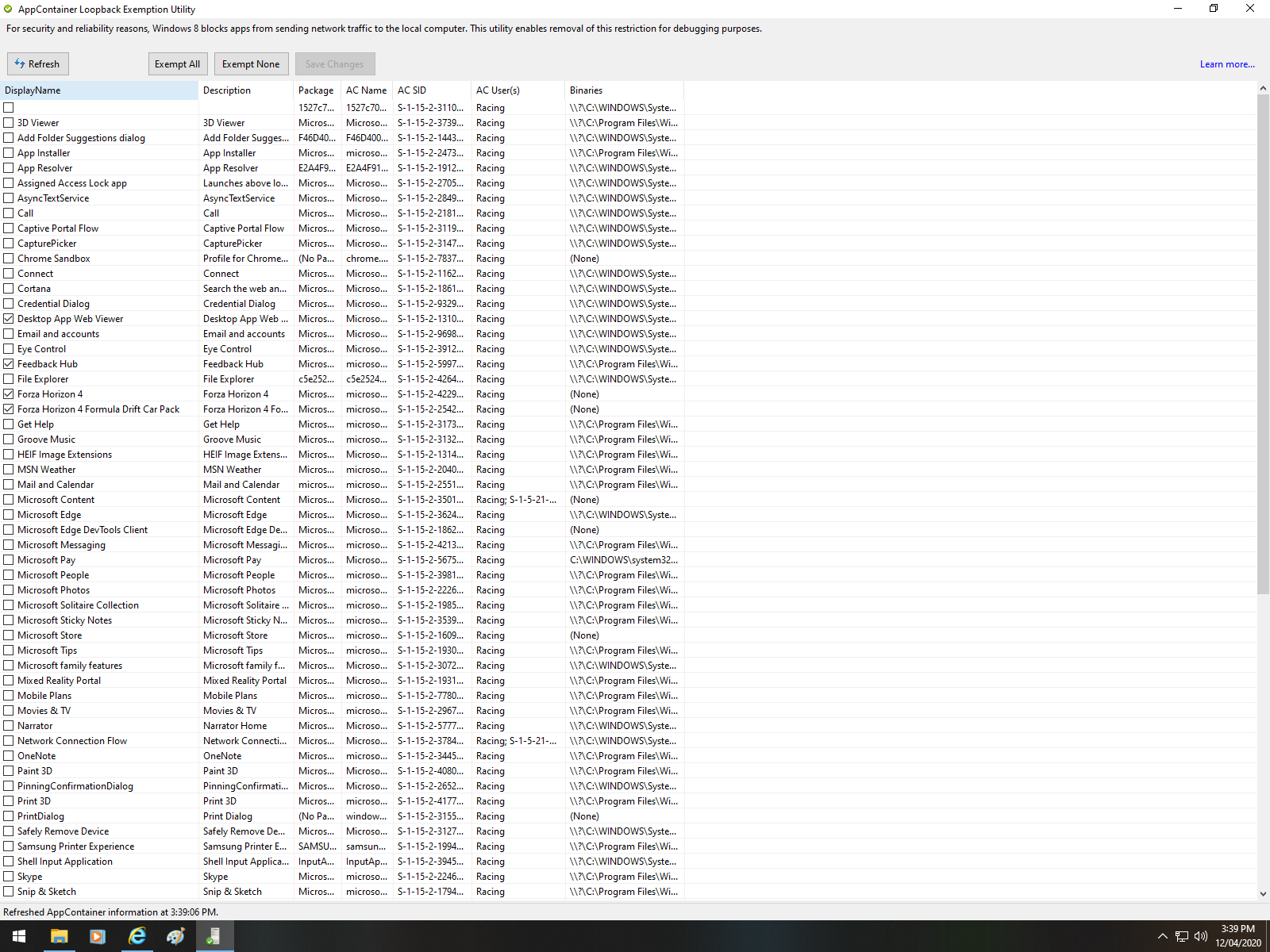

    horizon4 loopback.png this is the program I used, the ip address and port are correct. attached is the program. unzip, run and select horizon4 as shown in pic, save and everything should work.

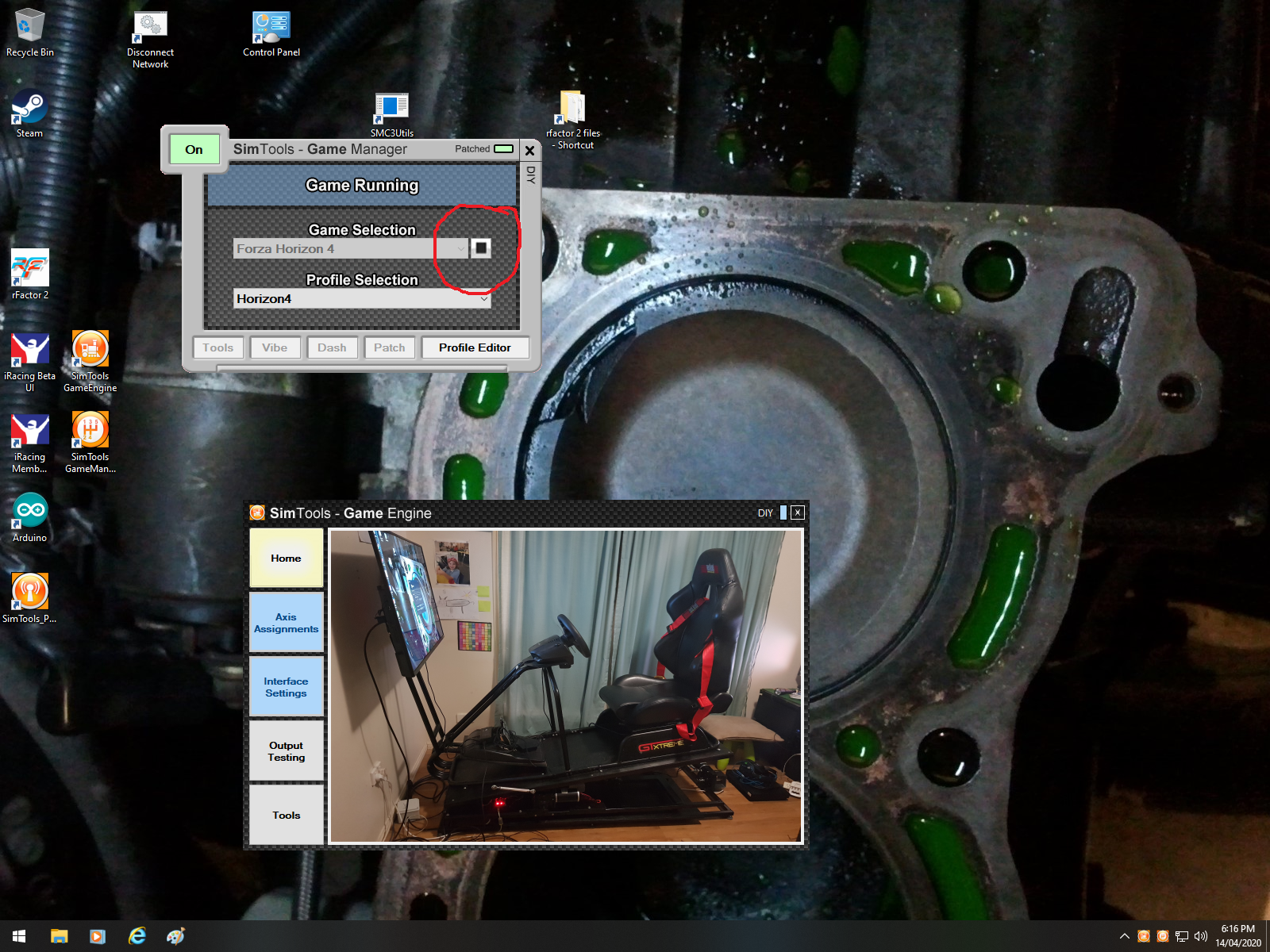

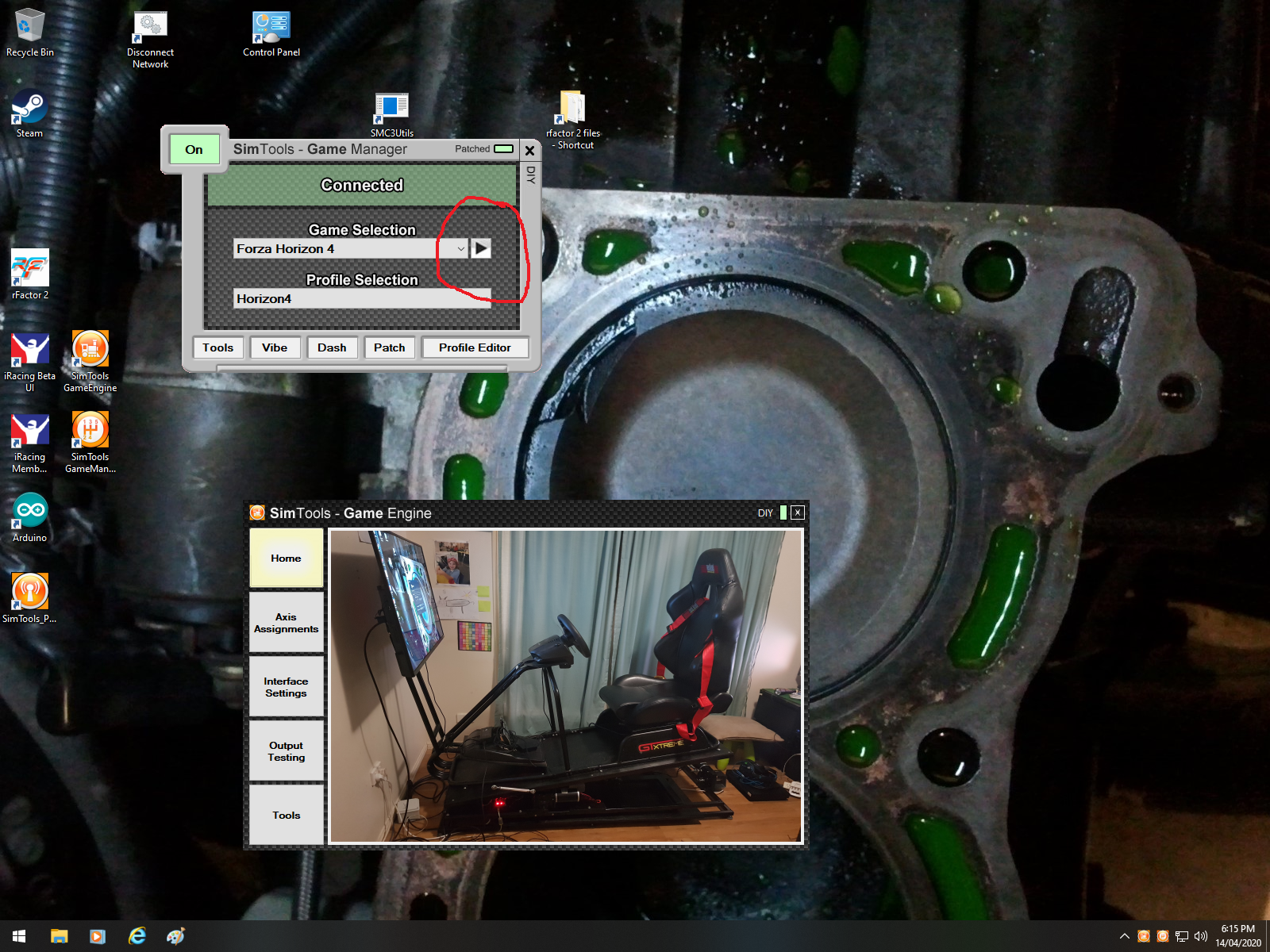

    @Sam MAHENDRA ok with my modified plugin its the same as forza7. with game engine running and game selected there will be a play button to the right as seen in the manual start pic, the second pic is after you select the play button, at the top the bar goes blue and displays game running and the button has changed to a stop button. see other pic.
    now I can play and have motion on xbox .
    or if you are trying to make your own plugin, then you need to remove the process name.
    The settings for xbox are the same as forza7, goto settings, then hud and gameplay, turn on data out, set ip to computer that's running simtools, port 4123 and save.

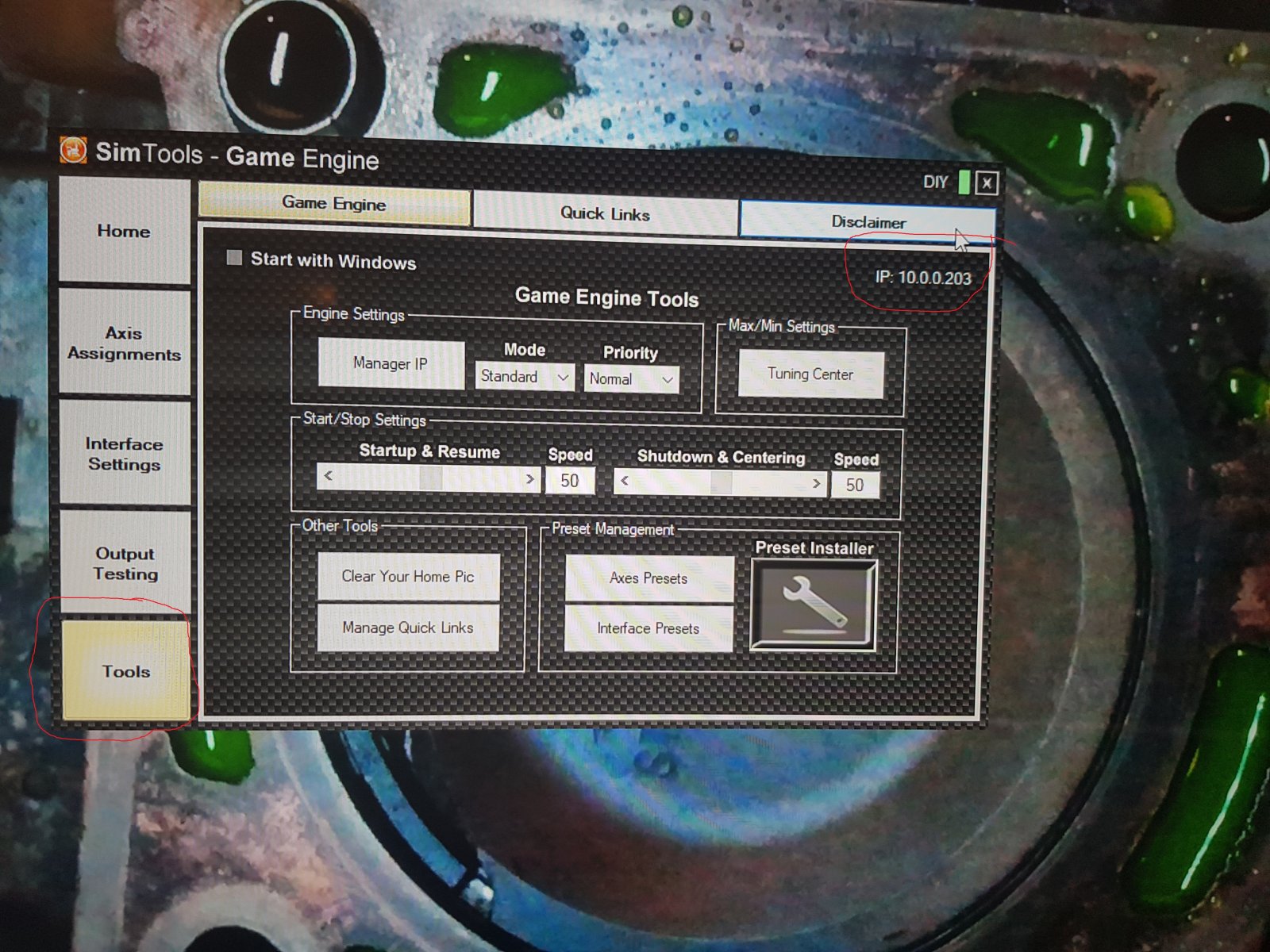

    i hope this is what you are asking.
    Open sim tool game engine, then click on the tools button on the bottom left side, then in the top right hand corner will be the computers ip address.
