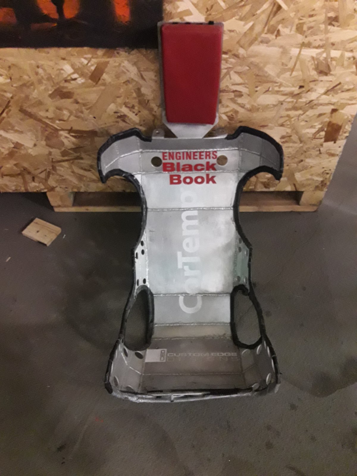

    I'm a member of the University of Alberta's Formula SAE team where we design and build a formula-style racecar every year to compete at international competitions.
    This year I'm converting one of our old chassis into a simulator and looking for some feedback.
    Here is the aluminium seat from last year's car:
    The black part is a foam liner for our smaller drivers - I am not planning on using it.
    @SeatTime suggested that we start out simple (and hopefully cheap lol) with a gSeat (P.S. @SeatTime I would love to hear your thoughts on this idea since you seem to be the gSeat master around here :D).

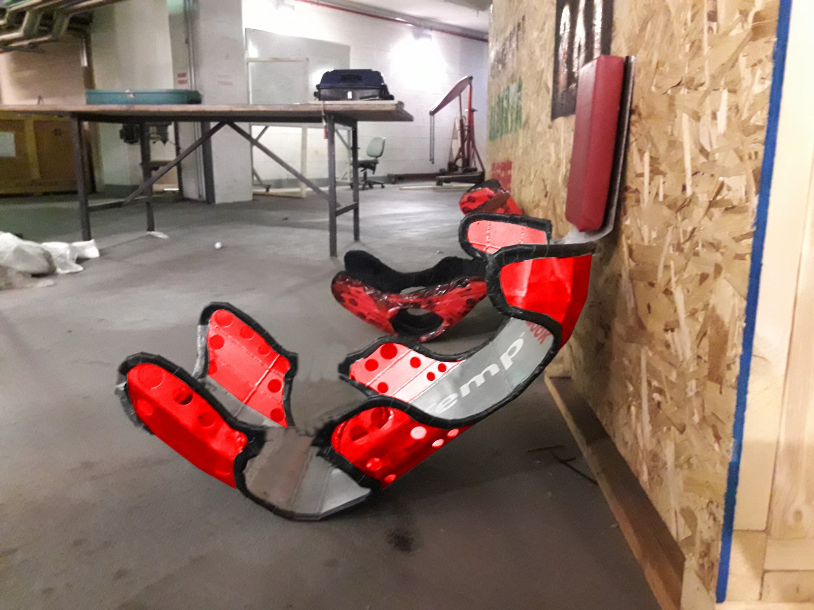

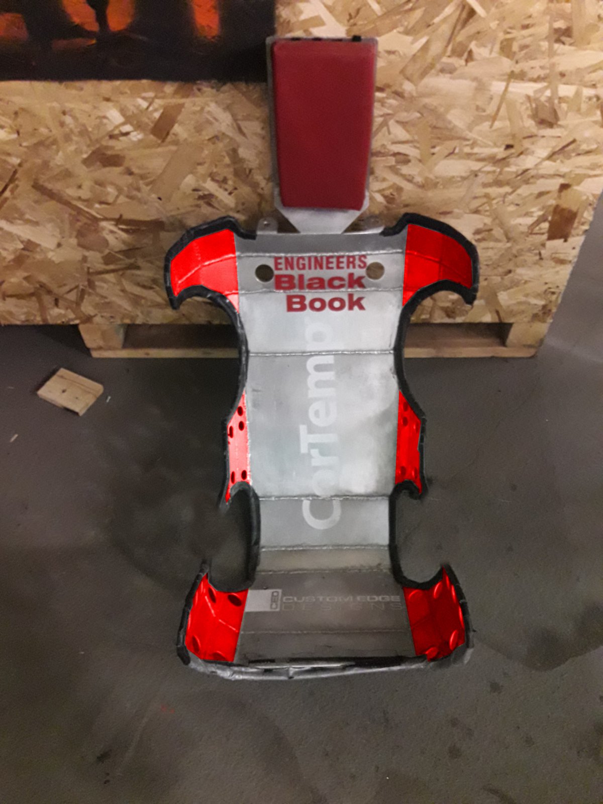

    My thought is 6 servos to independently actuate the following parts of the seat (please excuse the awful photoshopping):
    Because these are the side portions of the seat, hopefully the servos won't need to be too big to be effective.
    A few questions:
    • Many different sized people could be trying this - what effect will this have on the effectiveness of the gSeat. Is there an easy way to adjust the seat for driver size on the fly? This will hopefully be used at promotional events so anyone from a kid to a large adult might try it...
    • Because the seat is aluminium, my thought is that we'll add hinges to enable actuation - could pinching be an issue? could this be mitigated by a thin layer of cloth or something? I'd love to hear other solutions or suggestions
    Thanks all!

    Your dead right, a paddle setup like that would need to be fitted to the driver for a decent effect, which is why most are more behind the driver which unfortunately puts more load on the servos - need more, or bigger servos. For something that is to be used/thrashed by the public with a variety of different sizes and your budget is not that big. I would go even simpler with just some servo controlled harnesses. They can jump in adjust to size as in a real race car and off they go with no issue with overloading the system with heavy drivers. I have many customers who have no motion, but VR, DD wheel and servo controlled harness and they love it. Good VR makes allot of things possible.

    Thank you @SeatTime ! That totally makes sense - I see what you mean about the paddles being behind making for a better experience for multiple people.
    I'm currently looking into getting something like Takata's drift harnesses. All of our team's old harnesses are 6-points and have difficult to use latching mechanisms (some of our drivers even have issues when doing egress drills).
    Hopefully as parts of the simulator start to come together, we'll be more attractive to bigger sponsors which might allow for bigger servos on a gSeat and eventually a full motion platform.
    VR is definitely in the cards!! I'm glad to hear it can be so effective :)
