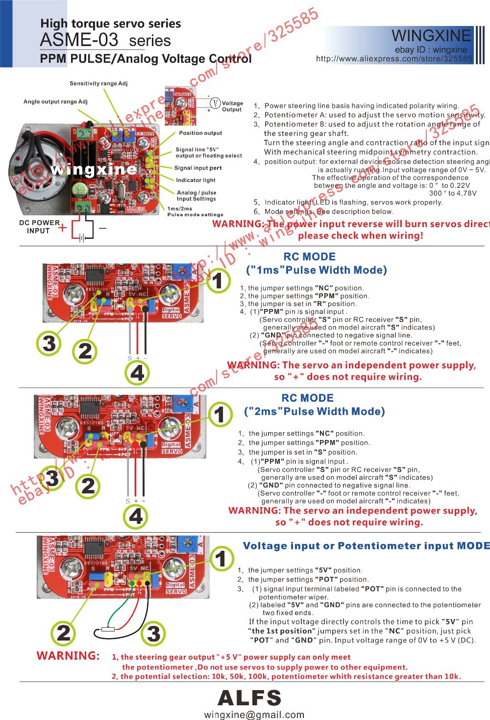

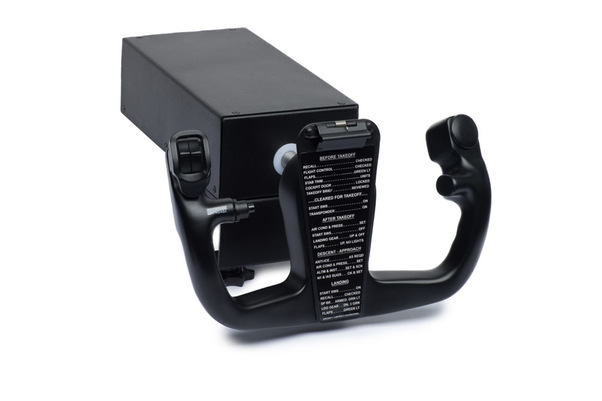

    I'm working on an idea to convert my yoke to force feedback. I'm starting with a nice sturdy steel and aluminium unit that's great apart from the awful spring loading.
    My idea is to use a pair of spare servo motors that I have lying around to hold position and provide resistance to movement. I hope to use the SimVibe upgrade to @value1 's AeroFlyFS2 plugin to get data on engine rumble and ground to build in a bit of shake of the yoke. What I can't get my head around though is how I will control the degree of resistance. I could vary the voltage perhaps but is there any other way?
    The servos I have are 110kgcm and take a 24v input with control via (with the settings I usually use) 5v, Grnd & Signal. It has other modes I haven't used before as below:
    Any help gratefully received
    Phil

    I imagine that you ran across this article but if not check it out.
    I have assembled most of the parts but not all.
    And I have yet to 3d print anything....:think
    However I have studied all the drawings/videos/instructions available...
    It uses the guts out of a Microsoft FFB 2 joysick.
    No need to interface with Simtools if you are using Xplane/FS/ or Prepar3d.
    XPforce software https://www.fsmissioneditor.com/
    https://vrflightsim.wixsite.com/mysite/finished-stuff
    https://www.youtube.com/watch?time_continue=14&v=NqdmvQMBWLo

    Thanks. I know the site but hadn't seen the video. I'm actually finding this whole project very daunting - to make it effective requires plenty of software too.

    I guess the nice thing about the FFB Yoke is it is a working unit.
    No re inventing the wheel. There are other modifications to increase the force by factors of 4 which lends to its versatility to be used in other configurations.
