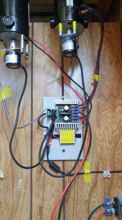

    Is better to have the limit switch at the top or bottom of travel?
    Do the motors all move at once (6dof) or individually?

    What do you mean?
    For mover? We don't need limits for the software. They should act on the hardware/controller.

    Sorry I should have explained. I'm using encoders with kangaroos and 2x32 Sabertooths, so they will need to be homed every time it starts up. I could be missing something.
    I'll cleanup the wiring after everything is running! : )
    Kudos to the software development!

    @PaulB
    I may be able to help. Ive recently gone through a setup with similar hardware.
    The only difference in my case was I did the initial tune by mechanical limits (with limit switches diconnected) and then added afterwards a single limit switch for homing on each startup.
    In your case, the initial tune would be to tune by limits or tune by teach.
    After tuning, you can set the start up homing to drive to a limit of your choice, top or bottom, or both for a bit of extra safety
    It was easier to do all this with the Describe software. I used the version 3.9 Beta with no problems. I did have some issue with 3.7 but cant remember what it was.
    https://www.dimensionengineering.com/info/describe
    Let me know how you go.

    Thanks JAD: I'll try that for tuning. This is a lot to sort out again!
    Did you get things going with FlyPT, and did you change the Simtools interface parameters from your Build photo in
    JADs 6dof with ballscrews?
