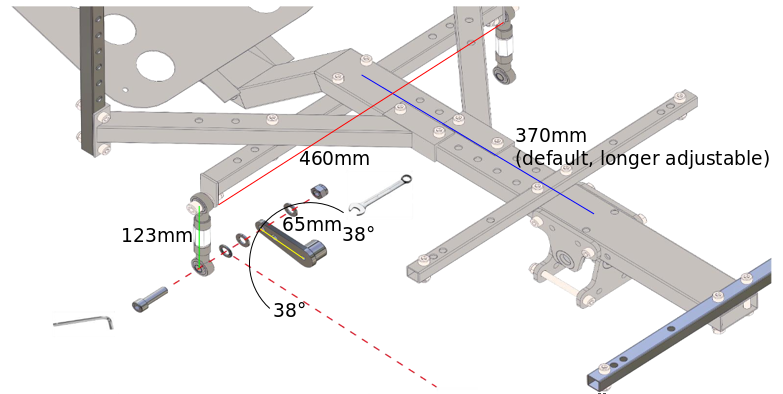

    +43 / 1 / -0
    Will the next version also contain documentation for custom actuator definition?
    I have a dofreality 2dof platform. It does pitch and roll. The two actuators are mounted in a triangle, where one end is the center of rotation. It sits below the seat. This means pitch=average of the two actuators and roll=differential between actuators. Since the actuators are rotary motors with a crank, possibly a sine translation from rotation to movement needs to happen, but I am not sure yet whether that is done in firmware or not.
    I would be very happy to provide geometry and to research the protocol to help you make it into a standard preset. The dofreality 3dof is very similar, it uses an extra motor to pivot the whole 2dof platform to add sway.
    Right now, I am struggling with the actuator definition, not really sure how to add correct geometry to the custom actuators. I guess some mixing needs to happen somehwere to translate roll and pitch into this triangle geometry.

    get the measures in a photo and I can setup the rig to use in Mover.
    Tell me also what model are you using (M2, H2, P2?)
    You can use custom actuators, but only with linear actuators for now.
    To setup rotating ones, I have to make it in code right now.

    I am using the H2. I think that in the P2, the only geometrical difference is the slightly longer crank arm.
    My measurements for the H2:
    Crank arm: 65mm
    Linkage: 123mm
    Actuator distance: 460mm
    Actuator centerline distance from pivot: 370mm
    The crank arm moves 38 degrees up and down, so total range is 76 degrees.

    The platform uses an Arduino with SMC3 command set, hope that helps.
    I am looking forward to 4.0, stringing things up like in node should make this super powerful.
