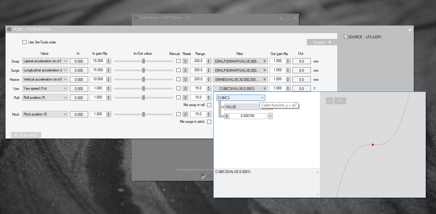

    @hexpod @pmvcda how can I add a "classical" deadzone to the filter of heave? For example to DCS, I want to heave doesn't move if moves are less than 2-3mm, but let it move when they're bigger.
    Now my filter is:
    EMAHP(EMALP(LOGISTIC(VALUE;180;2);500);500)

    Use the CUBIC3:
    As you see in the graphic, it adds a dead zone around zero
    Replace VALUE with the CUBIC or add CUBIC over all the filtering you already have (might be better)

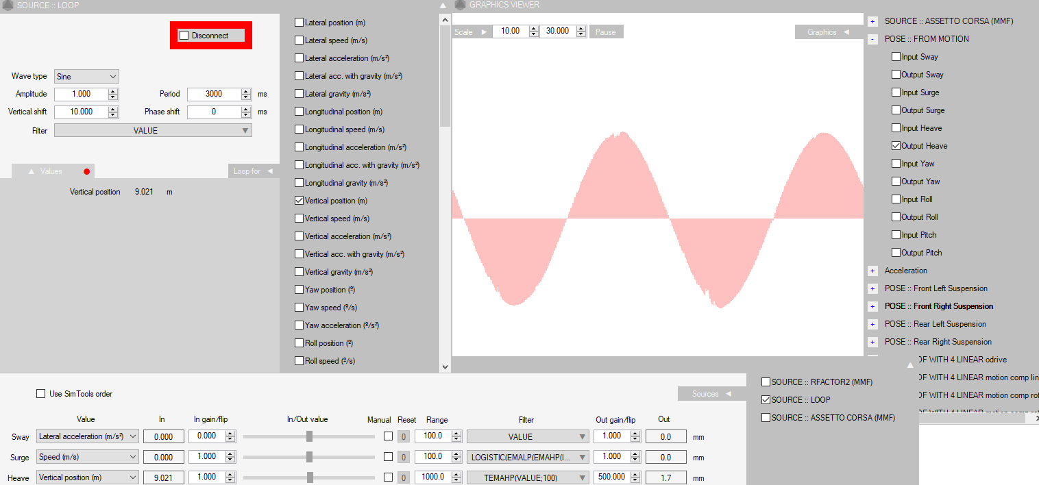

    Hi, I've discovered some numerical problems with high pass filtering, see an example here: highPassProblems.png
    The input is a pure sine, put the filter result shows some severe distortions which occur irregularly. I wanted to use vertical position with a high pass as heave and it basically worked but I noticed some strange vibrations in my actuators so I had a look at the signals and it looks like there's something wrong with the calculations, gets worse with the order of the highpass, TEMAHP as in picture being the worst
  14. Thanos
    Jul 6, 2017
    1,380
    Electronics Engineer
    United States
    2,924Coins
    +1,079 / 10 / -0
    Are you sure that is not the servomotor vibrate itself? I use extra hardware filter to correct the pulses to minimize the vibration and noise of the motor (Rolling Average Filter)...
  15. cubexxx
    cubexxx Member
    Oct 4, 2019
    69
    557Coins
    +41 / 0 / -0
    3DOF, AC motor, Arduino, 4DOF
    The distortions that you see in my picture are purely a software (mover) thing, there isn't even a servo involved...
  16. pmvcda
    pmvcda aka FlyPT
    Nov 3, 2010
    2,280
    Portugal
    15,950Coins
    +2,733 / 18 / -0
    It's not a calculation error (just checked the filters code).
    I think it's a thread problem.
    I'm going to look at it.
  17. pmvcda
    pmvcda aka FlyPT
    Nov 3, 2010
    2,280
    Portugal
    15,950Coins
    +2,733 / 18 / -0
    Found the cause. It's the timer.
    Will be solved in the next build, if possible.
    You are scaling an high pass 500x, any small variation in the calculation time causes caos, because mover is using number of samples.
    If you use low resolution calculation time, you are going to get even worst results.
    I'm working on a new version where those problems are going to be solved (at least I hope).
    It's still at the start and still working on the base structure, but it will be completely new.

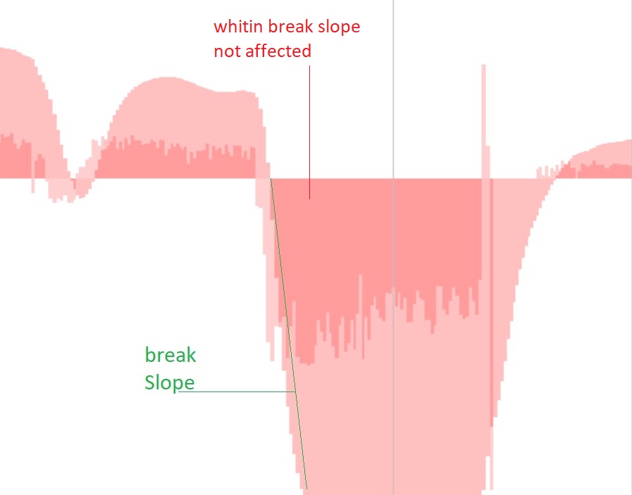

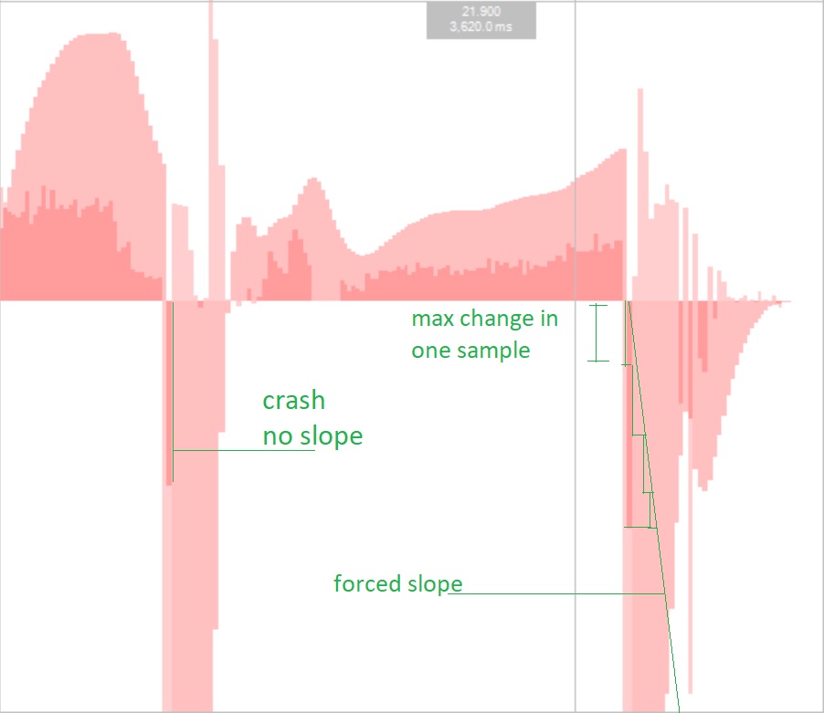

    Hello, I am looking for all the FILTER masters out there. Here is my problem.
    I have a crash that provide a great change in the value (here, the longitudinal acceleration). It goes in a straight line in the negative. I would like to to force a slope to those big change with a max change in the value in can go apart from the last sample.
    But here's the trick. I have break value that are close and within that slope, and I don't want them to be affected what so ever by the filter.
    Anyone has an idea how to do that?
    Thanks.
    Pierre.
  20. Pierre Lalancette
    Dec 11, 2016
    1,012
    Tech Artist
    Quebec, Canada
    8,052Coins
    +947 / 6 / -0
    3DOF, DC motor, Arduino, 6DOF
    After thinking about it, I found out what I would need to do this.
    It is a Relative Clamp.
    It is a clamp that would center itself to the last filtered value of the force. So, every times a force tries to go to strong, it would be clamp in a slope shape, and every change within the clamp max value would not be affected.
    I don't think it can be done right now, but I don't think it would be hard to implement. And I really think it would be quite useful. What do you think?
