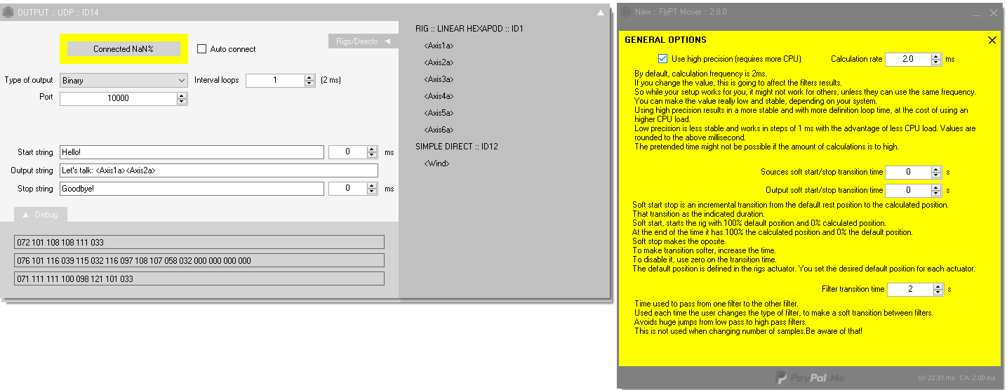

    3DOF, AC motor, Arduino, 4DOF
    Hi, pvmcda, setting the soft start/stop transition times to zero (0) doesn't seem to work correctly, I get a "NaN" on the output connection status, see attched image disableSoftTransitionBug.png
