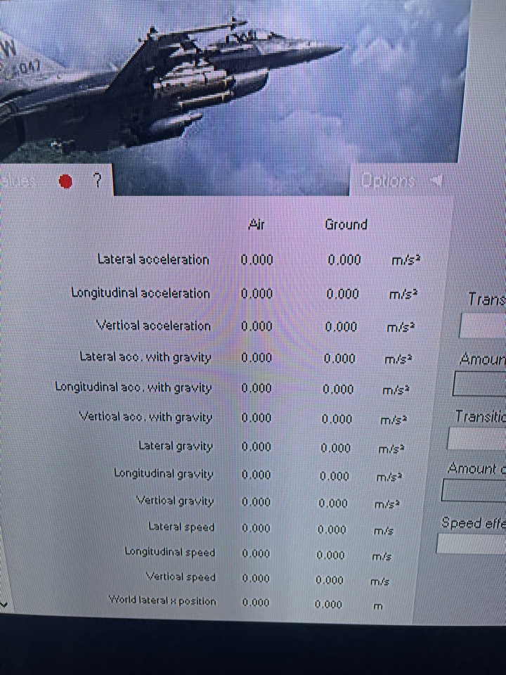

    Did anybody try mover with the new version of BMS?
    4.37 has vr support now and I briefly tried mover with my motion platform but I get a weird behaviour in pitch.
    I use Pitch speed but when I do a looping at the top of the looping it has a strange behaviour, similar to what the old dcs plugin (not the experimental one) was doing in simtools.
    I think it has something to do with the 180 degrees inversion but I am not sure...
    Also say I am level on the horizon and I roll 90 degrees, so now one wing points the ground and the other points the sky, then I pitch, but there is no pitch motion.
    Any Ideas?

    @hexpod
    Thanks for trying to help.
    I think you are right, Falcon BMS doesn't output pitch angular velocity (speed).
    This is what it outputs, and it is similar to what Msfs does.
    What would you youse instead of Pitch angular velocity?
    Thanks again for the help

    542Coins
    +17 / 0 / -0
    Actually I made a mistake, if I scroll down on the sources I can see the Pitch angular velocity (Degree/S) correctly listed in the available sources.
    The problem is this..
    When the sim is running and mover is connected, Pitch angular velocity has a meaningless value.
    It is always 0 and it jumps to something different than 0 when I pitch up for an instant but it returns back to 0 and it does it so fast that I can't even read what number it changes to in that instant.
    Any idea of what I could use instead of angular velocity?
    @pmvcda
    Any chance you could check the Bms source to see if something is wrong?
    Probably it has nothing to do with mover, it might well be something is screwed up on the shared memory of BMS

    +337 / 5 / -0
    DC motor, 6DOF
    « Pitch angular velocity has a meaningless value.
    It is always 0 and it jumps to something different than 0 when I pitch up for an instant but it returns back to 0 and it does it so fast that I can't even read what number it changes to in that instant. »
    It returns to 0 even if you keep continue to pitch ?? The value should correspond to aircraft angular rate. (Not Angular Position). Check the roll speed… also strange ?

  14. gianlu320
    gianlu320 Member
    Feb 9, 2018
    76
    Crawley
    542Coins
    +17 / 0 / -0
    @hexpod Thanks a lot for your suggestions .
    Pitch angular velocity returns to 0 even if I continue to pitch and the same behaviour happens with roll.
    Let's say I do a tonneau, so a continous roll, the source (Roll angular velocity) is 0 at the starting of the roll, it randomly changes to some value instantly (i can't even read the value) and it goes back to 0 but in the mean time I am continuing to roll.
    In pitch is the same...
    I do a looping, and at the start of the looping the value is 0, it changes instantly to some unreadable value and goes back to 0 but in the mean time I am continuing with my looping manoeuvre so a continous pitch.
    I tested only roll and pitch, separate and together as well.
    When I test pitch only, in a looping when the nose is 90 degrees up (pointing the sky) as soon as I cross the 90 degrees and the artificial horizon inverts, the motion platform goes full nose down.
    When I test roll only, in a looping when the nose is 90 degrees up (pointing the sky) as soon as I cross the 90 degrees and the artificial horizon inverts, the motion plaftorm goes full right (Bank full right).
    When I test pitch and roll together in the same looping, again 90 degrees up, as soon as I cross the 90 degrees up and the artificial horizon inverts, I get the motion platform full nose down and at the same time, the bank full right.
    Sorry for the long post, but I want to give as many details as I can.
    I tested these weird behaviours quite carefully and can confirm that Dcs and MSFS behave properly on my motion platform using roll and pitch angular velocity.

    I think what he means is to let Mover do the maths to derive it from another value. I am not sure of his proposed solution though.
    I am assuming to you want the rate of pitch change. It looks like that what you are seeing is pitch acceleration, not the rate of change.
    You can calculate both from the pitch position with a mover function. DIF(pitch value) is the rate of change/pitch speed, DIF(DIF(pitch value)) is the pitch acceleration/rate of pitch speed change.

    I was able to open the game.
    DIF is a good approach to add velocity but how do you deal with the jump from 180 to -180 which occurs when the aircraft is inverted. Do we have a math for this in mover?
    I tried rollover with 180 but without success until now
