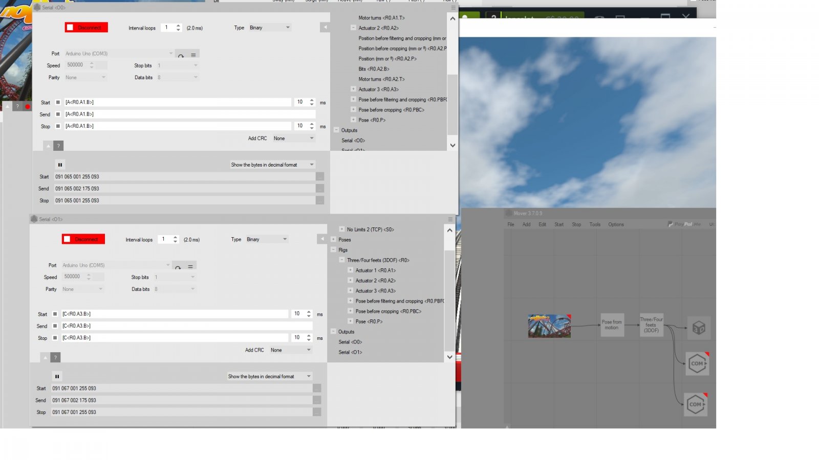

    I've tried to understand the new strings:
    [A<R0.A1.B>]
    Please Axis 1, send your data to Rig 0, Actuator 1
    it works.
    [C<R0.A3.B>]
    Please Axis 3, send your data to Rig 0, Actuator 3
    Does not work.
    I have a 3 actuators rig, 1 and 3 are up front. If I switch the COM PORT, the other actuator start to move. I see the data changing on both output and they have the connection arrow in mover main window.
    Is it a bug or am I missing something?
  5. Fors
    Fors New Member
    Sep 25, 2023
    16Coins
    Try [A<R0.A3.B>] or [B<R0.A3.B>]
  6. pmvcda
    pmvcda aka FlyPT
    Nov 3, 2010
    2,180
    Portugal
    15,394Coins
    +2,604 / 17 / -0
    How many controllers are you using? And what controller?
    Because for a 3DOF rig using one SMC controller you need:
    [A<R0.A1.B>][B<Ro.A2.B>][C<Ro.A3.B>]
    If you are using two controllers, one for each side, connected in different ports, are you sure one is #1 and the other #3? They might be both number 1 and for that you need two outputs, one for each usb port:
    [A<R0.A1.B>]
    [A<R0.A3.B>]
    But this would be strange...
    More info here: https://www.xsimulator.net/community/threads/flypt-mover-3-7-0-9.19016/page-21#post-251484
  7. Pierre Lalancette
    Dec 11, 2016
    1,006
    Tech Artist
    Quebec, Canada
    8,043Coins
    +944 / 6 / -0
    3DOF, DC motor, Arduino, 6DOF
    Ok, I got it.
    [A<R0.A1.B>] Front Right (com3 for me)
    [A<R0.A2.B>] Back (com4 for me)
    [A<R0.A3.B>] Front Left (com 5 for me)
    I use 3 arduino with 3 Sabertooth and each motor is connected to output A of each Sabertooth.
    Thanks for all the help.
    Pierre.

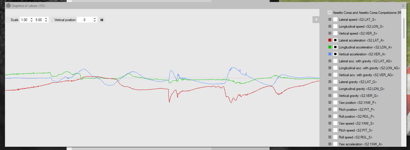

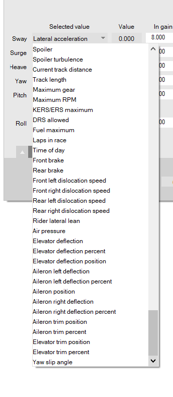

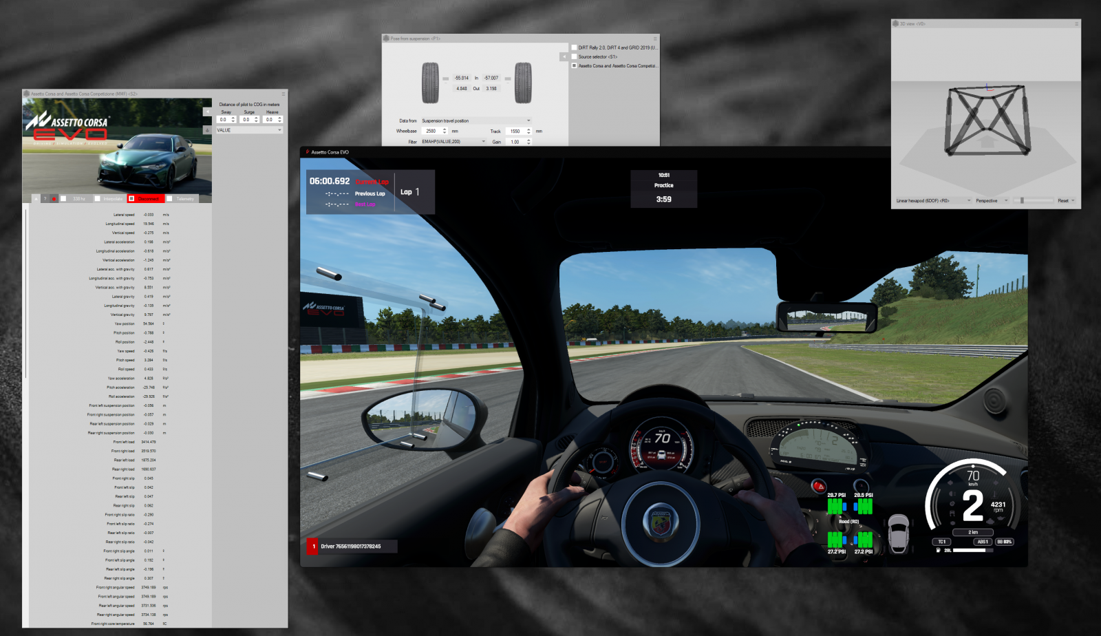

    Soon:
    Some directions seem wrong...
    Data seems to have a good resolution (frequency);

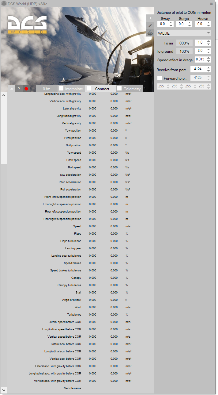

    Hi, I have a question:
    I'm preparing to build 6DOF rig for DCS world using Mover, and I want to have some specific telemetry data exported from the game, which I cannot find in any Mover's list.
    I need to somehow get "LoGetShakeAmplitude()" value used for helicopters vibration during VRS, ETL, etc.
    Is it possible to add this value to the list by editing some config files or I need to make custom source?
  10. TheTakerPL
    TheTakerPL New Member
    Dec 7, 2023
    12
    82Coins
    +11 / 0 / -0
    Also I need to add that value is read correctly in FFBeast Forcefeedback joystick which I have built - so it's possible to get it.
  11. pmvcda
    pmvcda aka FlyPT
    Nov 3, 2010
    2,180
    Portugal
    15,394Coins
    +2,604 / 17 / -0
    I will take a look. You can always replace one of the lua values by that one, but will try to add it on the next release.
  12. TheTakerPL
    Dec 7, 2023
    12
    82Coins
    +11 / 0 / -0
    Thank you. I just was about to write, that - for a temporary solution I can replace some unused value in "DCS_To_FlyPT_Mover.lua". I just need to find something not needed :D
