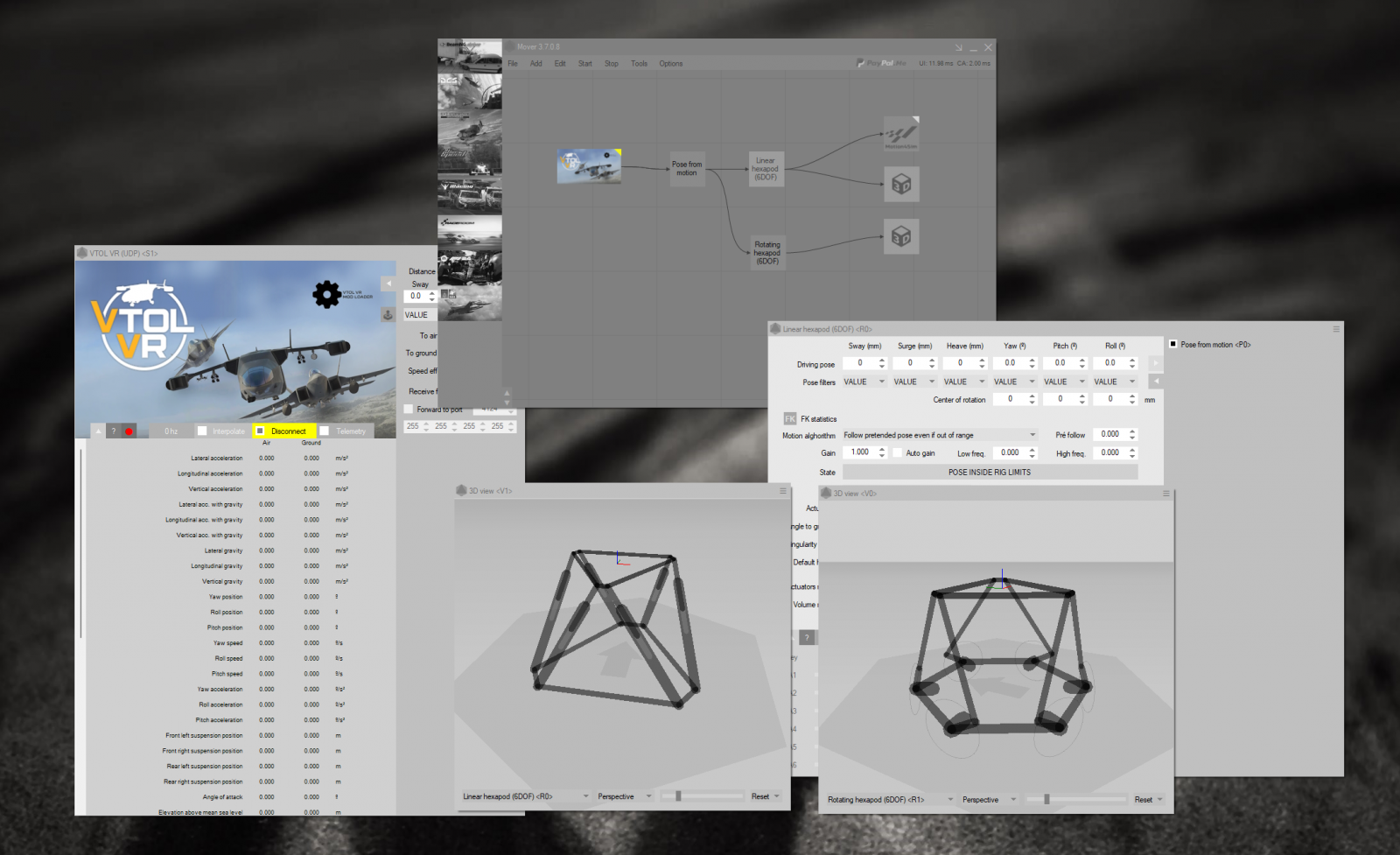

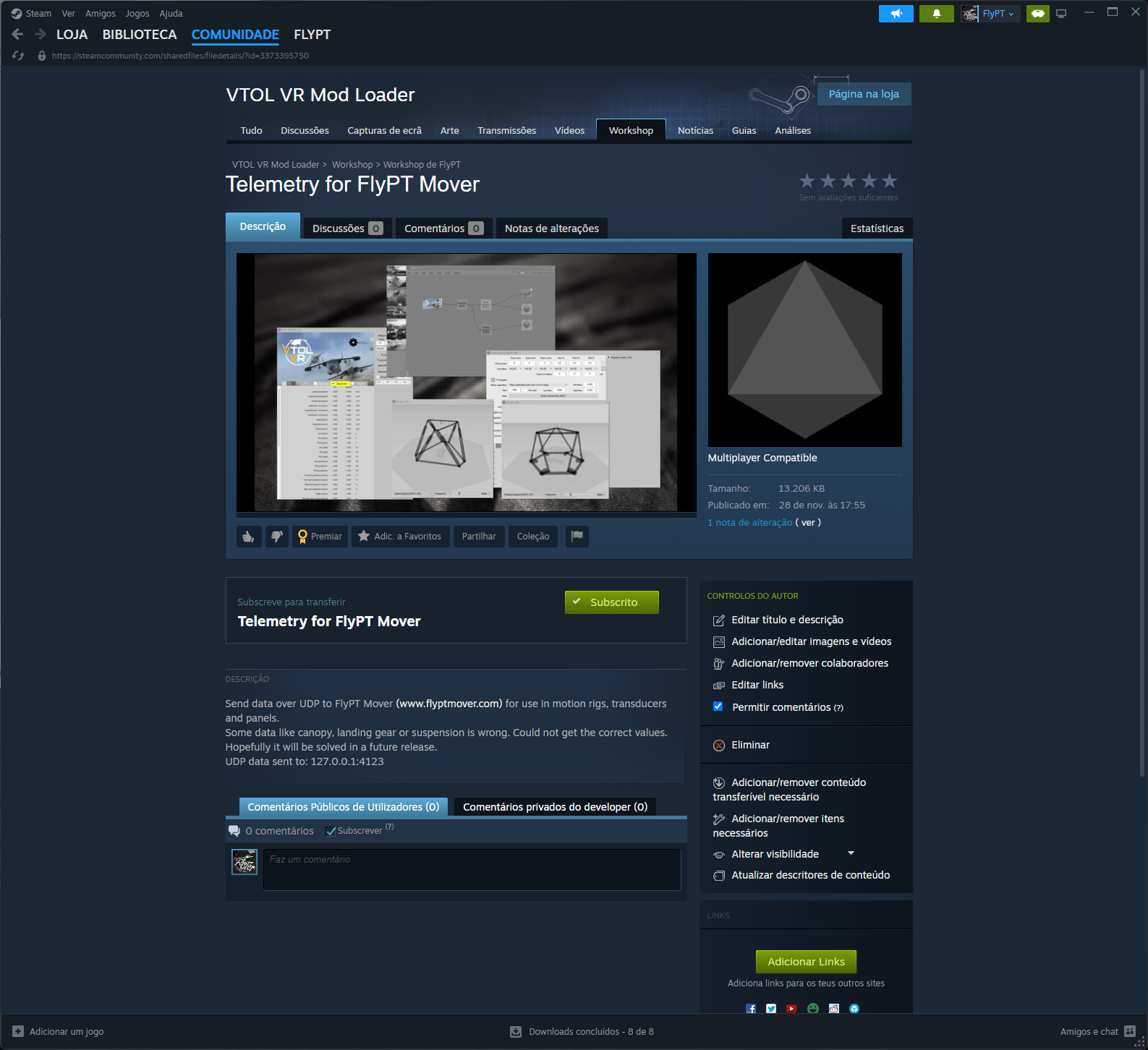

    Just released a mod for VTOL VR.
    It's on the workshop for VTOL VR Mod Loader:
    Data changed a relative to the original one, so it works only on the new Mover:
    Current Mover already includes this source.
    Unfortunatelly I could not get all the values I wanted. So some of them are wrong, but the main ones are ok.

    Sources:
    MSFS solved bug causing connection problem.
    VTOL VR now with the corresponding mod in the Steam VTOL VR Mod Loader workshop (not VTOL VR workshop)

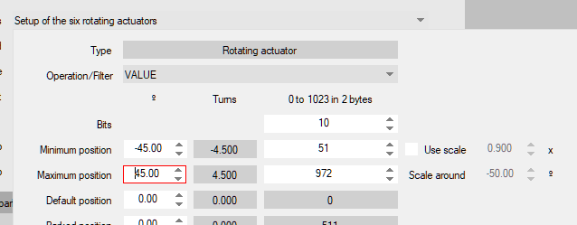

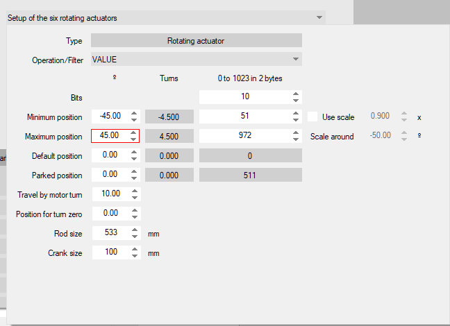

  12. Ronan Design
    Jun 4, 2021
    261
    Toronto, Canada
    1,666Coins
    +136 / 1 / -0
    @pmvcda Thank you very much for converting my rig to the new Mover. It's moving, but I have some problem with trying to scale the rotation to sync with the actual angles. First time I tried scale 0.6 around 0 and added a filter to the value EMALP(VALUE;50) - same I had on my previous file, the rig crashed. No I'm trying without the filter, but after I added a scale 0.9 around 0, closed that window, then reopen - it show some weird scaling values - I never entered -50! upload_2024-12-6_20-29-10.png
    Each time I open the dialog I see different scaling values in both fields. When I try to slowly change the scaling in any direction, all actuators keep moving down wether I press up or down arrows, until they hit the end of the range.
    Without scaling it's moving correctly in all axes, so I think you have some kind of a bug with scaling, or I misunderstand how it's supposed to work.

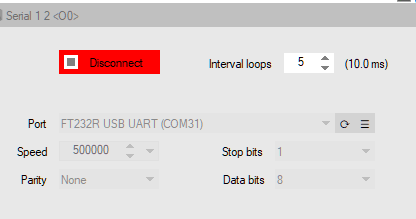

  14. Ronan Design
    Jun 4, 2021
    261
    Toronto, Canada
    1,666Coins
    +136 / 1 / -0
    Is the actuator scale the correct way to match the requested angle to the actual angle of the rig? If so, something fishy was going on there for sure. I tested twice and both ways the rig kept moving to the crash position. Eventually 2 of my temporary plastic motor arms broke. So can't test further as I won't be printing new ones because I should be able to fabricate metal ones in a few days, hopefully.

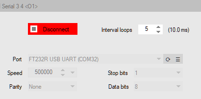

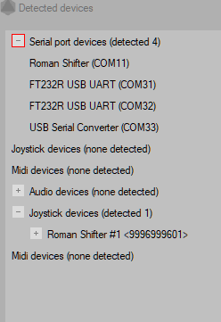

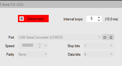

    The new Mover remembers the COM ports correctly, the old one forgot all of them. I had a similar problem with the old Mover even with 1 Arduino on my 2DOF - sometimes it saved the port, but often it forgot them and I had no idea why. There is one bug or a quirk with the ports in the new Mover. Here's how they are set on my PC:
    COM11 is my DIY button box so ignore it. The rig is 31,32,33. But here is how the Mover sees them:
    For some reason, the last one is always seen under a different name, despite the boards and their firmware being identical. It doesn't seem to affect the operation, but I'm just reporting this in case it may be a sign of something that matters.
    And just in case, I opened the scaling again and I saw the -50 again, which I never entered:
    I don't think it's just the UI, because the rig kept moving down and eventually crashed twice, despite me setting "scale around" to 0 and trying to increase or decrease the scale with the little arrows. The rig kept moving down slowly and crashed, so I think it somehow actually moved the center from 0 somewhere way outside of the range, like -50 sounds about right. I tried it several times, but I was able to press the Emergency Stop in time for other attempts not to crash the rig. The first time I left the "scale around" to its default setting - somehow it had "45" there. Or "-45", not sure. I just tried to check"use scale" and enter "0.7" that I had in the old Mover. That didn't go well. Then I tried the same with "0" in "scale around". And got the results I described.

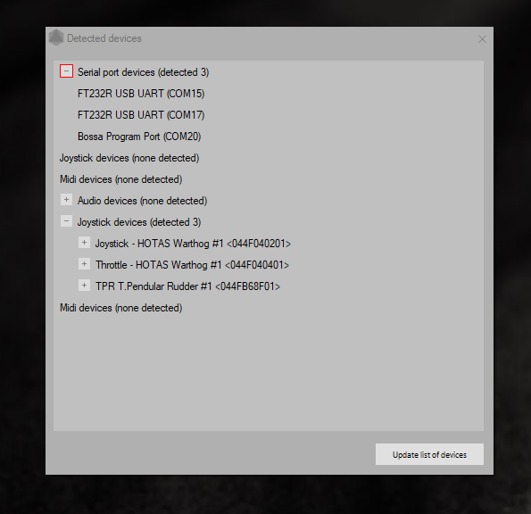

    Thank's,
    I checked the code and from what I see, the error is when showing the scale because I make a mix of updates in the controls. The UI is causing the mess.
    I'm correcting it right now and making a revision on the actuators to be sure. (removing default that is useless also).

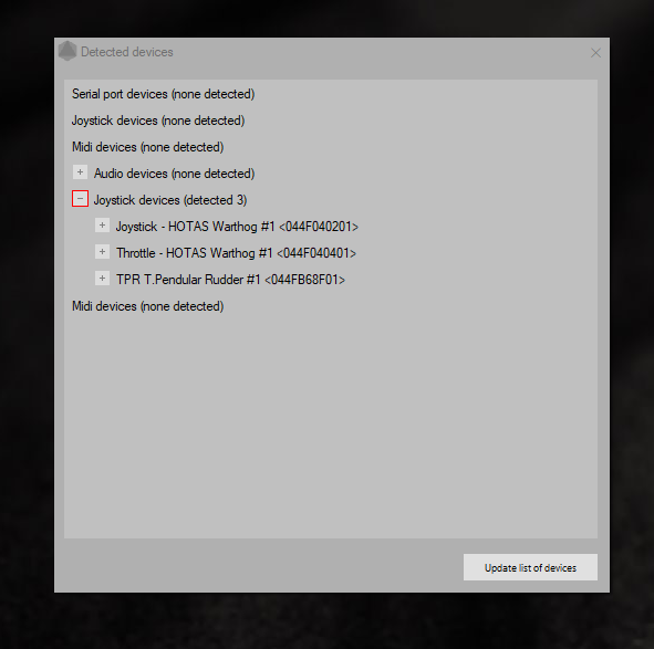

    For the USB, can you go to tools->devices and expand the joysticks.
    You get something like this:
    Post here so I can check one possible bug in the naming.
    Edit:
    Please expand also the Serial port devices...
  16. Ronan Design
    Jun 4, 2021
    261
    Toronto, Canada
    1,666Coins
    +136 / 1 / -0
    Somehow I see Joystick and Midi sections twice
