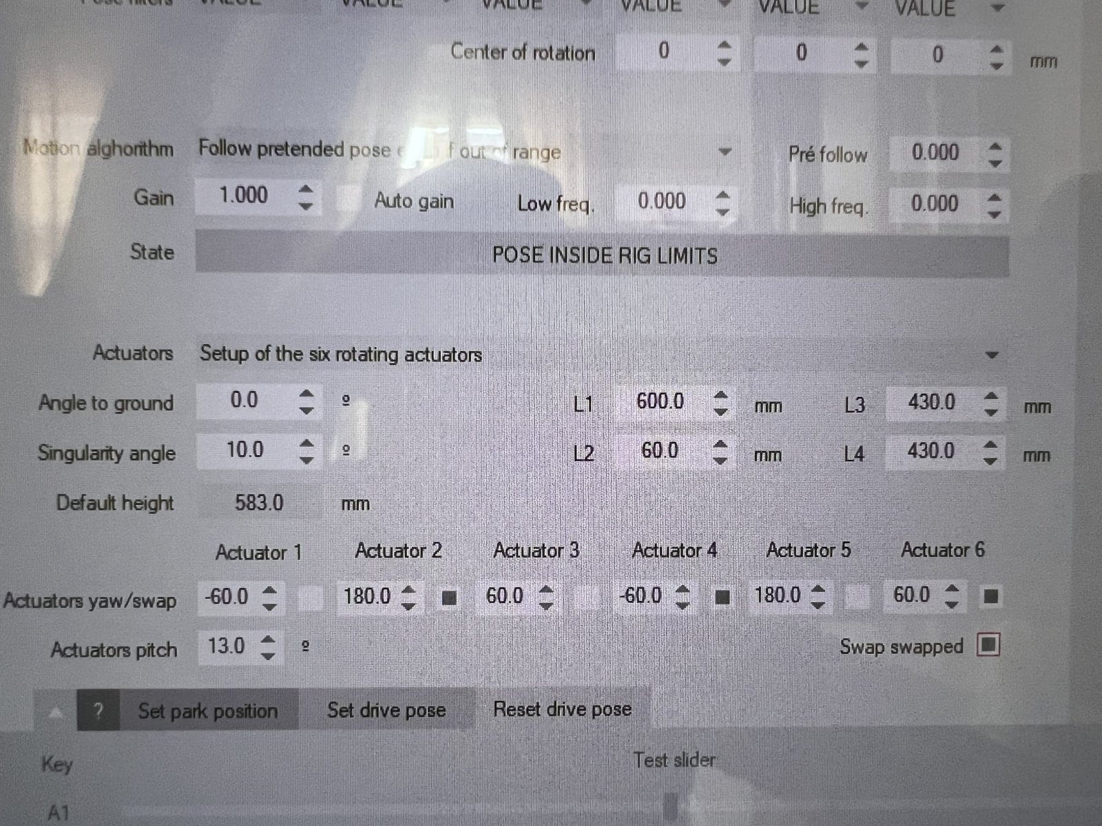

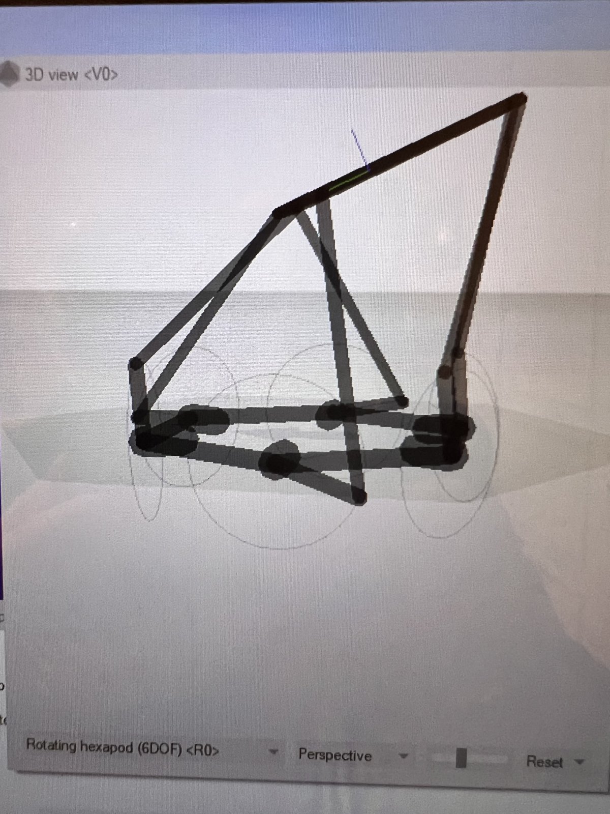

    DC motor, 6DOF

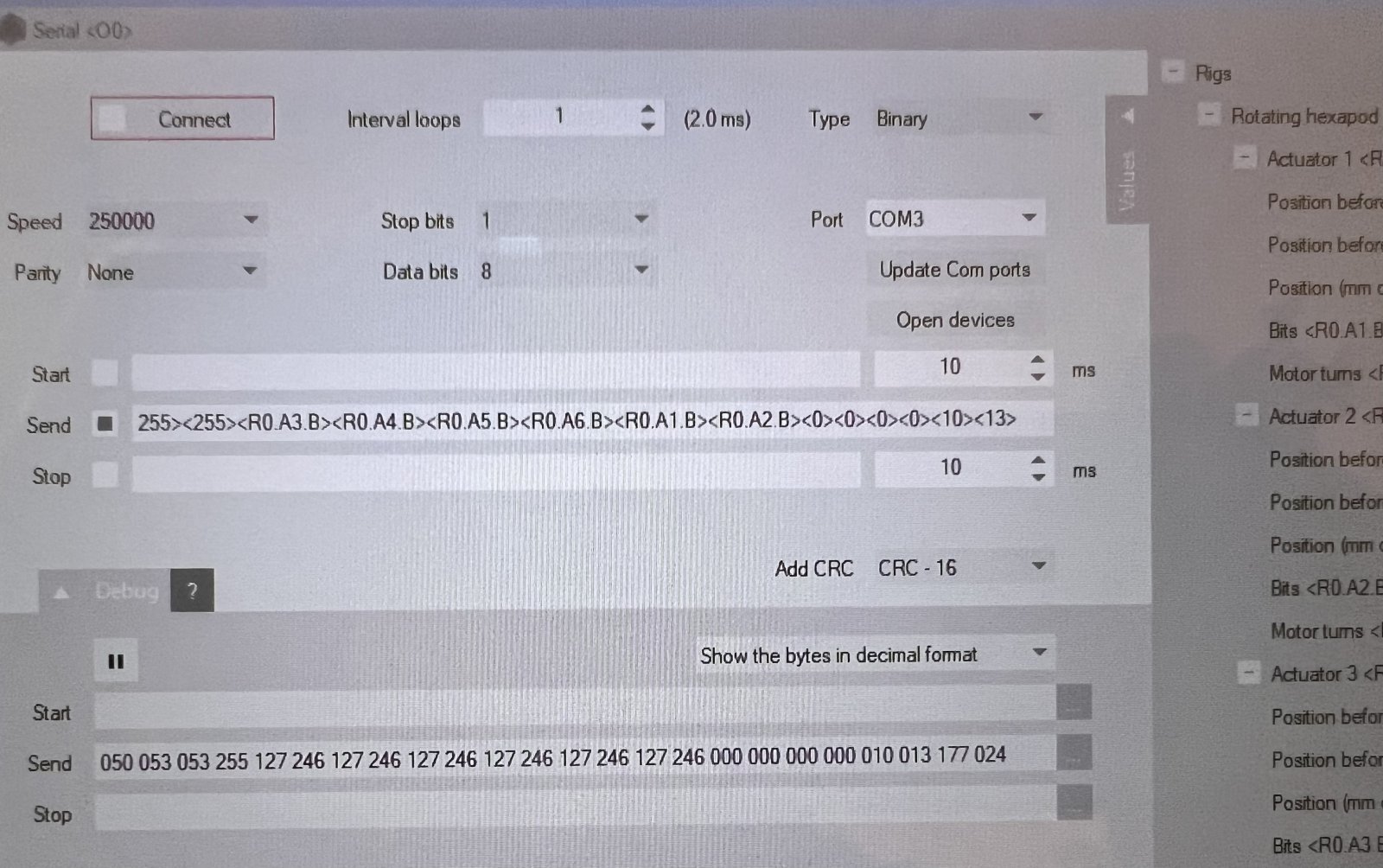

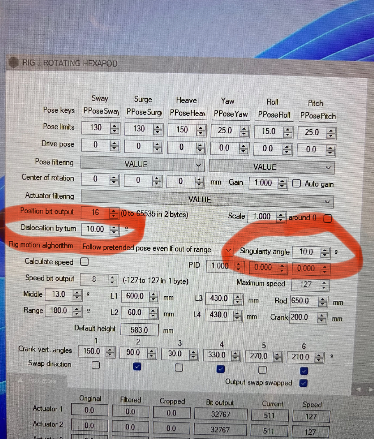

    Can’t properly lift my rig with following settings. @pmvcda Any Ideas?

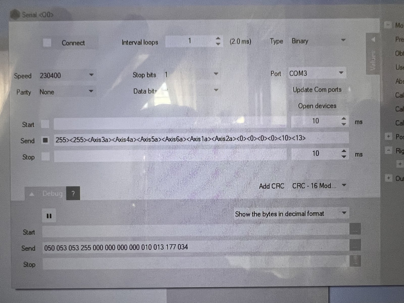

    Tried to change to the old string order (341256) but it gives me same results as in gif image I posted above.
    Edit:
    I edited manually the config with 250000 with even worse results

    You are with motion4sim right?
    Right now i have my bldc rig and a odrive one to test.
    I have the motors to test the boards (Thanos and Motion4Sim) and it looked ok some time ago. Seems i have to check again...
    Edit: the output values are strange... But you have the output disconnected

    Wait!
    I looked again at the string.
    Because of vars, it's no more axis1a format
    In list at the right, go to the rig, actuators and drag the value with B (bit value)

    I am on the old Thanos AMC1280 board

    @PeterW , you now have the T variable for turns in the actuators

    Indeed, it’s more coherent now

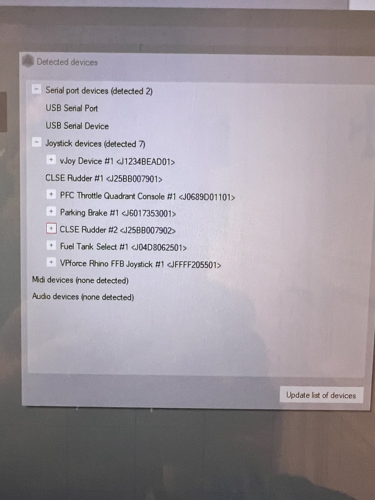

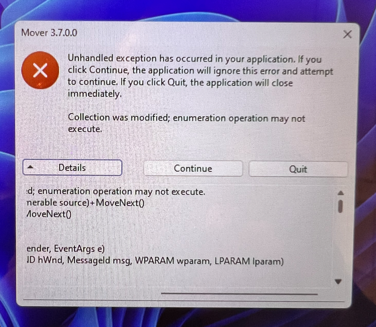

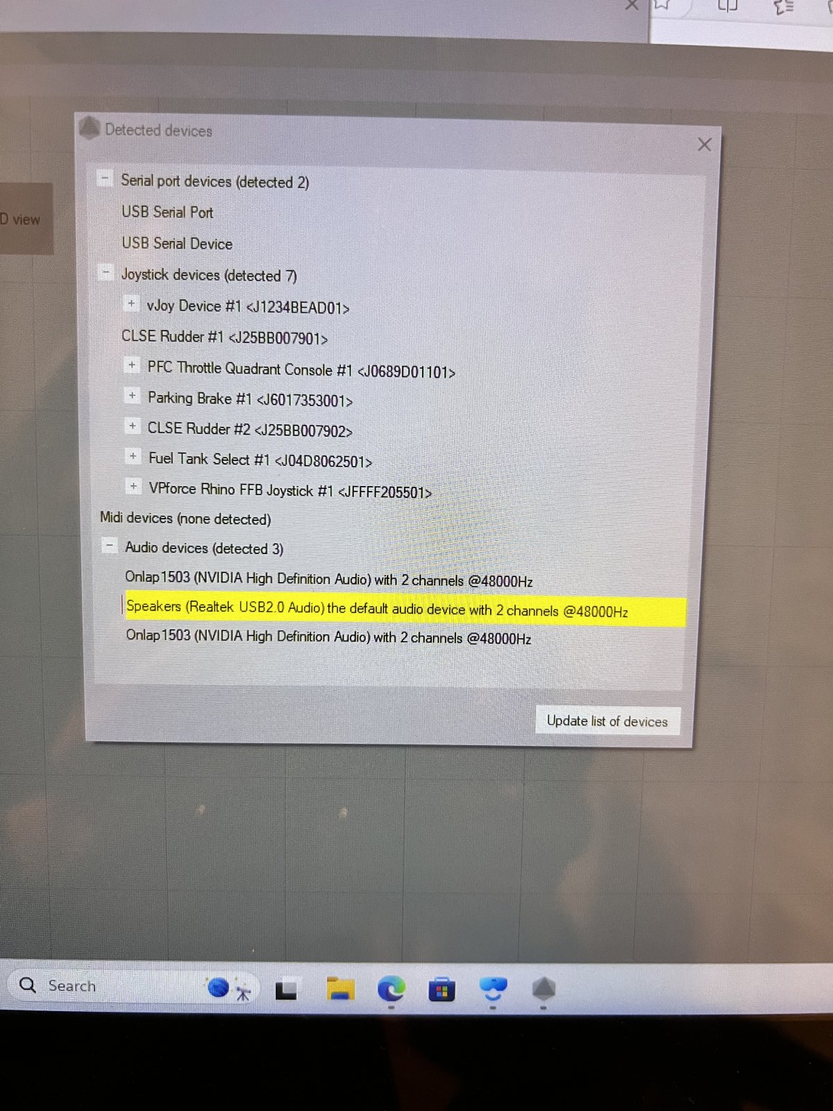

    I have trouble to connect to DCS. No pb with 3.6Beta
  14. hexpod
    hexpod http://heXpod.xyz
    Apr 18, 2016
    1,207
    berlin
    7,770Coins
    +375 / 5 / -0
    DC motor, 6DOF
    System.InvalidOperationException: Collection was modified; enumeration operation may not execute.
    at System.Linq.Enumerable.OfTypeIterator[TResult](IEnumerable source)+MoveNext()
    at System.Linq.Enumerable.WhereEnumerableIterator`1.MoveNext()
    at Mover.Devices.Utils.UpdateDevicesListsInUI()
    at Mover.Devices.Joysticks.Update()
    at Mover.Devices.Joysticks.UpdateTimerElapsed(Object sender, EventArgs e)
    at System.Windows.Forms.NativeWindow.Callback(HWND hWnd, MessageId msg, WPARAM wparam, LPARAM lparam)

    Did you add or removed a joystick?
  16. hexpod
    Apr 18, 2016
    1,207
    berlin
    7,770Coins
    +375 / 5 / -0
    DC motor, 6DOF
    Some glitch in audio devices (Realtek blabla) for some unknown reasons. I clicked “update devices” and it seems fine now.

    Could we have back the singularity limiters especially the leg angle with the platform position?
    It was a very useful security feature I think.
    Also could you briefly explain please the new “pre-follow” feature?
    Thank you so much for your efforts!

    Before clicking update”:
    after clicking update”:
    Sound device no detected ??

    The pre follow is the width of the actuator's slowdown curve as it approaches the limit.
