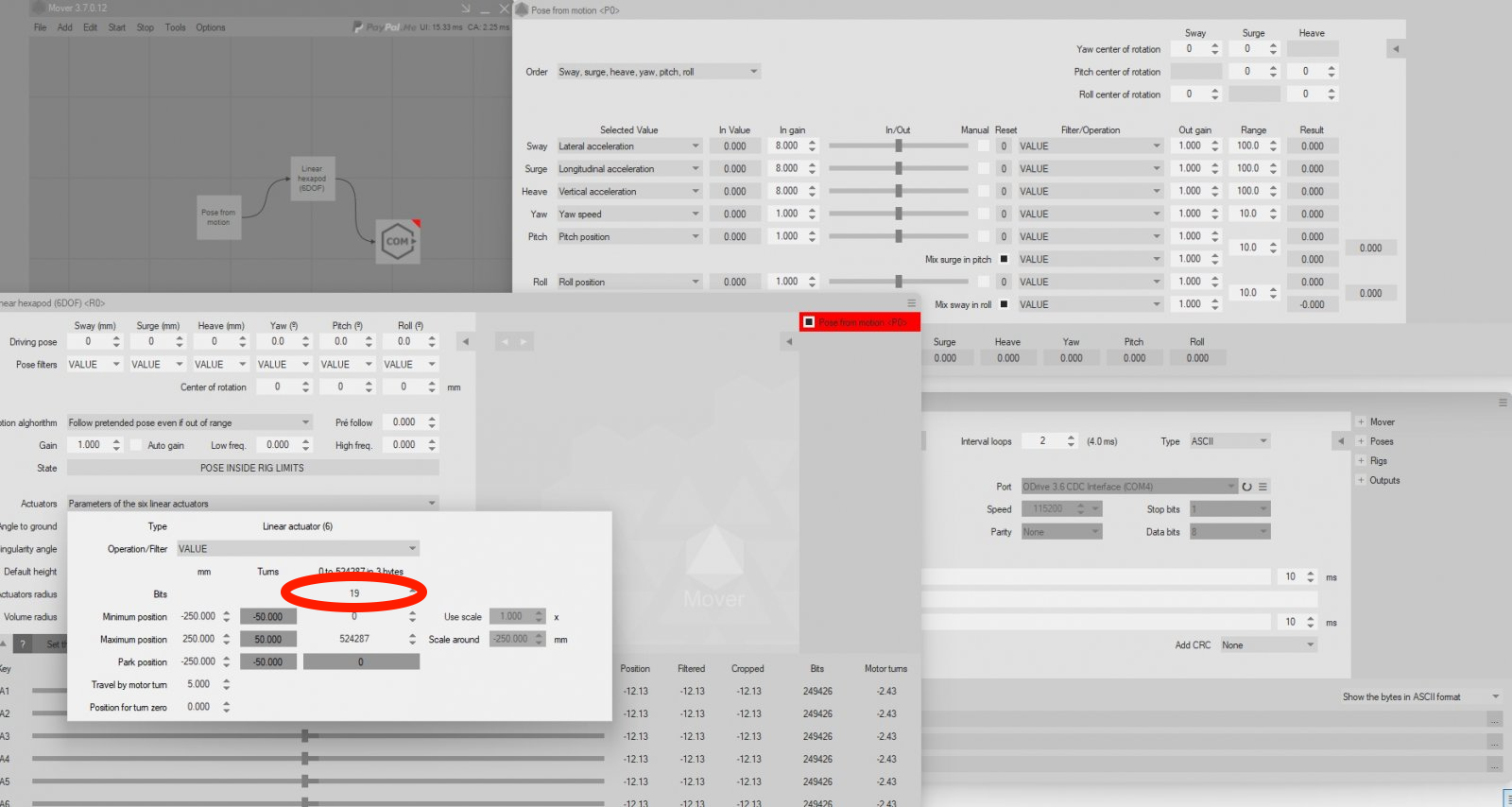

    Are you using 19 bits?
    Edit: Are you using WYBOsimu as a controller?
  2. dzq_stone
    dzq_stone New Member
    Jan 22, 2020
    12
    3Coins
    In fact i only want to move longer, due to the resolution of AMT102 is 8192 pulses per revolution, so if the output range is 19 bits the pulse will be 524,288, it will twist the ball screw 64 times, but current situation is still move tiny. so i think maybe the other parameter i didn't set correct.

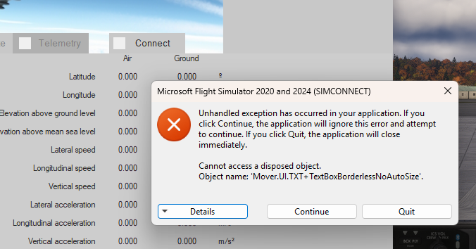

    Another error. When disconnecting from MSFS2024, an error message appears.

  6. hexpod
    hexpod http://heXpod.xyz
    Apr 18, 2016
    1,218
    berlin
    7,840Coins
    +376 / 5 / -0
    DC motor, 6DOF
    Same here.

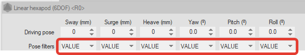

    What are these filters for? I assumed that the pose data would be filtered before being sent to the actuators. This doesn't work in version 3.7.0.14.
    I'm setting up a logistics filter, but the platform's movements are outside the set limits.
    Am I missing something, or is this a bug?

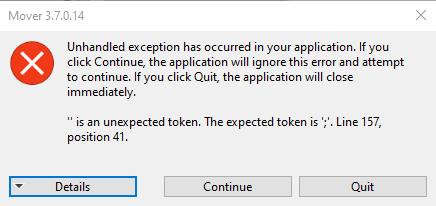

    Selected the item.
    Received an error.

    The logistic function doesn't work in this formula: LOGISTIC(EMALP(EMALP(EMAHP(VALUE;2000);72);1200);160;1) . Am I doing something wrong?
  12. PavelF
    PavelF New Member
    Sep 9, 2025
    29
    187Coins
    +12 / 0 / -0
    I tried replacing it with LOGISTIC3. It doesn't work either.

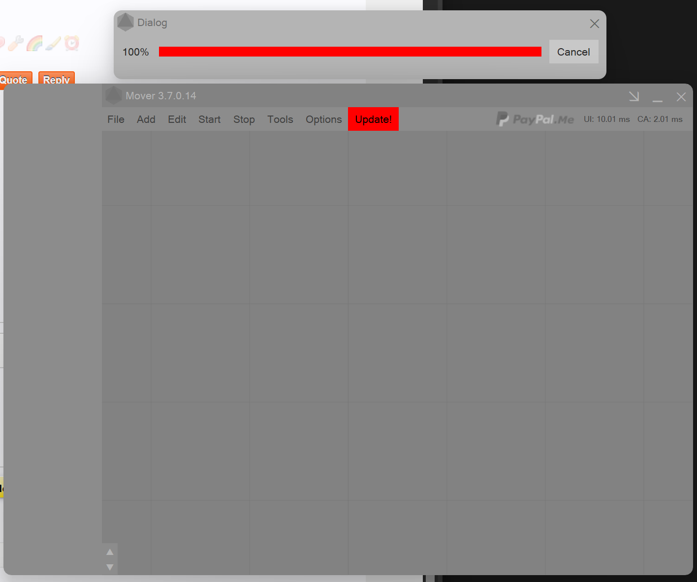

    Just for information updating to 3.7.0.15 freezes at 100%

    You can for example limit the motion of the rig in those filters. It's the main reason for their existence.
    You can also use for crash filters.
    But until 3.7.0.15 there was a bug where the filters where not working.

  16. pmvcda
    pmvcda aka FlyPT
    Nov 3, 2010
    2,237
    Portugal
    15,702Coins
    +2,674 / 17 / -0

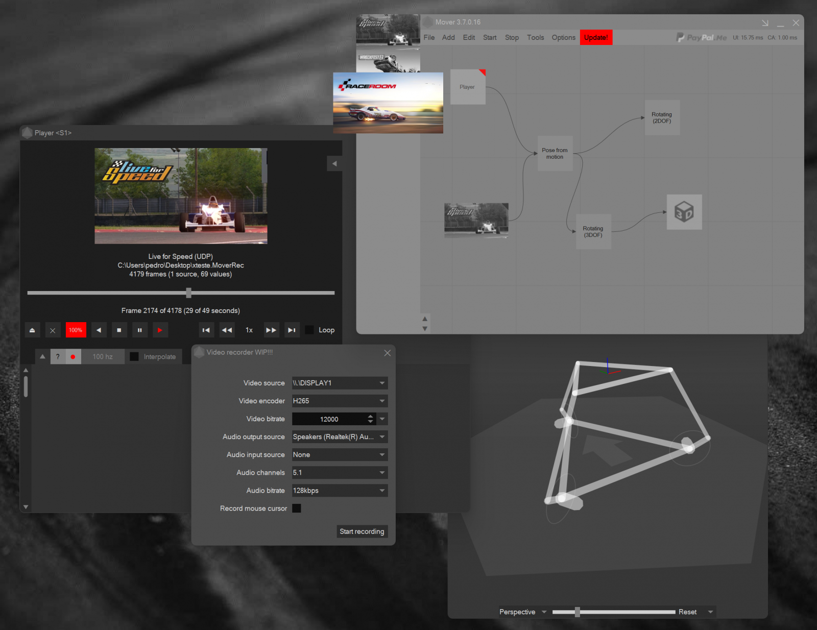

    Mover 3.7.0.15 Beta
    Release notes:
    Work in MIDI controls (not working yet...)
    Added new tool: Video recorder, for future integration with source recording
    Updated Racerrom telemetry
    Solved many bugs, worst in the rig module where the filters where tnot working
    Updates in UI controls, scale and colors (still WIP)
    Updated 2DOF rigs user interface
    Many other small updates
    Flight Simulator DLL's now embedded in the EXE, so mow Mover is only a single exe file
    Download here: https://github.com/FlyPTMover/Releases/raw/refs/heads/main/Mover 3.7.0.15 BETA.zip
    Already working on the next one...

    Could it be that the latest ZIP file (3.7.0.15) is only 2 bytes long? I don't think I've done something wrong with github because version 3.7.0.14 works.
  18. pmvcda
    pmvcda aka FlyPT
    Nov 3, 2010
    2,237
    Portugal
    15,702Coins
    +2,674 / 17 / -0
    @Aerosmith and @S2. ,
    Updated the file in github. It should work now.
    Sorry, I renamed the original file in github and it seems that might be the cause of the problem
