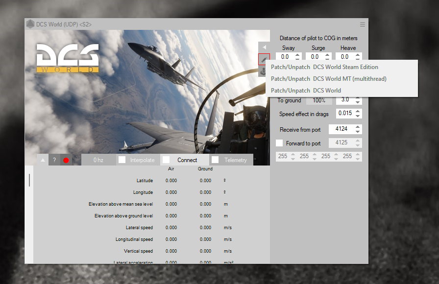

  7. danlo2721
    danlo2721 New Member
    Nov 20, 2024
    22Coins
    I am successfully using v3.5.3 in DCS to control my transducers using the supplied “DCS to FlyPT Mover.lua” script in the DCS/..Hooks folder. Now trying to do the same in V3.7.0.6 but it does not receive game data at all. There is no DCS lua script in the download with the new version and the old script only works in 3.5.3. Am I missing something? Thanks in advance.
  8. pmvcda
    pmvcda aka FlyPT
    Nov 3, 2010
    2,237
    Portugal
    15,702Coins
    +2,674 / 17 / -0

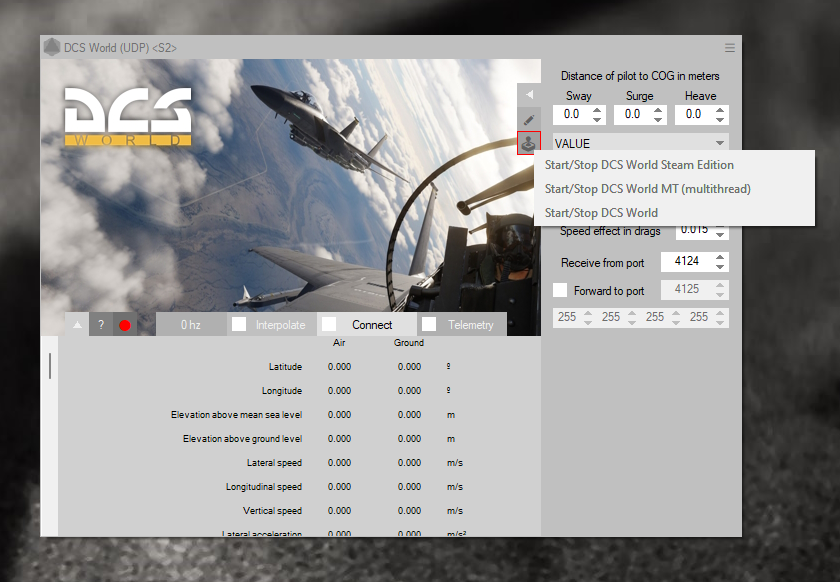

    It's using a new LUA file.
    In the new Mover, patching is automated.
    Go here (small button with pen) and apply the patch for the version you are running:
    You can also lauch DCS from here (small button with joystick):
    If you have problems, I can post the LUA
    Also there's many changes. Just ask for help if needed. User manual is still missing.
  9. danlo2721
    Nov 20, 2024
    22Coins
    Thanks!!
    Sorry, totally missed those two icons. Up and running now.
    Time to get re-acquainted with the filters and remap all my transducers.
    Looking forward to a manual and thanks again.

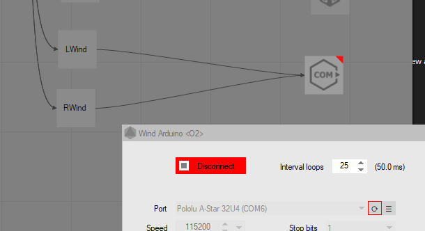

  13. PeterW
    PeterW alias Wickie
    Oct 21, 2018
    230
    Dipl. Ing. Mb (FH)
    1,766Coins
    +428 / 3 / -0
    Hi @pmvcda: Today I set in Mover 3.7.0.6 a default settings from my rig for startup (set as default for Mover at startup) but forgot that the com-ports have been wrong in this setting-file.
    Now when I start Mover it allways crashes to desktop (see video).
    The problem is, that I can not remove this default setting at startup - it seems to stick to the Mover no matter what I do.
    Any ideas?
    Thanks a lot!!!
  14. pmvcda
    pmvcda aka FlyPT
    Nov 3, 2010
    2,237
    Portugal
    15,702Coins
    +2,674 / 17 / -0
    Ok, i can add a command line to start with all outputs disconnected. Kind of safe mode.
    Give me some time, i will post the build in the next hours.
    Or if you want to, go to the registry, search for Mover and delete the default setup. You will loose the setup...
    You can store it by copying the text to notepad and save it

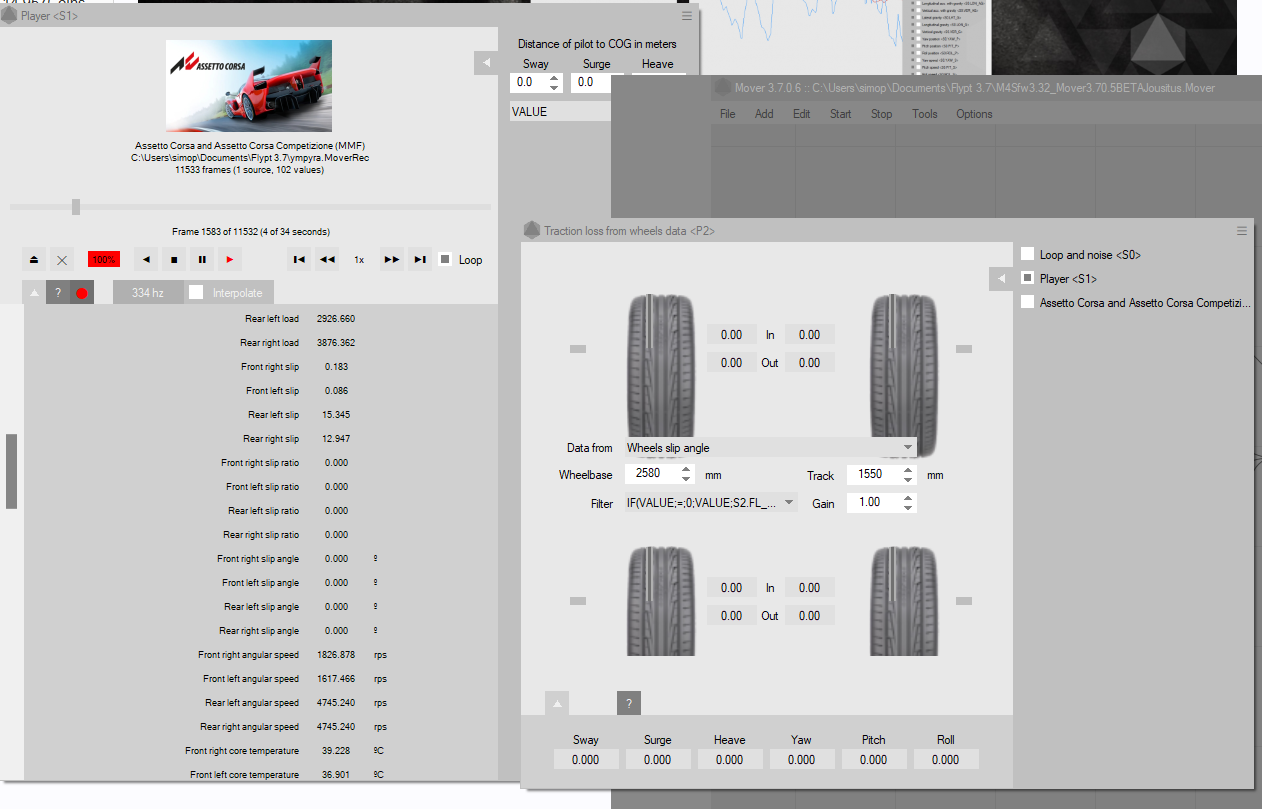

  16. S2.
    S2. New Member
    Nov 20, 2019
    12
    Finland
    86Coins
    Trcaction loss from wheels don't work with Assetto Corsa.
    Is it that Assetto don't send slip angle data?
  17. PeterW
    PeterW alias Wickie
    Oct 21, 2018
    230
    Dipl. Ing. Mb (FH)
    1,766Coins
    +428 / 3 / -0
    Thanks for your fast Support!
    Mover crashes also with this procedure.
    But deleting the default setup file in the registry did work
  18. PeterW
    PeterW alias Wickie
    Oct 21, 2018
    230
    Dipl. Ing. Mb (FH)
    1,766Coins
    +428 / 3 / -0
    This was the solution! Thanks a lot for your great support!
  19. pmvcda
    pmvcda aka FlyPT
    Nov 3, 2010
    2,237
    Portugal
    15,702Coins
    +2,674 / 17 / -0
    Have to check. I think not, only acc.
    Those tires are huge.... Need to check that also
