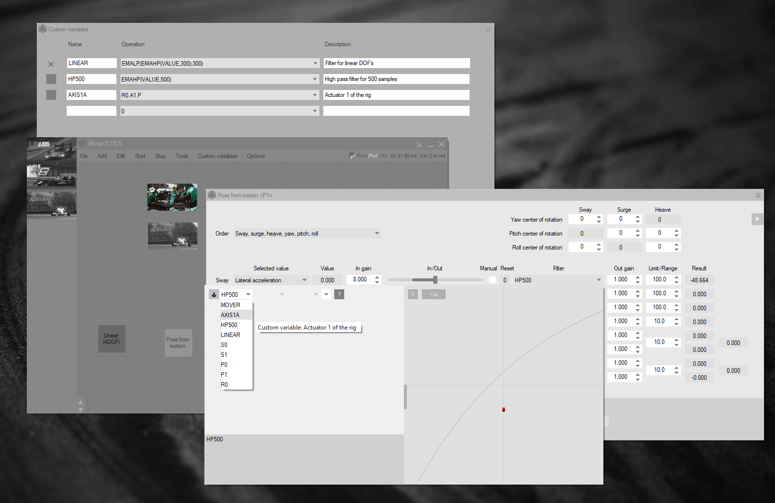

    It was not on my to do soon, but decided to add this for the next release:
    It's custom vars, where you set a key for a filter/operation and use it anywhere in Mover.
    It was mostly done. Missing save/load (now done) and test for declaration repeating (WIP).
    This is a good solution to simplify some filters. I can add some defaults...

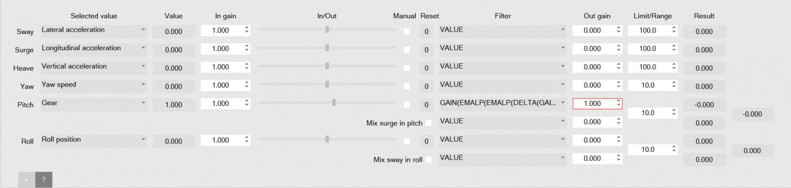

    So if you have a 6DOF Stewart Platform AND a game that actually provides right telemetry data for linear accelerations you would have that gear change effect, no problem.
    The issue you're having is that you have a 2DOF system which I assume is pitch and roll. Generally cars don't pitch/roll during a gear shift, they surge (linear deceleration and acceleration on the longitudal axis). Since you have no movement on your rig that would directly map to these forces you can mimic them, and many people do apply pitch for persistent surge forces but not for instant/high frequency forces, one that a gear shift would be.
    You can make a new pose just for gear shift that looks like this:
    Set the Selected Value to Gear and set the Filter to: GAIN(EMALP(EMALP(DELTA(GAIN(VALUE;10));20);20);10)
    You can change the values of 10 to higher or lower to make the effect stronger/weaker and you can adjust the values of 20 (filters) to make the movement smoother or more abrupt.
    This will pitch the seat one way for upshifts and the other way for downshift. You might have to do a gain of -10 instead of 10 to invert the direction. If you want the directin of the seat movement to be the same for both up and downshifts you can just use ABS(VALUE) instead of VALUE.
    I don't know what the range for your pitch is, so the gain values are likely wrong and you need to tune them to get it just right for your rig. Also, I assumed that your 2DOF were pitch and roll and you'd want pitch for gear shifts. You can use the same filter on other movements like heave if that is where you want to feel it and you have heave control.

    Yes, you're correct about pitch and surge and very good in the explanation, thanks mate. I understand that after adding a new pose with gear value in the pitch, I'll need to combine them in the rig. I will try your suggested tomorrow, it seems promising. Indeed, I did try to use -ve gain previously but on the surge, and using IF(DIF(Value)) filter with negative gain, but, i dont fully understand their usage yet. So I will definitely try your suggestions.
    Actually as for now using 2dof rotating rig, I can see in the viewer some upward movement while changing gear up, which is already correct, but I dont know which data it is reading and where can i adjust the gain for it.

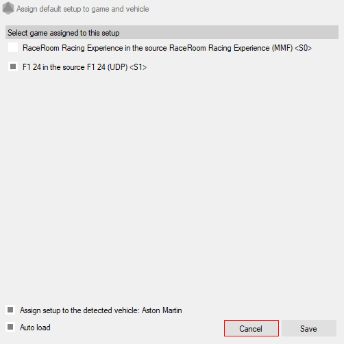

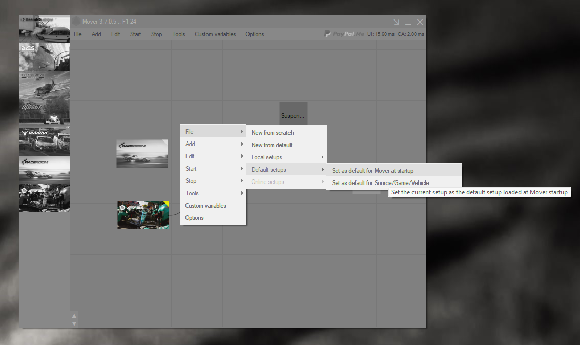

    Yes,

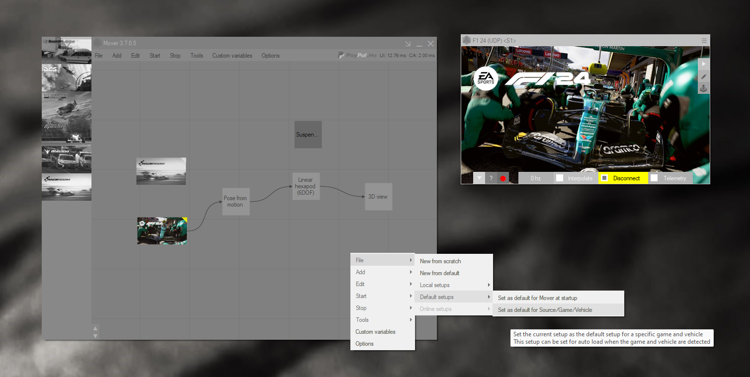

    Go to File -> Default setups -> Set as default for Source/Game/Vehicle
    You get this window:
    Depending on what you have on the setup and on the game, you can make selections:
    • If you have more than one source in the setup, for wich source/game (some sources support more than one game)
    • Vehicle assigned to the setup. If the source can't identify the vehicle the value is none and the setup is general for that game
    • Auto load that allows the setup to be auto loaded when the game/vehicle is detected (BUG here in current release)

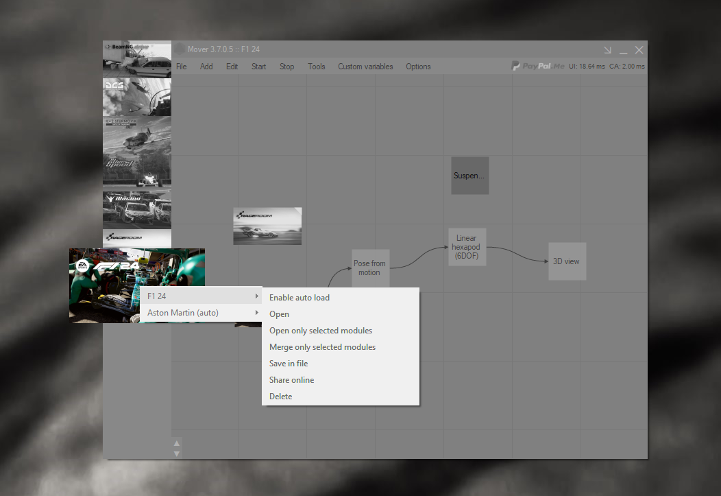

    When you save this, in the main window you get this default setup :
    There, you can open it, delete, change auto load option....
    You can see for F1 24, two default setups, one for the Aston Martin and the first without auto load (no auto showing) as a generic setup.
    You can't have multiple setups for the same car or multiple generic setups for the same game.
    NOTE: Auto load is buggy on current release, I think it will be OK for the next one.

    There's also a default Mover setup here:
    This is the setup loaded when you start Mover.
    You should include here your rig definitions and outputs. Usually they are the same for all setups.
    Using this allows you to start Mover with that base already defined for new setups.
    The default setups are stored on the registry.

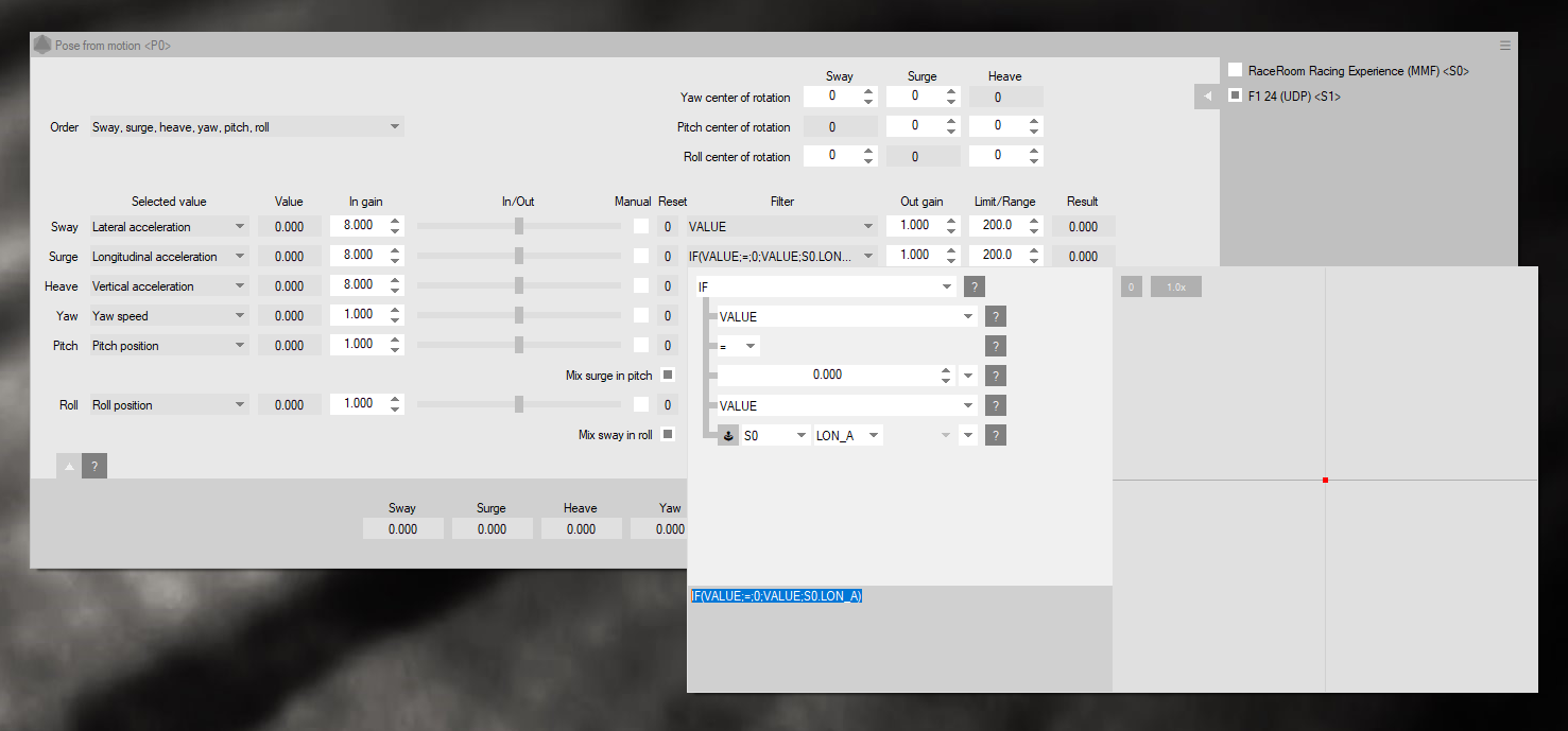

    This is already there.

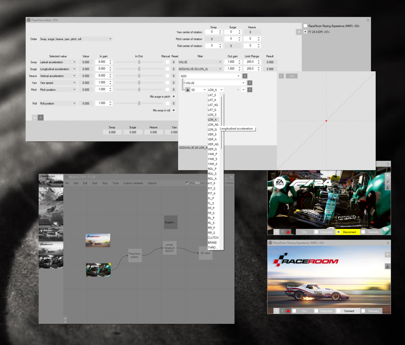

    You can access vars from any module.
    Here, I have two sources. In the pose I selected F1 24, but in the filter I access the var from the RR source.
    You can write the var like S0.LON_A (source 0, longitudinal acceleration) or select VARIABLE on the filter dropdown
    You can use with an IF:

    Wow, i've tried this and u know what, I can already get the feel of changing gear. However, something i dont understand, i did use a negative gain on one gain, but there are two gain inside that filter. Not sure enough which one should I've change, so I only tested on one of them. I think it's the most outest gain that I'd applied to.
    Thanks for helping out.
    I dont have much filter used on the main pose actually, just a simple emalp with low value to smooth it out. As I understand previously, im using emalp if i want the effect to be lean/smooth curve, and emahp for high or sharp effect. Am I undestood it right?
    Again, thanks for helping me out.
