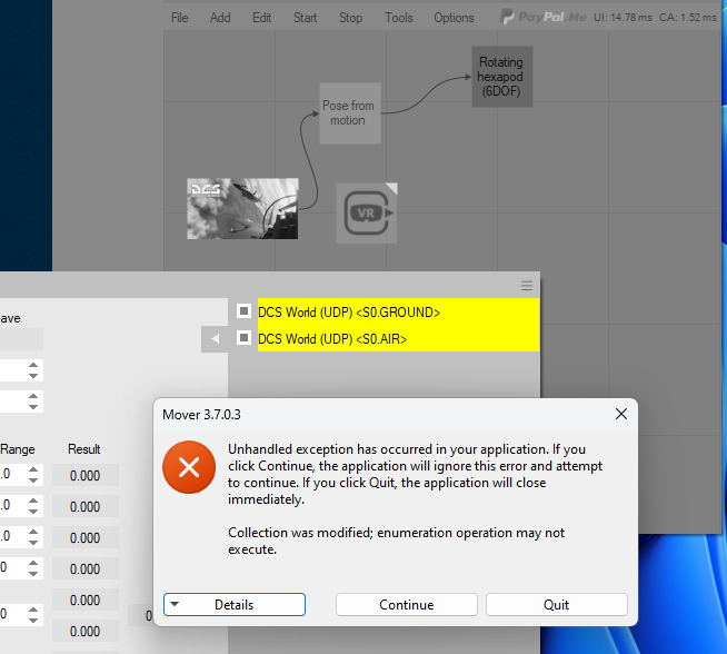

    DC motor, 6DOF
    this message appears when dcs source is connected topose from motion. should be easy to reproduce Screenshot 2024-10-07 211723.png

    actually whatever the source is added this error appears in this constellation

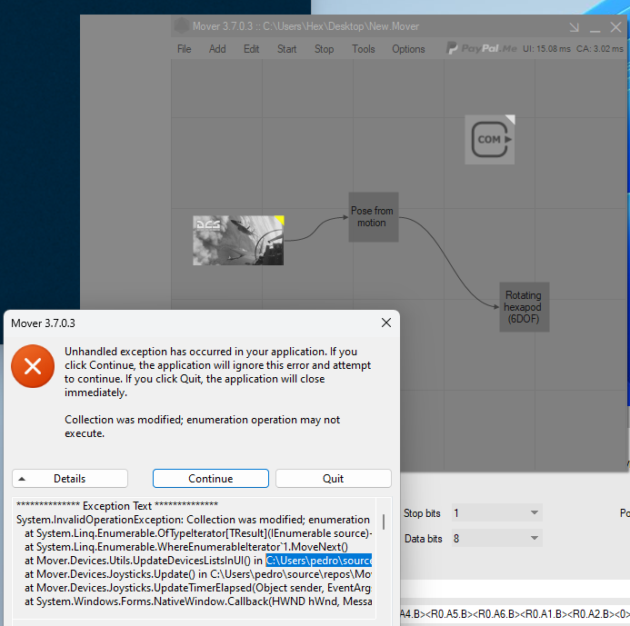

    7,770Coins
    +375 / 5 / -0
    DC motor, 6DOF
    now its appears when I add the output. Its normal we have the path C/users/pedro in the error window?

    Let me solve the main bugs first

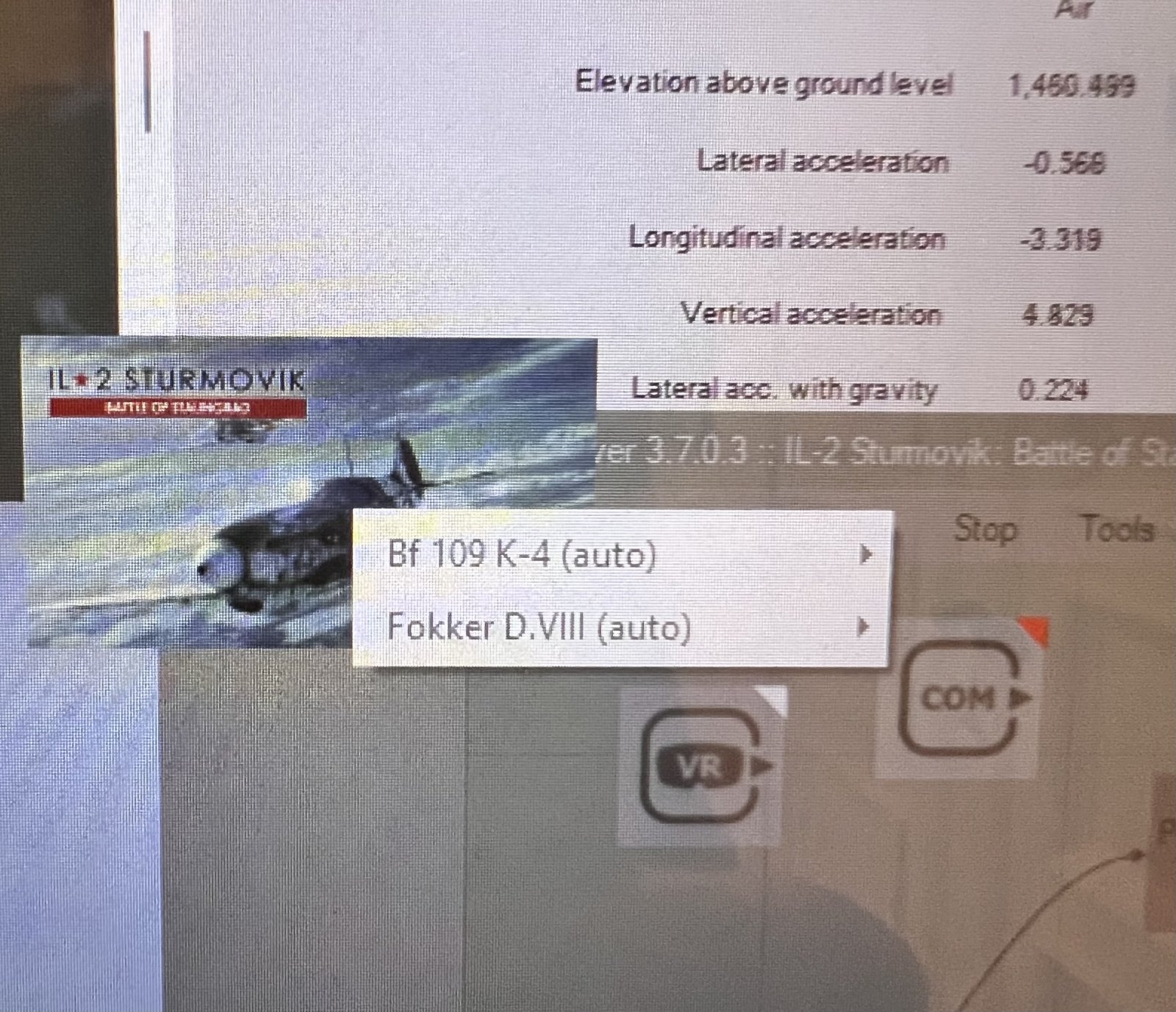

    @pmvcda Ok, I think I understood you. So first you don’t set the park position and you calibrate the lever-arms to horizontal position, than you set the parking position (which is not working properly yet). So in theory we don’t need an extra offset to be displayed to the user.
    In the meanwhile I was able to save some vehicle presets (I think we don’t need a video for this as it’s pretty intuitive) which is an absolute game changer. Thank you for this feature!
    Edit:
    Function „auto load” doesn’t seem to work (switch automatically) while changing the vehicle in IL2 but it’s already a tremendous step in the right direction

    Sorry, been a complicated day...
    Yes the auto load has some problems. Made some changes to make it lighter, but caused damage... Need to look at it again.
    This can become a bit confusing with the auto load and asking to save setups....
