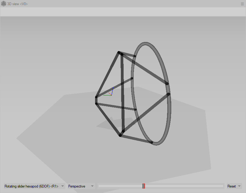

    Mover 3.7.0.3
    Download link on the first post of this thread.
    Changes:
    Some more work on scale problems
    Solved severe bug on rotations (now rigs can be rotated correctlly, same for actuators)
    Example of a rotating slider hexapod mounted on the wall allowing full roll, could be interesting for inverted flight...
    Added pose from RPM
    Solved bug on rig motion alghorithm: Stay on last good pose with transition (see video on one of my last posts)

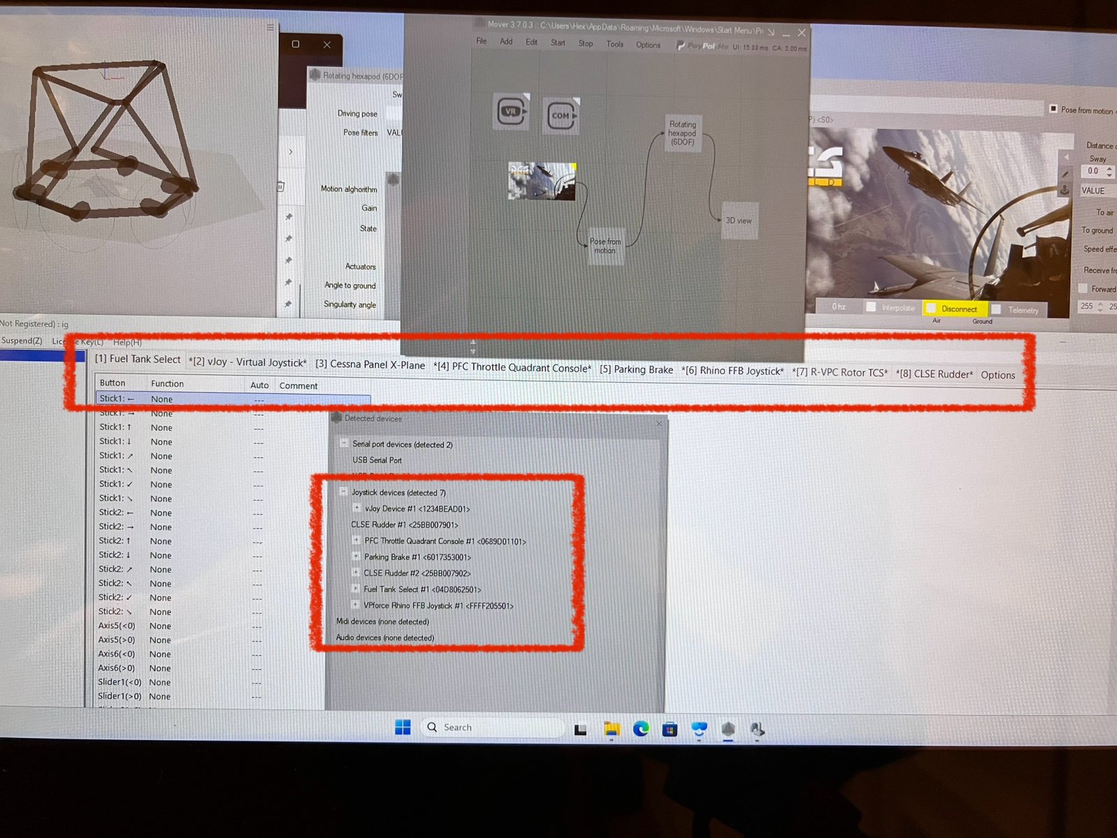

    Still have some of usb devices (buttons) being not recognized for some strange reason.
    VPC - Rotor tcs or Cessna panel

    In the old Mover did they show? With all the controls?
  20. hexpod
    hexpod http://heXpod.xyz
    Apr 18, 2016
    1,207
    berlin
    7,770Coins
    +375 / 5 / -0
    DC motor, 6DOF
    No, they were as well NOT recognized in 3.6 Beta
