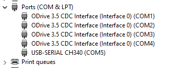

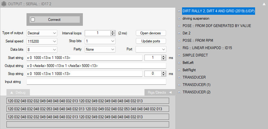

    I honestly don't know when I connect the values change as they should like it is going to middle position and when I move sliders all values change but the actuators just move a tiny little bit

    Another bug I think, Mover not detecting my MotoMonster for my wind

    @SilentChill , is the s3.5.3 working well with the rig and this string?
    Also is the start and stop needed? Could be there the error
    put there 1s at least on the new one

    Should work, try to update the list of com ports

    Yeah old Mover still works perfect.
    I have taken the start and stop strings out and they make no difference

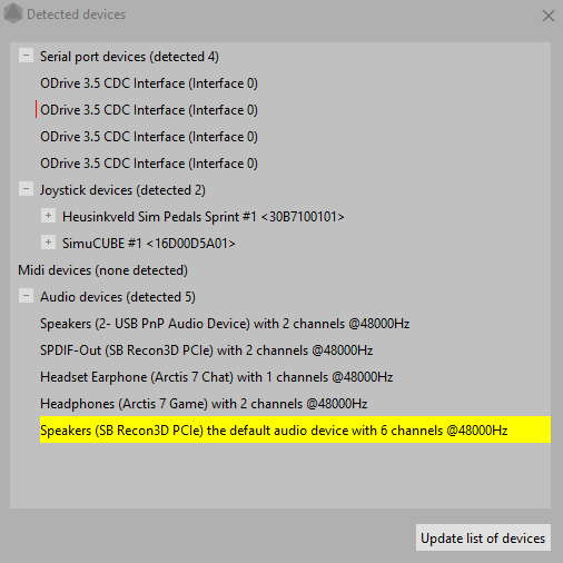

  8. SilentChill
    2,645
    20,601Coins
    +3,570 / 34 / -0
    COM 5 isn't detected tried loads of times it just doesn't see it.
    Again old Mover everything still connects and works

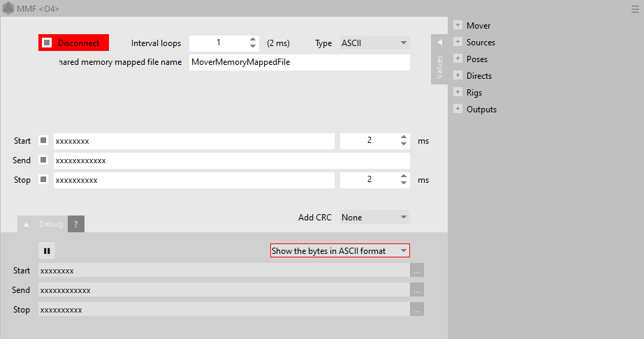

    15,702Coins
    +2,674 / 17 / -0
    @SilentChill ,
    Ok... try this:
    You need to check the fields for them to work (Start Send Stop)

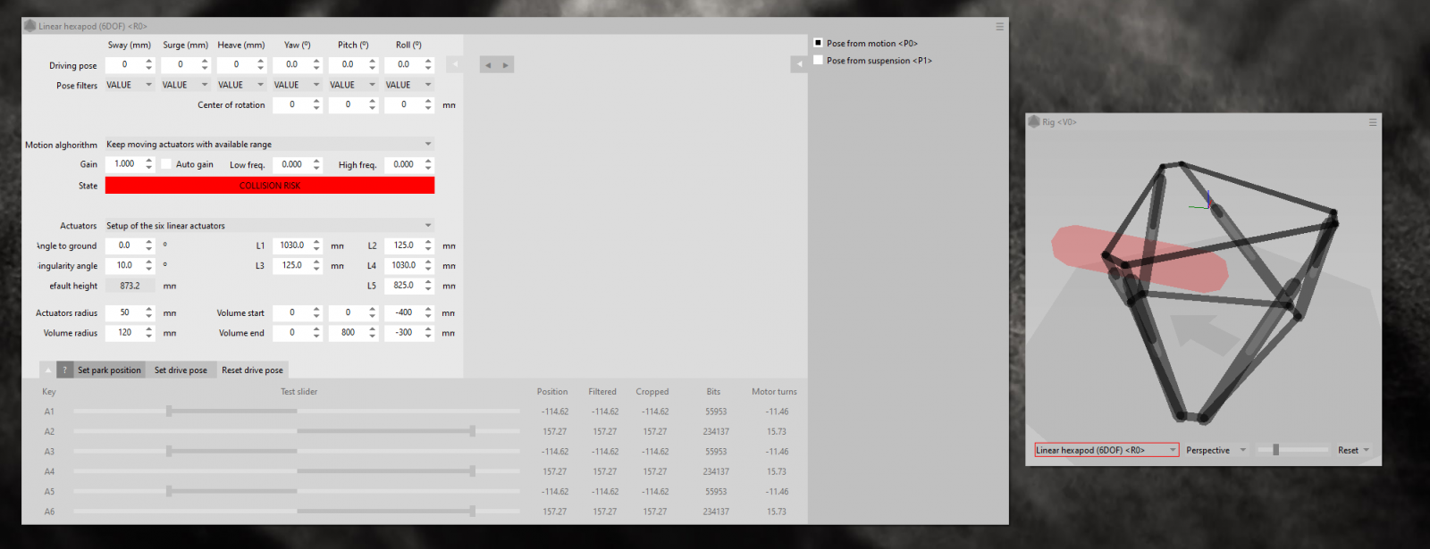

    +2,674 / 17 / -0

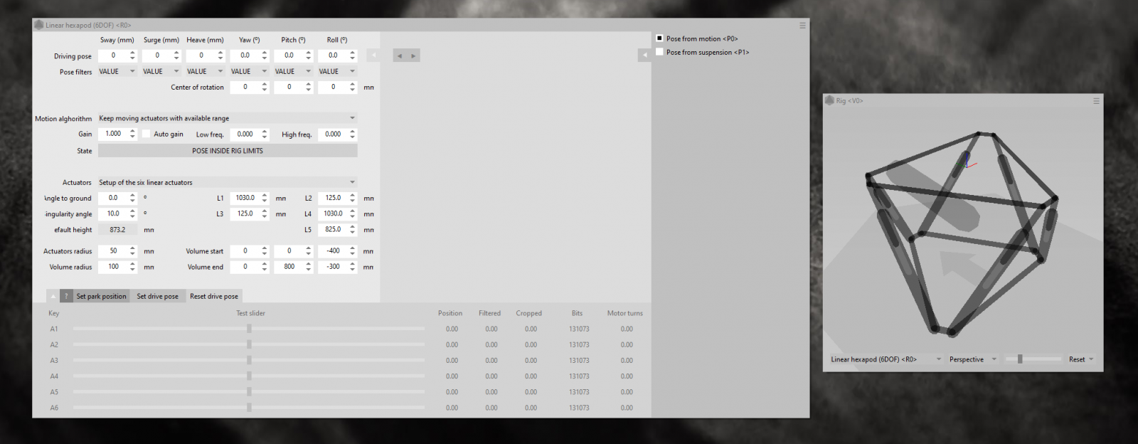

    NOTE:
    In the linear hexapod rig module there's new parameters:
    Instead of middle value of the actuator we have distance betwen joints with actuator at minimum travel
    This is because Mover now uses the default position at perfect middle of heave, not middle of actuator travel
    Also I now test for colision of rig structure with actuators
    To enable it we need to set a diameter for the actuators
    Also a diameter for a volume associated with the top rig platform
    That volume is a cylinder with a center that as a starting point and an end point
    If the diameter of the volume is set, it shows on the 3d view
    On colision you see this:
    If the motion alghorithm: Follow pretended pose is enabled, this is prevented from happening
    To see it you need to select the keep moving actuators
    I made this because most of those rigs have the pedals there...

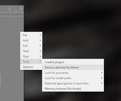

    @SilentChill ,
    Sorry, one more...
    Do this:
    And show me the window that is displayed. Try to update the devices there als..

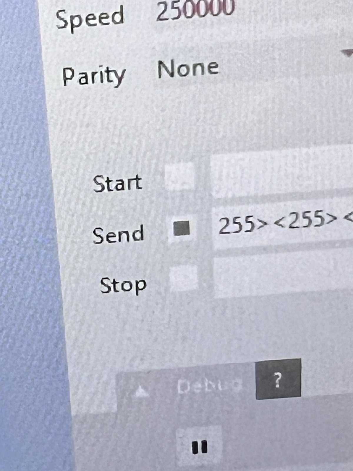

  13. SilentChill
    2,645
    20,601Coins
    +3,570 / 34 / -0

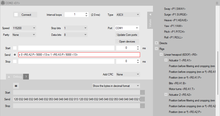

    hmmm I don't know if I understand but I copied that and it doesn't do anything at all ?

    +2,674 / 17 / -0
    I meant just the checkboxes... not the sttring, there use your string

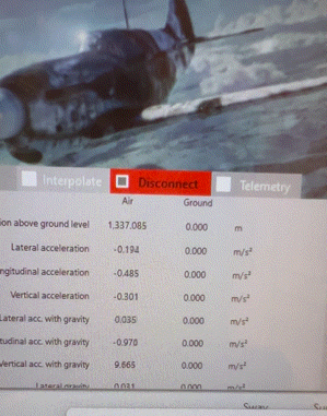

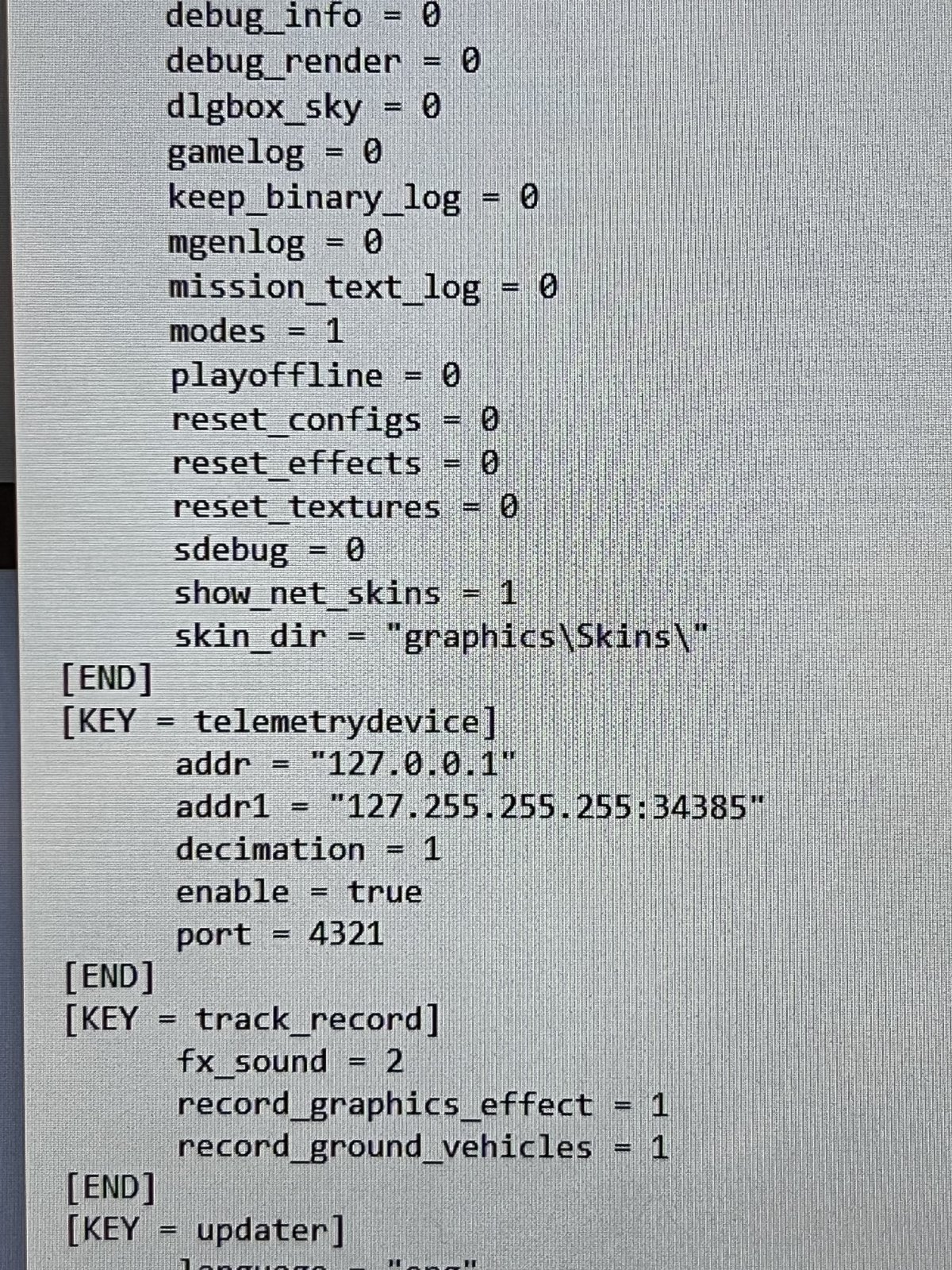

    DC motor, 6DOF
  16. hexpod
    hexpod http://heXpod.xyz
    Apr 18, 2016
    1,218
    berlin
    7,840Coins
    +376 / 5 / -0

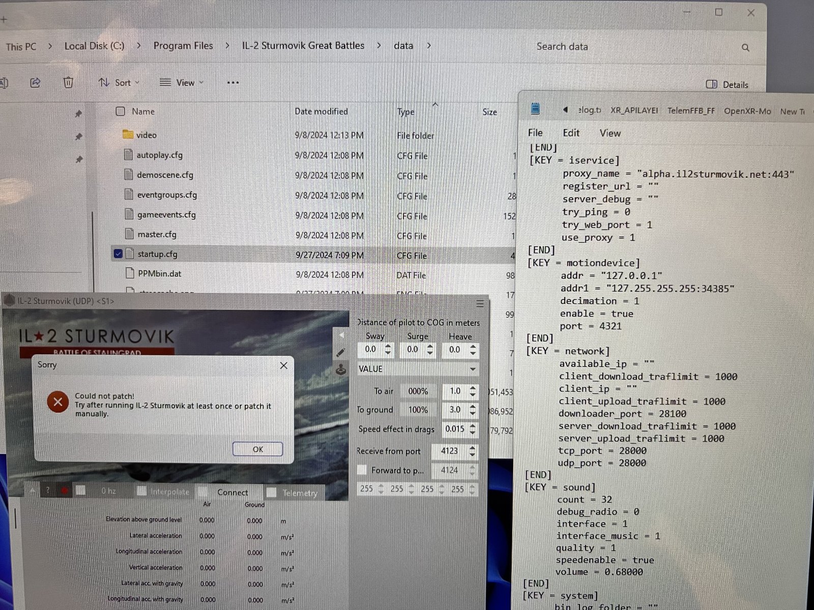

    DC motor, 6DOF
    FFB Joystick is picking up the telemetry as well.
    any reason why Mover 3.7 can’t get it?

    DC motor, 6DOF
    Ok got it 4321 4123…. Sort of dyslexia ;-))
    we have some strange cuts

    +3,570 / 34 / -0
    oh my string from the old mover ? i tried the new string that didnt work

    DC motor, 6DOF
    apparently you must activate the checkboxes
