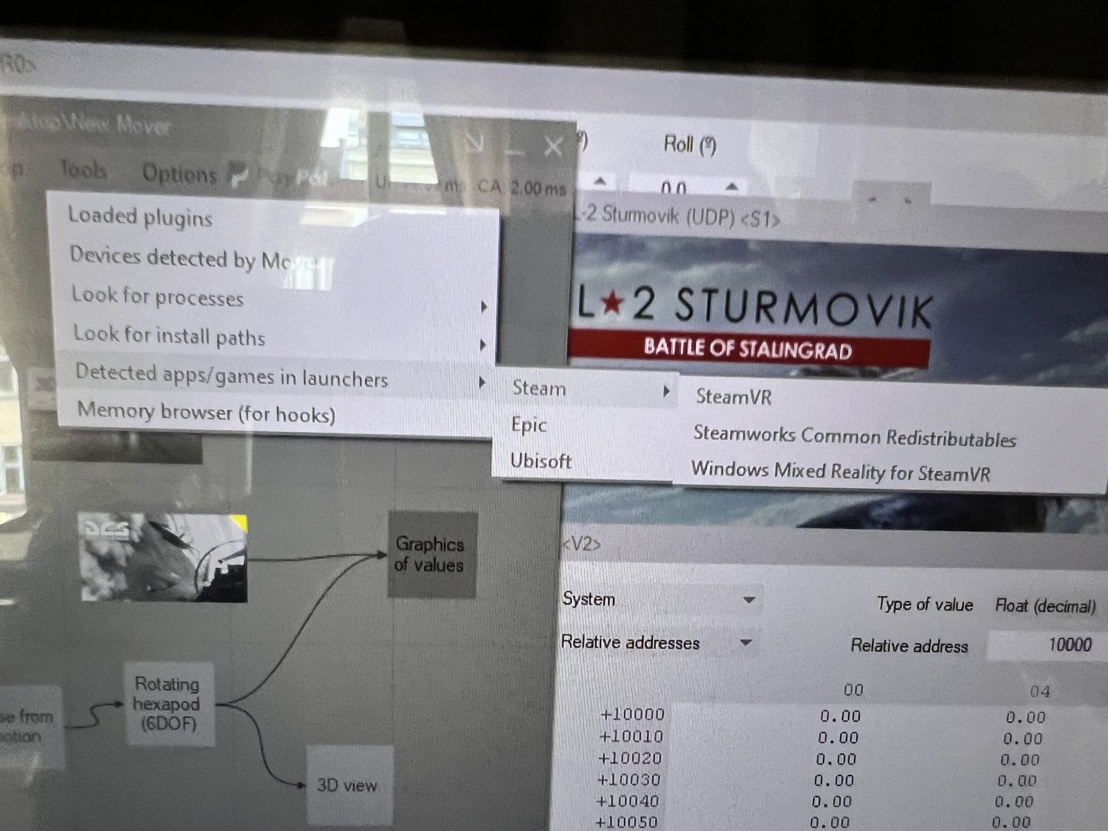

  12. hexpod
    hexpod http://heXpod.xyz
    Apr 18, 2016
    1,207
    berlin
    7,770Coins
    +375 / 5 / -0
    DC motor, 6DOF
    Not sure 100% but I think it’s a non-steam thing. You can see the path to the exe in the screenshot

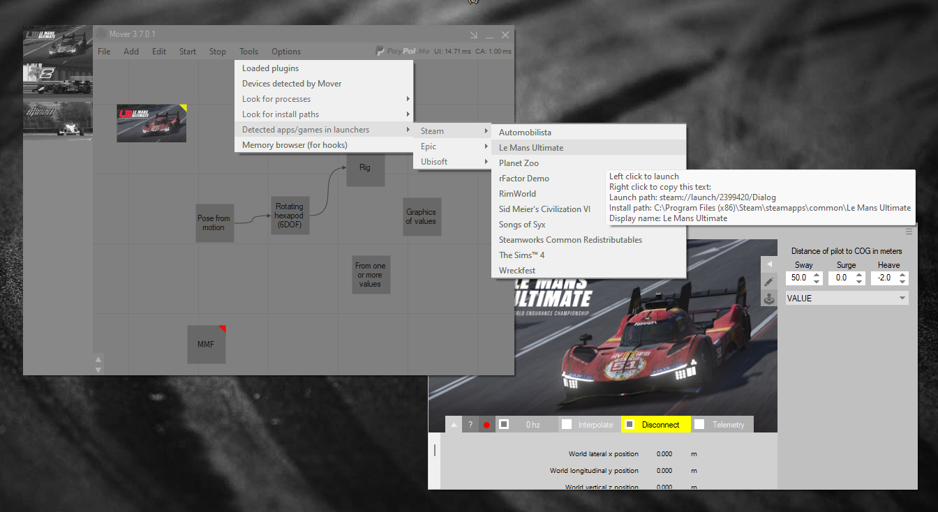

  13. pmvcda
    pmvcda aka FlyPT
    Nov 3, 2010
    2,210
    Portugal
    15,547Coins
    +2,649 / 17 / -0
    @hexpod ,
    Please, can you check this:
    In the menu, go to Tools:
    Select the above menu and see what shows in IL2
    If you right click, tehe tex shown can be pasted here.
    You can also try to lauch the game by clicking on it.
    I detect those 3 launchers. If it's not on the launchers it should be detected also... but something is wrong, not sure what.
    Since it's not detecting it, Mover doesn't know the instalation path...
    ... Yes the Sims4... Arghh, my daughter uses this laptop. I have 99% of the games in portable SSD's (rig->laptop->house)

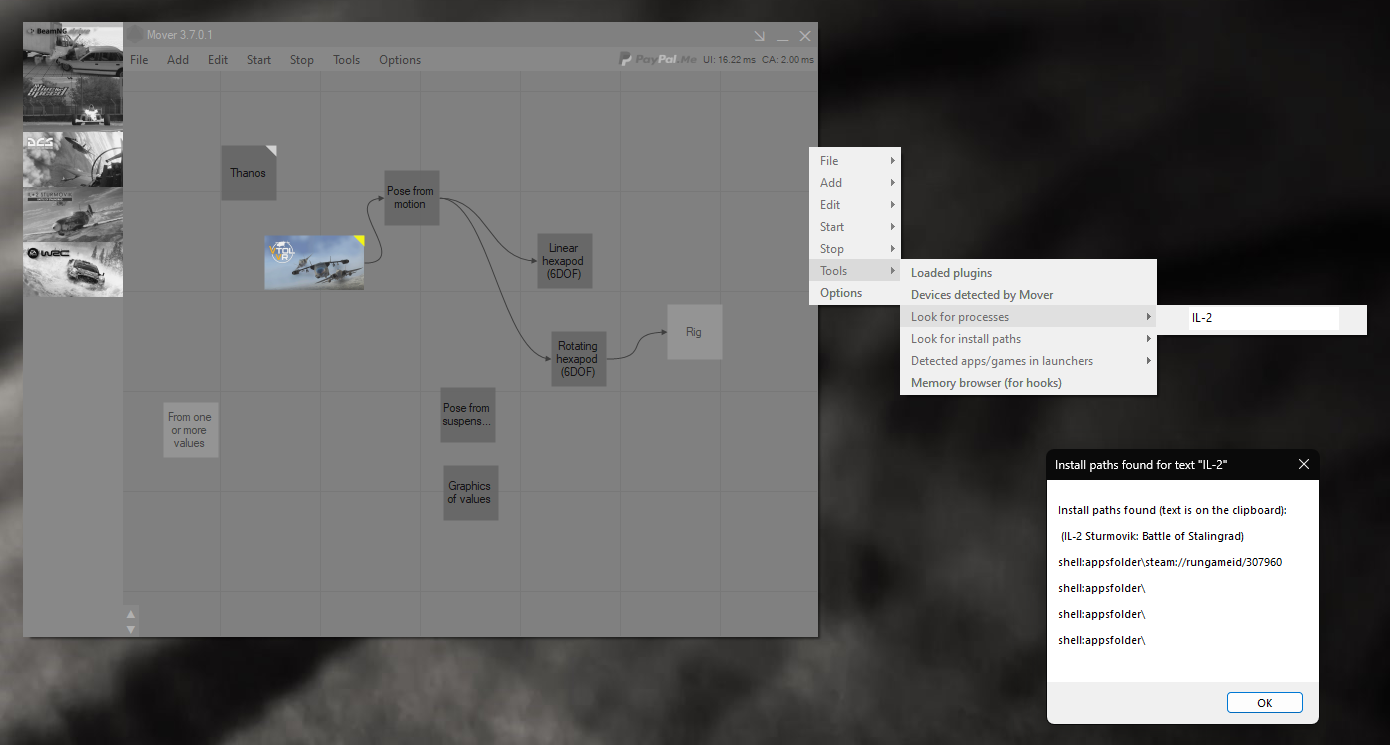

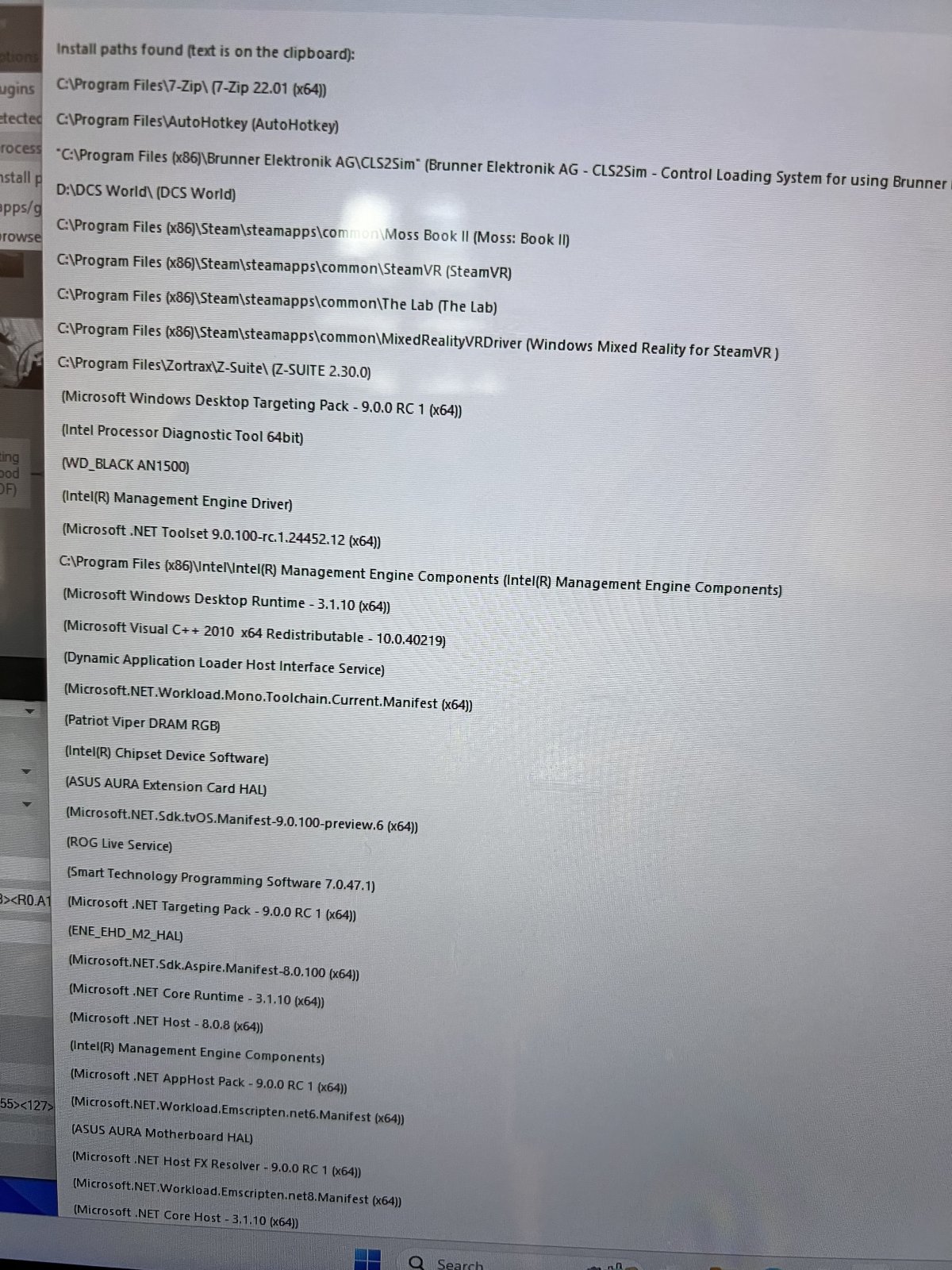

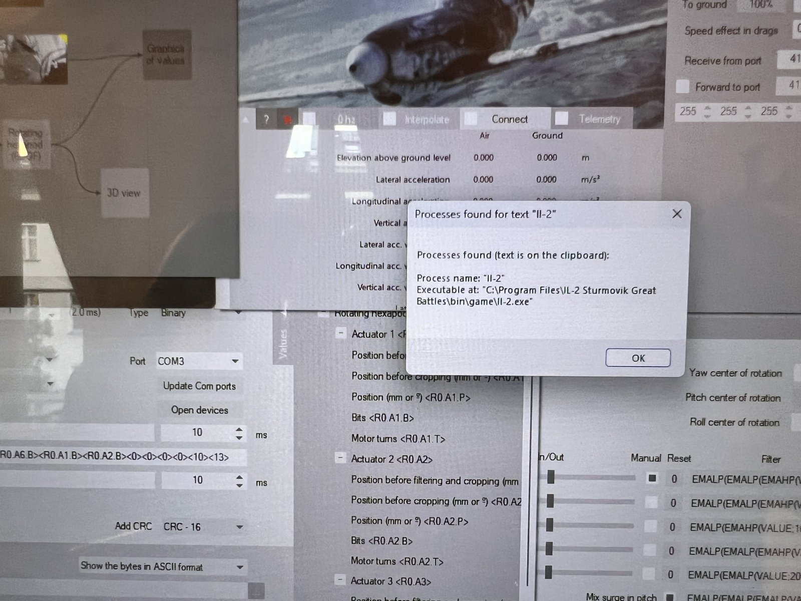

  17. pmvcda
    pmvcda aka FlyPT
    Nov 3, 2010
    2,210
    Portugal
    15,547Coins
    +2,649 / 17 / -0
    @hexpod
    Sorry for being so .....
    Can you do this:
    First window that pop's ignore, i want the second one (install path)
    You have to write IL-2 and press enter
  18. hexpod
    Apr 18, 2016
    1,207
    berlin
    7,770Coins
    +375 / 5 / -0
    DC motor, 6DOF
  19. hexpod
    Apr 18, 2016
    1,207
    berlin
    7,770Coins
    +375 / 5 / -0
    DC motor, 6DOF
    It’s not the Launcher which has a different name ?
  20. pmvcda
    pmvcda aka FlyPT
    Nov 3, 2010
    2,210
    Portugal
    15,547Coins
    +2,649 / 17 / -0
    ... Sorry, can you try with il-2 closed also.
