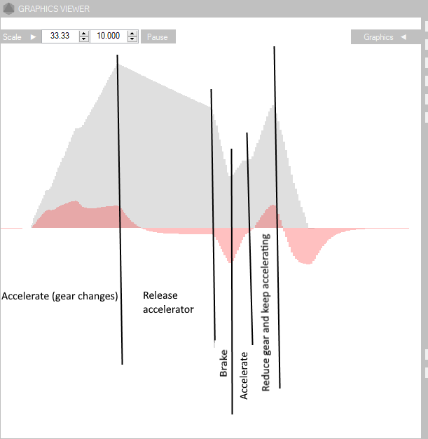

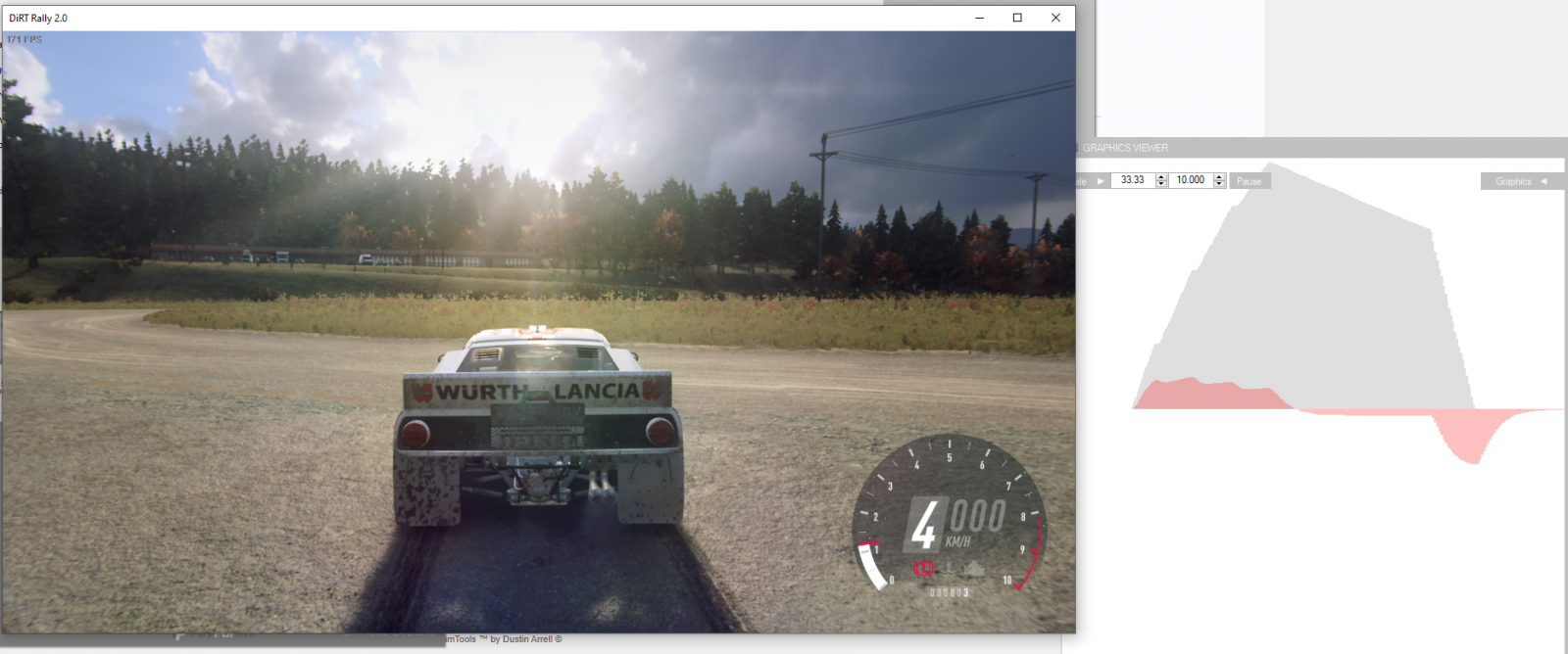

    1-2 gear 2-3 gear. Do you see what’s happening when the power is cut due to gear change?

    I think you have an interesting point there.
    First of all, I know that Cruden have actually implemented such a behavior with great success, so I assume there's some value in that concept.
    I think the reason why the pure HP filter based approach (kick back when force cut) feels wrong is this:
    The acceleration onset gave you a fwd jolt AND it slowly tilted your platform back. Now, when you suddenly cut the acceleration, the tilt is still there for a few moments. So that backwards surge should just "neutralise" the acceleration you are still feeling from the tilt.
    Problem 1) Tilt and surge have to be coordinated to feel realistic.
    Problem 2) With your screen setup you can still see the room to reference your movement to. The less you saw the room, the less that backwards jolt can even be perceived as backwards.
    I can say that I am aware of what you are describing (wrong kick when force cut), but I can also attest that it gets significantly better with...

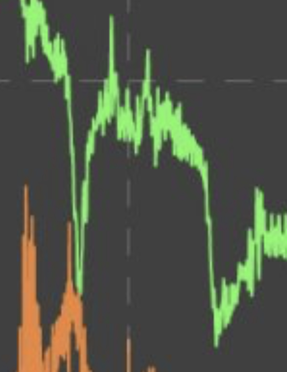

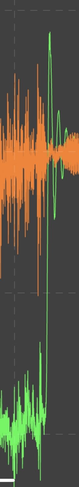

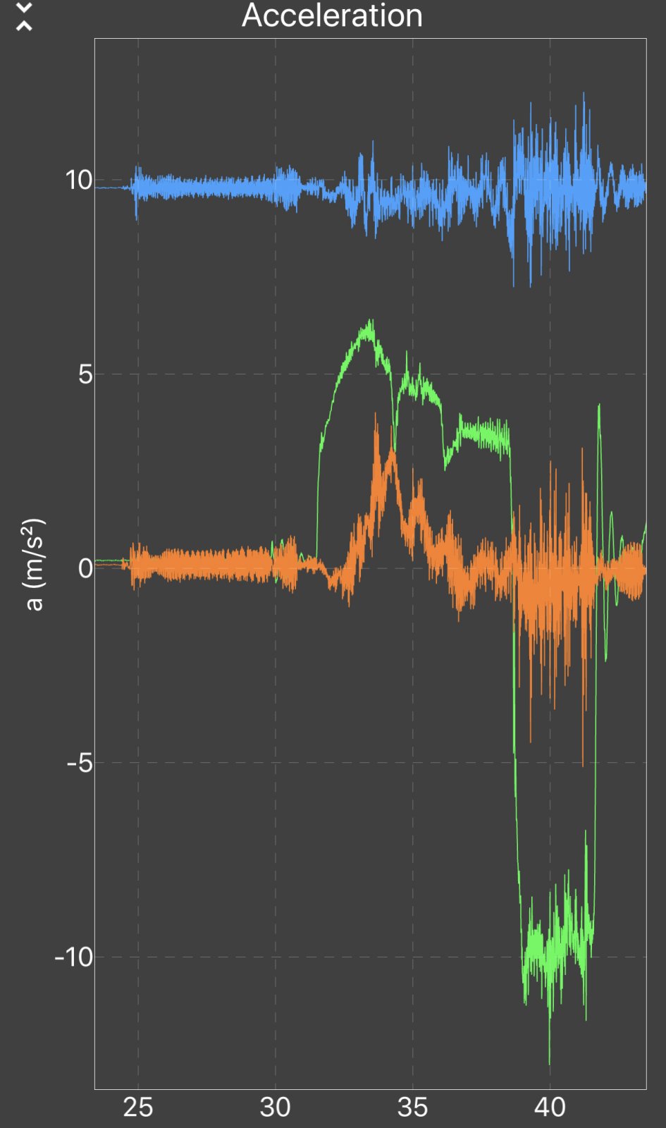

    And how about this ?
    You brake until the full stop. At the moment it stops, you get a huge spike over 0, and even some oscillations.
    So when you cut the force (in this case, the braking process stops) you get a back spike.

    I think that is the suspension bouncing back. Those are movements that would be contained in the acceleration signal anyways, because those are actual forward-backward accelerations.
    As far as I can tell @alex928gt just wants to get rid of those surge motions when the actuators are moving opposite to the direction of the acceleration.
    The longer I think about it, the more I get the feeling that this is more complicated than it sounds. And also that it almost certainly will create some problems/inconsistencies in other parts of the operating envelope. I hope I am too pessimistic there.
    That's one of the cases where I'd actually love to be proven wrong!

    @hexpod, that's exactly the point I already made previously.
    And the oscillations are very probably related to shock spring decompressions so actually something you would expect to feel from the tilt of the platform.
    More generally what you showed above are acceleration charts - with indeed strong increase of acceleration from -X to 0 when braking stops as I described but no evidence of a kick whatsoever.
    Again, if we revert to the first video you shared: 2 changes in acceleration = only one kick from the mallet (or whatever it was) and I believe this is the general principle we should retain so when I get 2 opposite changes in acceleration signal from the output I only want 1 kick from the actuator.

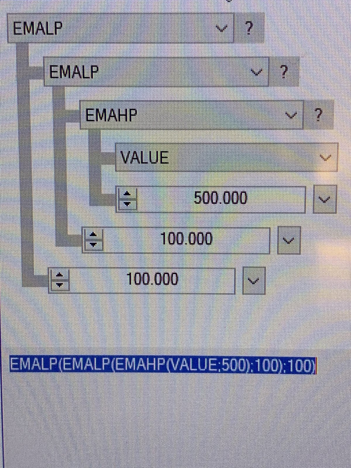

    Try another combination of lp/hp for ex: this one to see if your feeling of back kick gets attenuated :

    Exactly the filter I have been been trying to do this afternoon.
    But I'm struggling to incorporate it right now in Mover.

    No HP parameter is 500 check the lines
  20. alex928gt
    alex928gt Member
    May 2, 2020
    44
    409Coins
    You're right, typo on my end, but still adds a lot of delay.
