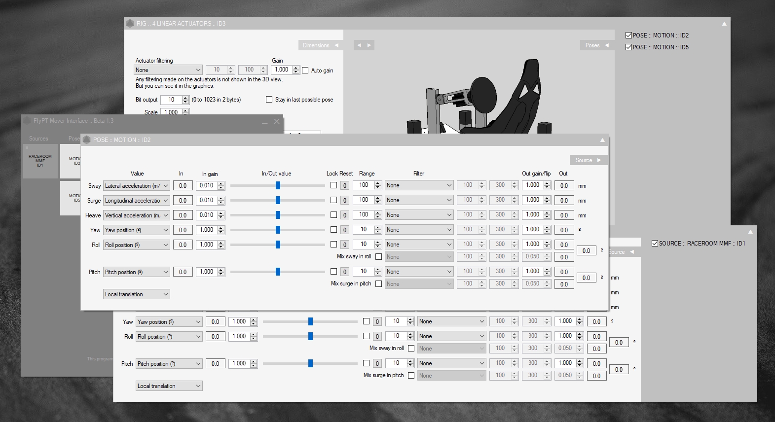

    .... also what is the purpose to use several SimTools MMF instances?
  4. pmvcda
    pmvcda aka FlyPT
    Nov 3, 2010
    2,272
    Portugal
    15,902Coins
    +2,716 / 18 / -0
    Do you mean
    multiple modules open in FlyPT Mover?
    Well, that's something I want to limit for some modules.
    It's a missing property. But simple to implement.
    While in memory mapped files we can have multiple accesses, that doesn't happen in UDP.
    And if you open two sources for LFS (UDP), only the first one works. This needs to be blocked.
    But it was kept like that, because for example loop sources can be more than one to make certain effects.
    So it was kept like that from the basic idea of modularity.
    I was going to limit it, but then I came with gravity in the sources...
    And I thought, that it could have some interest to mix the same source with and without gravity (maybe useless).
    But in the end, maybe I could put gravity just in the motion cuing... I'm a bit lost for now. Need to think it better.
    or two plugins in SimTools?
    The SimTools plugins for FlyPT Mover and FlyPT Hexapod Interface are completely independent.
    They are diferent, in the amount of data and how info is sent.
    In FlyPT Mover, I send the 12 axis (axis1a to axis6a and axis1b to axis6b) values in double format to the FlyPT Mover.
    In FlyPT Mover I use that data to fill the same name axis and also the sway, surge... like in the FlyPT Hexapod Interface.
    I'm not really understanding what you mean.
    You can mix axis how you want in SimTools.
    And use the 12 to send data how you want.

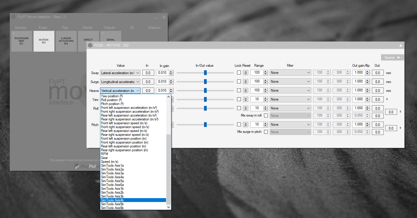

    For what you mean (I understand), I would put in SimTools something like:
    sway 100% in Axis1a
    surge 100% in Axis2a
    heave 100% in Axis3a
    yaw 100% in Axis4a
    roll 100% in Axis5a
    pitch 100% in Axis6a
    extra1 100% in Axis1b
    extra2 100% in Axis2b
    extra3 100% in Axis3b
    extra1 100% + extra2 100% + extra3 100% + heave 100% in Axis4b
    Now on the pose you select Axis4b for heave:
    If you want different filtering in the extras and heave, you can add multiple poses:
    (here I used Axis4b just with the extras)
    Don't forget to select both poses in the rig to add them.

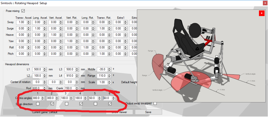

    Quick question sir, I am about to try to take advantage of your new rig with the 4 linear actuators, but before I pogo my actuators into oblivion (SFX100 build) could you please explain what the 'midpoint' and 'range' settings signify? The rig looks to be at rest, so is the midpoint a measurement of the extended actuator shaft at rest and then the -50 and +50 is total travel either up or down from that point? we have a total of 100MM travel on the actuator so what would be the correct numbers to plug in?

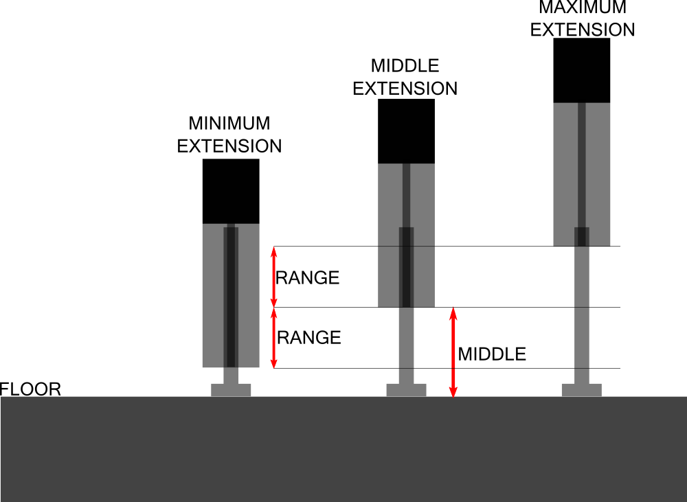

    Please be careful. I could not test it. I have not that kind of rig.
    Hope this image is enough:
    Middle is the distance to the floor when actuator is at middle.
    If you don't know it, try to measure distance to floor at maximum and minimum extension.
    Difference/2 is range
    Middle is range+distance to floor at minimum extension

    @Tim Palmgren,
    What is your hardware?
    What motors/controllers?
    Do you use it already with SimTools? What connection string?
    Sorry, it's just to be safe before using it. We don't want to damage anything.

    Tim is using AMC-AASD15A controller (AMC1280UB compatible output string).
    750watt servomotors with four SFX100 (100mm stroke linear actuators, floor mounted (vertical)
    https://www.racedepartment.com/thre...-6axis-servo-motion-controller-thread.168360/
    I'm going to leave here the settings needed for the AMC controllers too:
    The output string to use is:
    <255><255><Axis1a><Axis2a><Axis3a><Axis4a><Axis5a><Axis6a><0><0><0><0><10><13>
    Set serial speed to "250000"
    Set interval to "2"
    In rig: Set bit output to "16"
    And here is quick example of this kind of rig, running simtools:

    @pmvcda Ok that makes it a bit clearer. So if I just measure actuator housing to floor at rest, then actuator housing to floor at simtools initialisation (when it goes up halfway) then when it is at maximum travel that should give me the right numbers to plug in?
    So as an example;
    At rest actuator housing to floor = 95mm
    rig initialises, rises 50mm (bottom range) = 145mm
    extends to full extension rises 50mm more = 195mm
    which means midpoint would be 145mm and then the other two would be 50 and 50?
    I have the emergency stop on standby as well lol
    I will follow the procedure you suggest if I have some time tomorrow night to set it all up. I have had an initial look at all the settings and installed the software but will need to dedicate some time to hook it all up. One of the reasons I was intrigued is that you have those suspension types for both acceleration and for position which I would love to experiment with, the other thing is that I would like to have a really shallow heave axis that extracts the 'rumble' or a thin slice of surface detail, and then that is layered on top of the normal heave axis which is more filtered, which would allow you to get really high, unfiltered fidelity of the track surface but it doesnt feel like hitting a kerb in a shopping trolley when you hit a kerb as you can filter the 'normal' heave axis a bit more for the larger suspension movements. The SFX100 software Simfeedback does have the ability you discussed to make the actuators act like transducers so you are actually spot on, it is being used by them currently as optional effects for RPM and suspension rumble.
