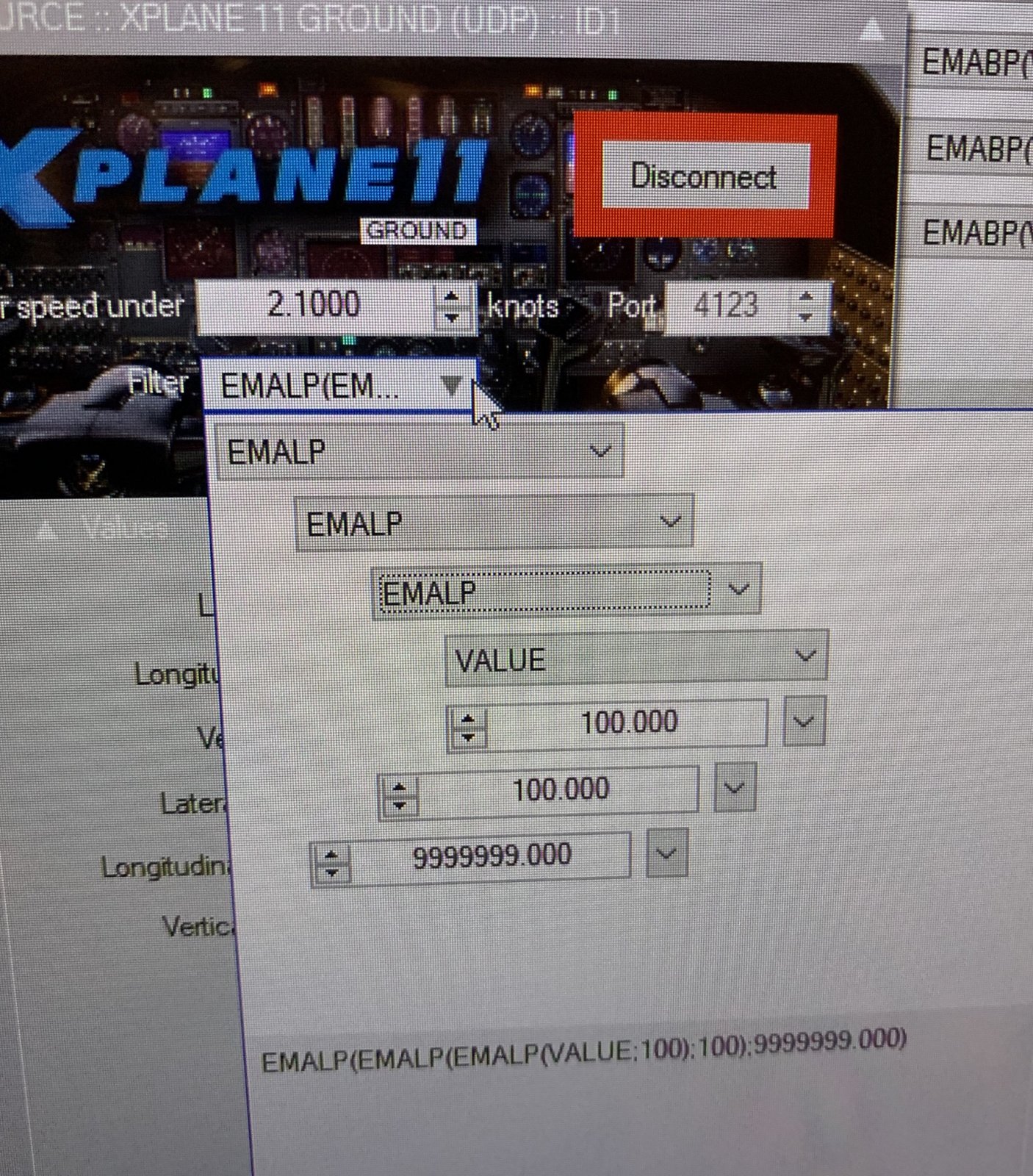

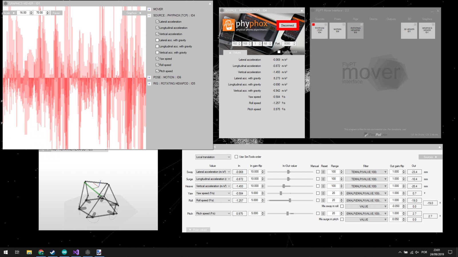

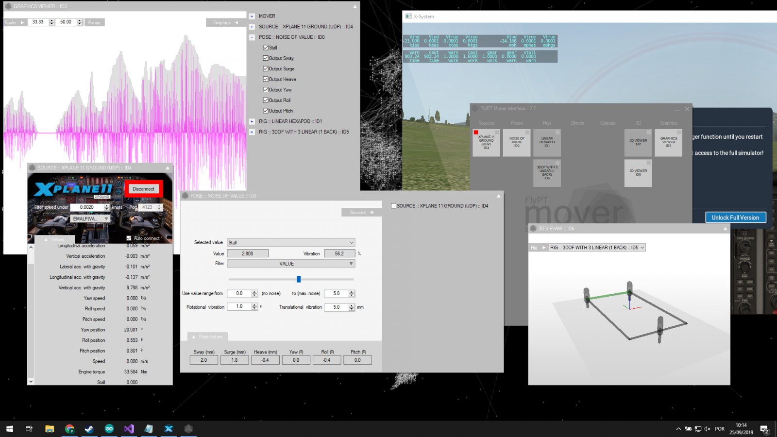

    Is this the right approach to construct a third order with smooth „entry curve“
    I have some difficulty to not only smooth the spike but also passing the assigned threshold I am getting a big kick. (Changement of Input Signal)
    Do you see what I mean ?

    hmmm,
    Might be something there...
    But are you changing the value frequently (on the filter).
    If so, I need to make a transition on the filter, because he resets each time you make a change.
    I will try to reproduce with those values.

    Yes hmmm that’s seems complex once you start to superpose the exponential math.
    It’s maybe the ordering which is wrong.
    I don’t know why I was thinking It was possible to smooth and lower the spikes without the kick on threshold.
    Once I experience it, was clear that it can’t work out of the box.
    Actually what’s easy to imagine “JUST smooth below a designated speed” is not easy to achieve. The “JUST” might be problematic to get.
    That’s similar while you change from ground to air.
    It’s becoming obvious in this case as well - different filter = kick.

    Maybe you could pickup the last value before changing and apply it with a HPF for a period until it gets overwritten. Honestly I couldn’t imagine we would face it but it’s pretty obvious.

    Using the soft start stop is what I had in mind.
    On the old program, we didn't have this problem. At least not the same.
    I had limited filters, so I used an instance for each one and could keep it more stable. Problem was mainly when we changed to HP, making a sudden change from a high stable value, to almost zero.
    In Mover, I started making a reset on the filters, like I had in the old program, by making them start with a specific value. With this I could keep it smooth, but it's not going to solve the LP to HP to LP changes.
    And it's way more hard than I thought.
    So the best solution, the one in all, is to use a soft transition. I store the last position before changing the filter and for a specific amount of time (user defined), the result is a mix of the old value and the new value until the transition is done.
    I have it already in the outputs for soft start/stop. Just need to adapt it to filters.

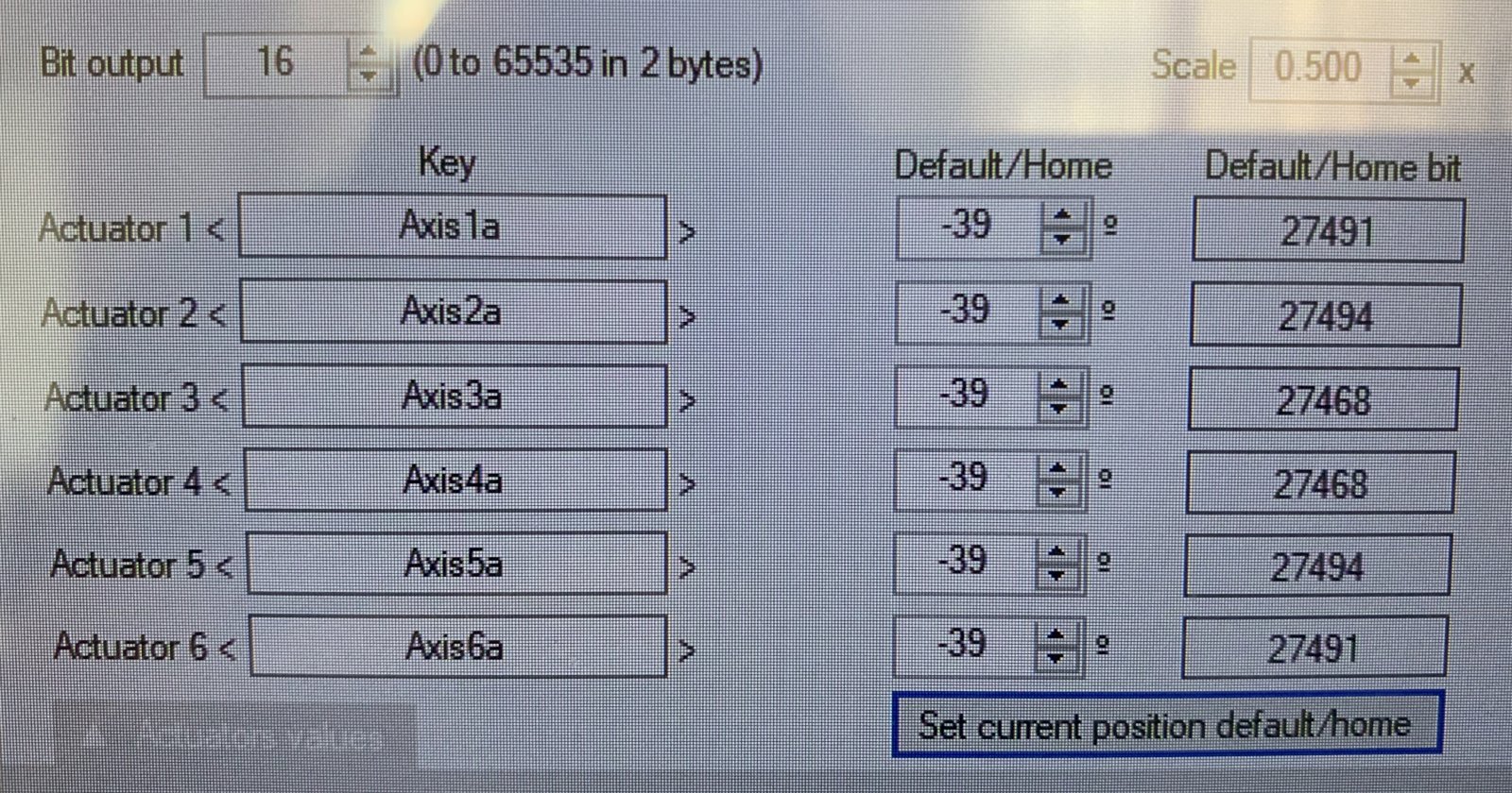

    Have you tried the soft/start in output? You can go to the rig definitions and specify the default actuator position.

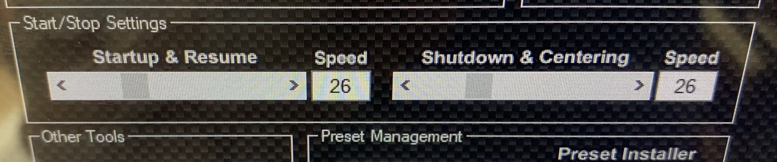

    Works. It takes 10s. Maybe similar thing for “game pause” and start but faster would be good.

    In menu->options you can set the time for the start stop transition

    Something strange has happen.
    I changed the speed values first to 50 than I switched to 10. Testing with 10 has lead for some reason to full speed movements over the boundary limits. (Pretty dangerous for the mechanics)
    I am using the bit output ratio 0,5
    I’ve put than the value 1 and restarted the program.
    It has increased the speed to the desired one without problems.
    It might be you have a small issue there related to how the values are applied.

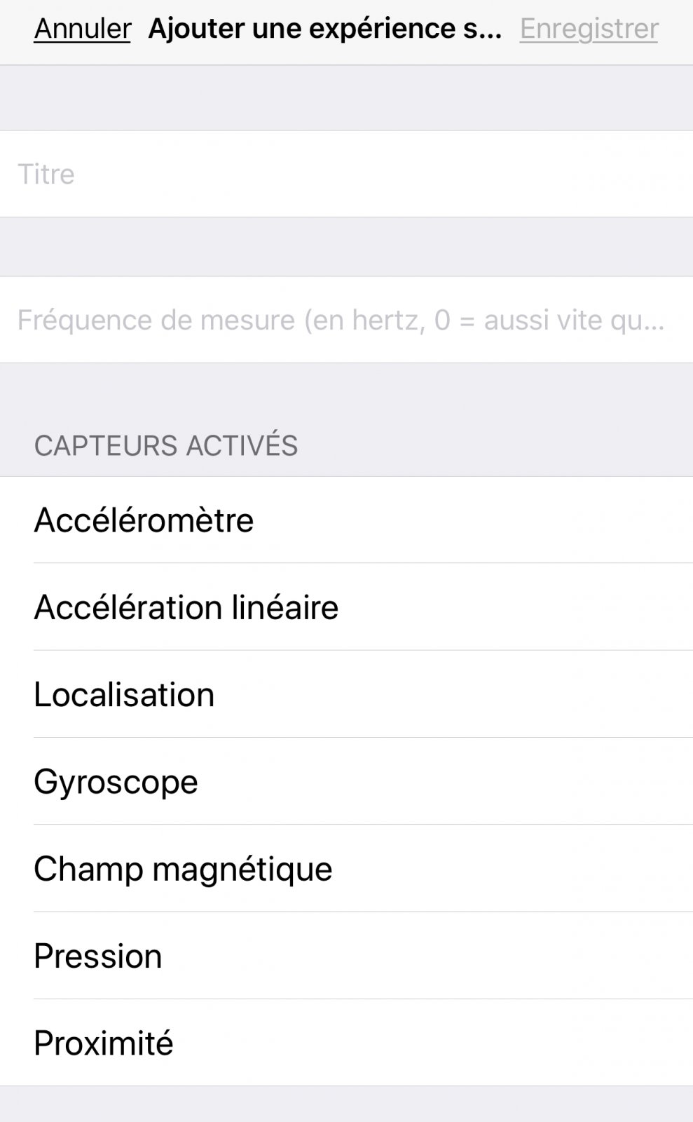

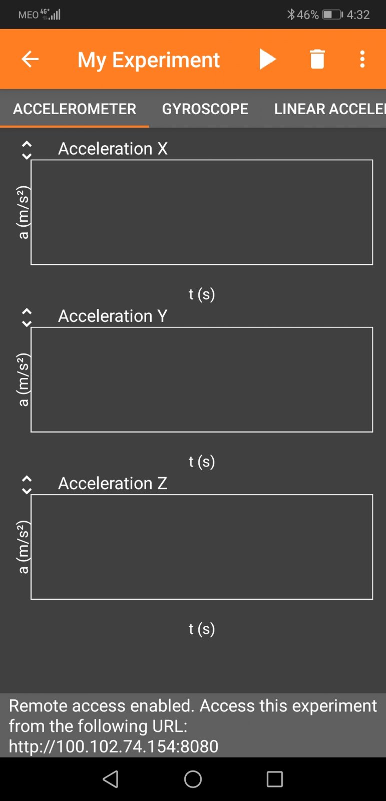

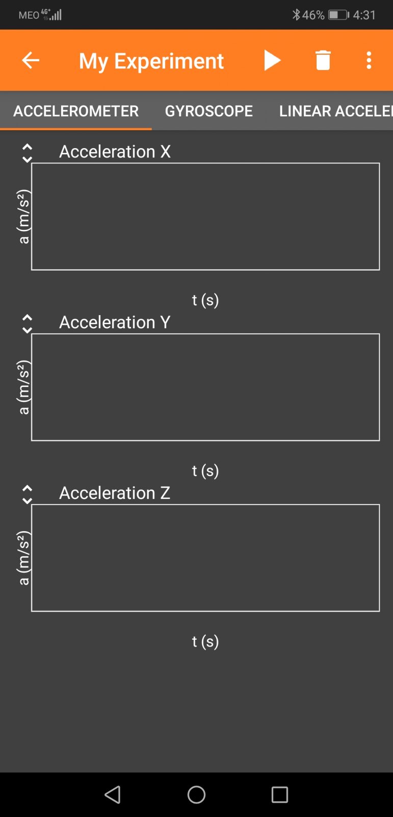

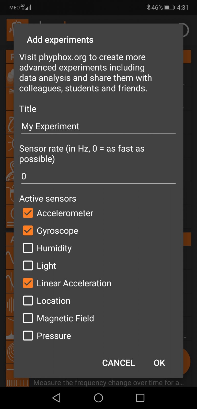

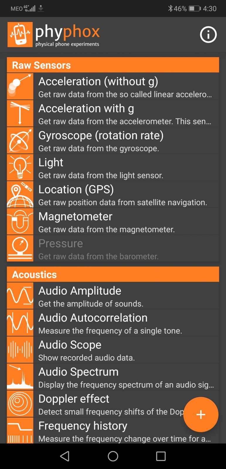

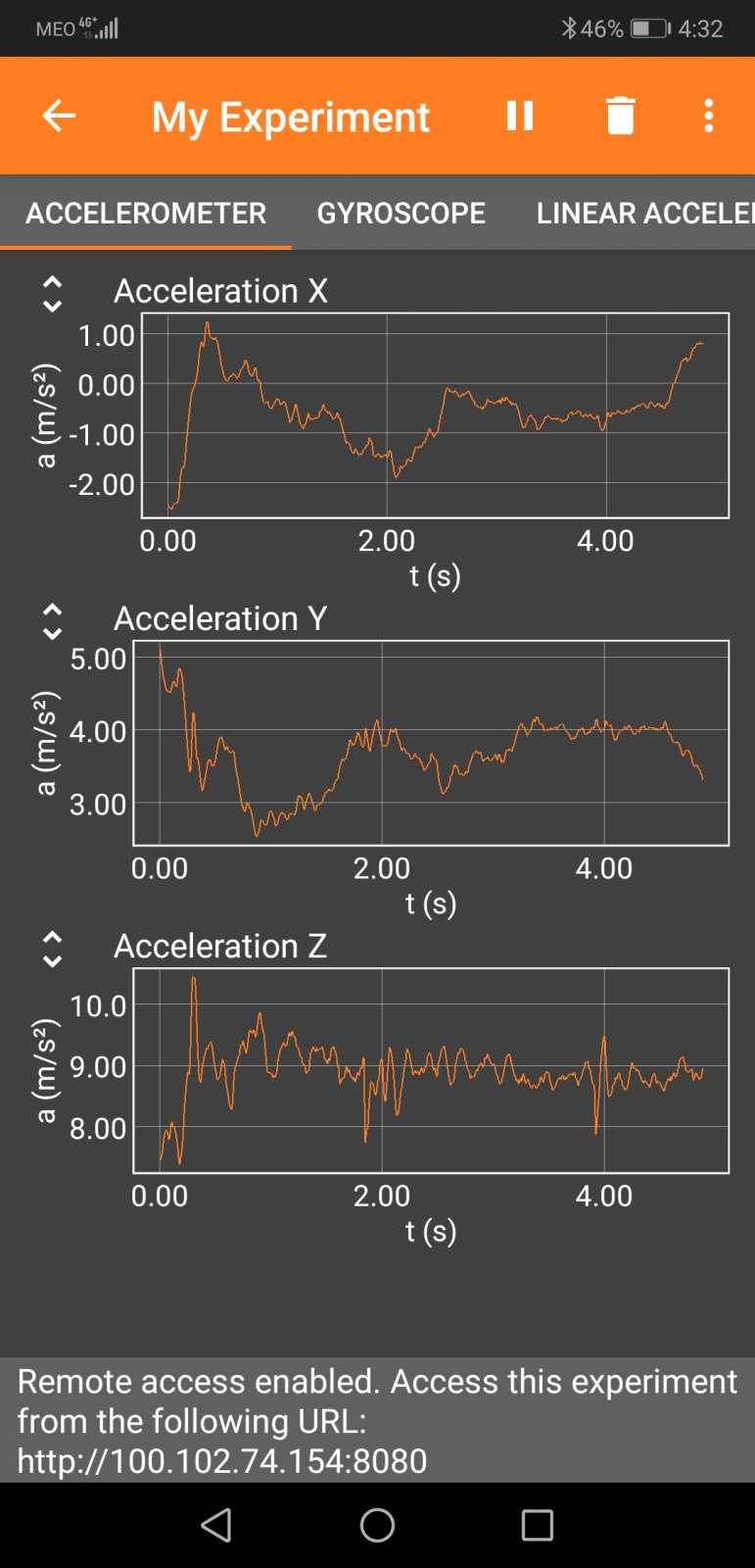

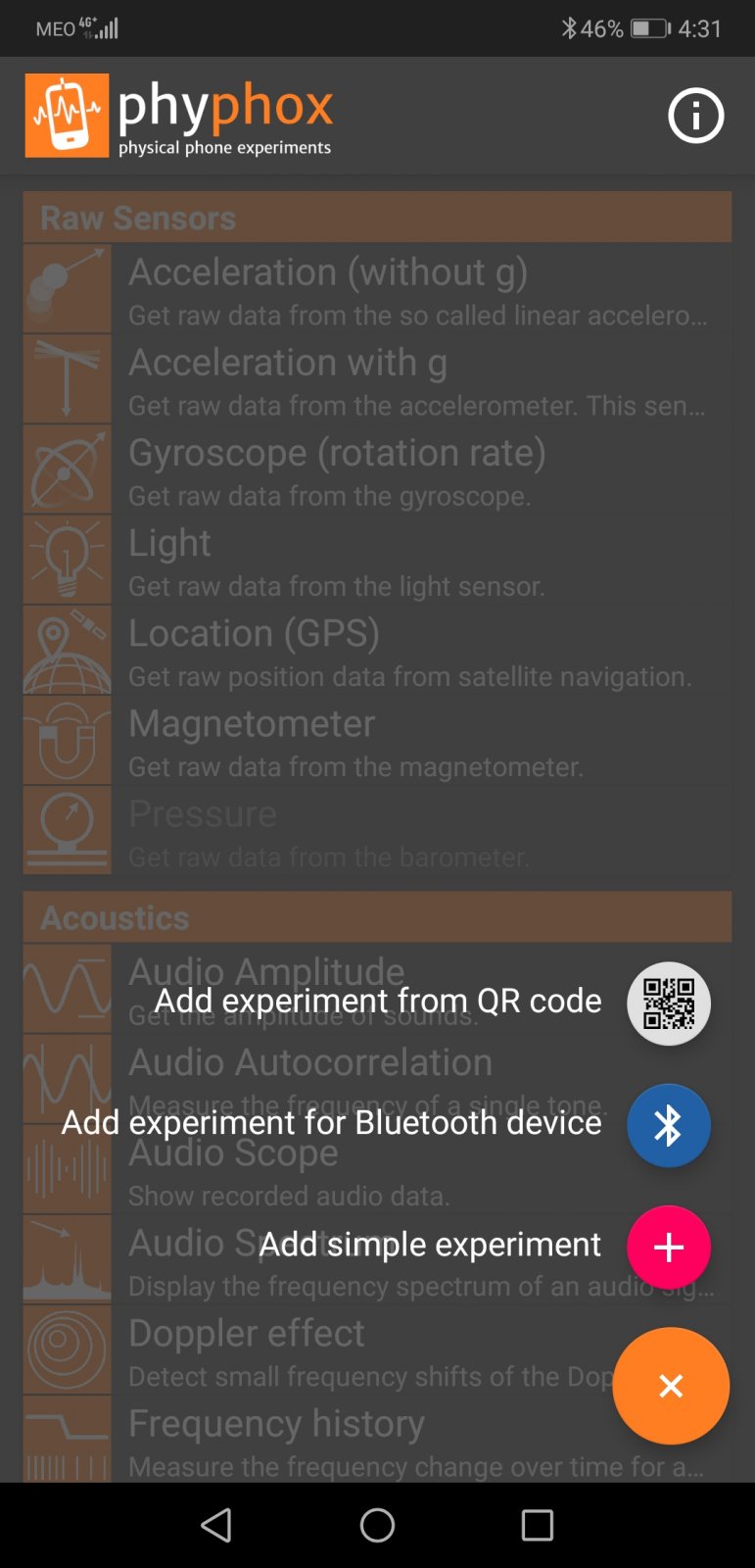

    Following your tutorial for setting up the phyphox experience I am getting only the accel wit g.
    The reason for that could be a different order for iPhone. Are you on Android ?

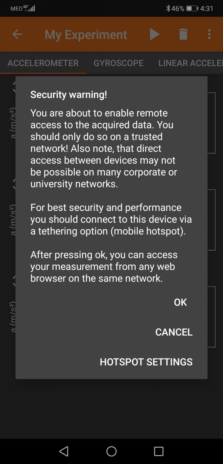

    Can you try to open the IP you received in a browser ans show me the print screen.
    That might be the problem.
    I'm on Android, and they might differ in the way data is separated in the text.
    Wold be good if you send me the text shown in a code quote.
