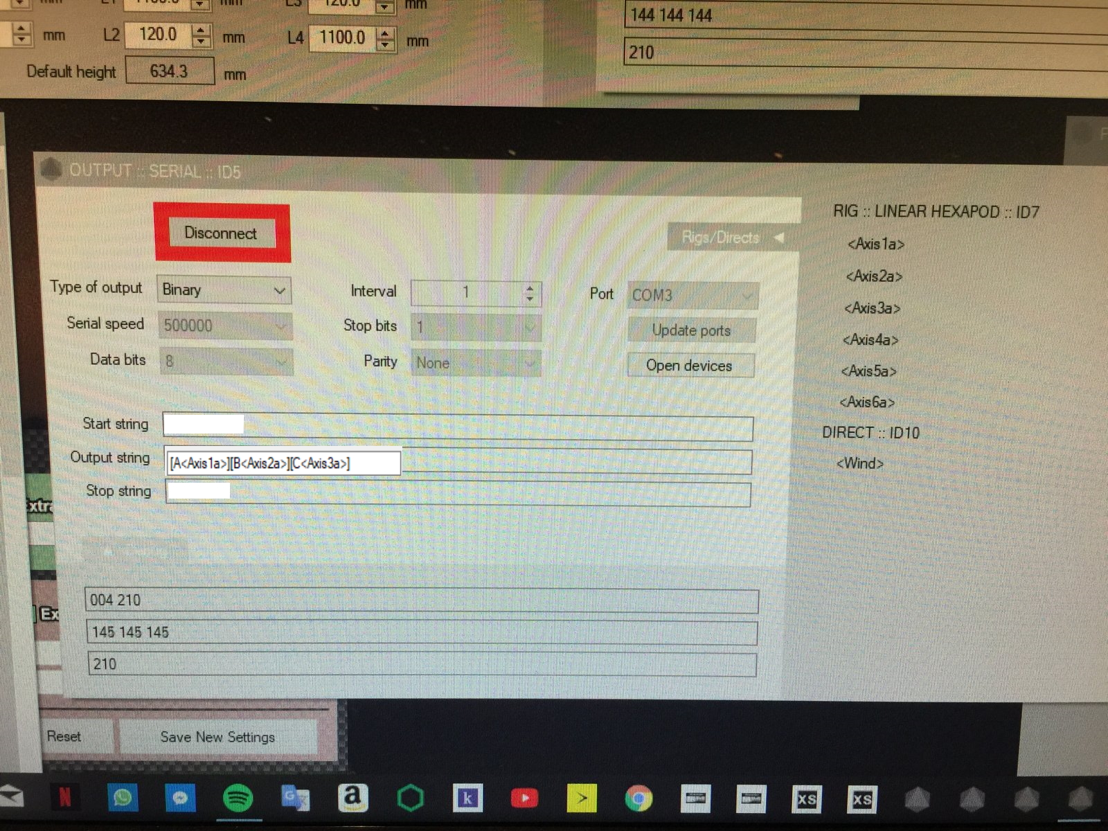

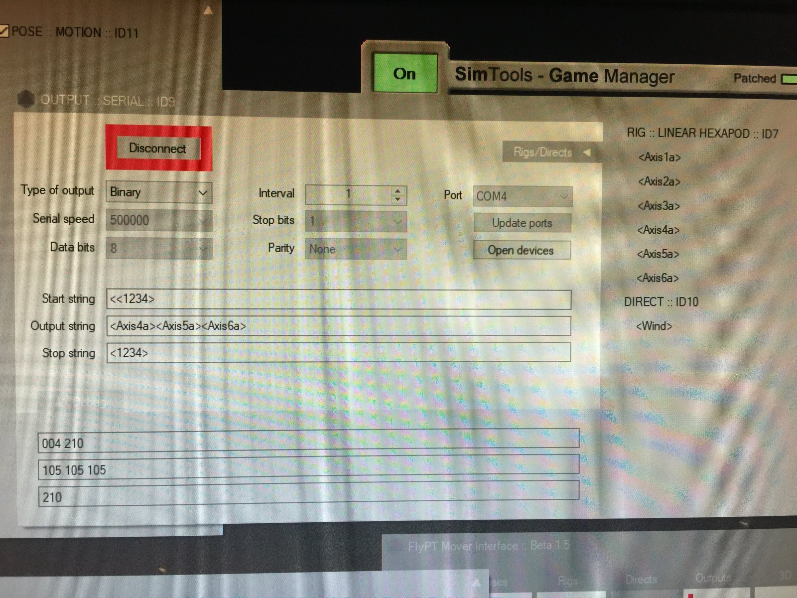

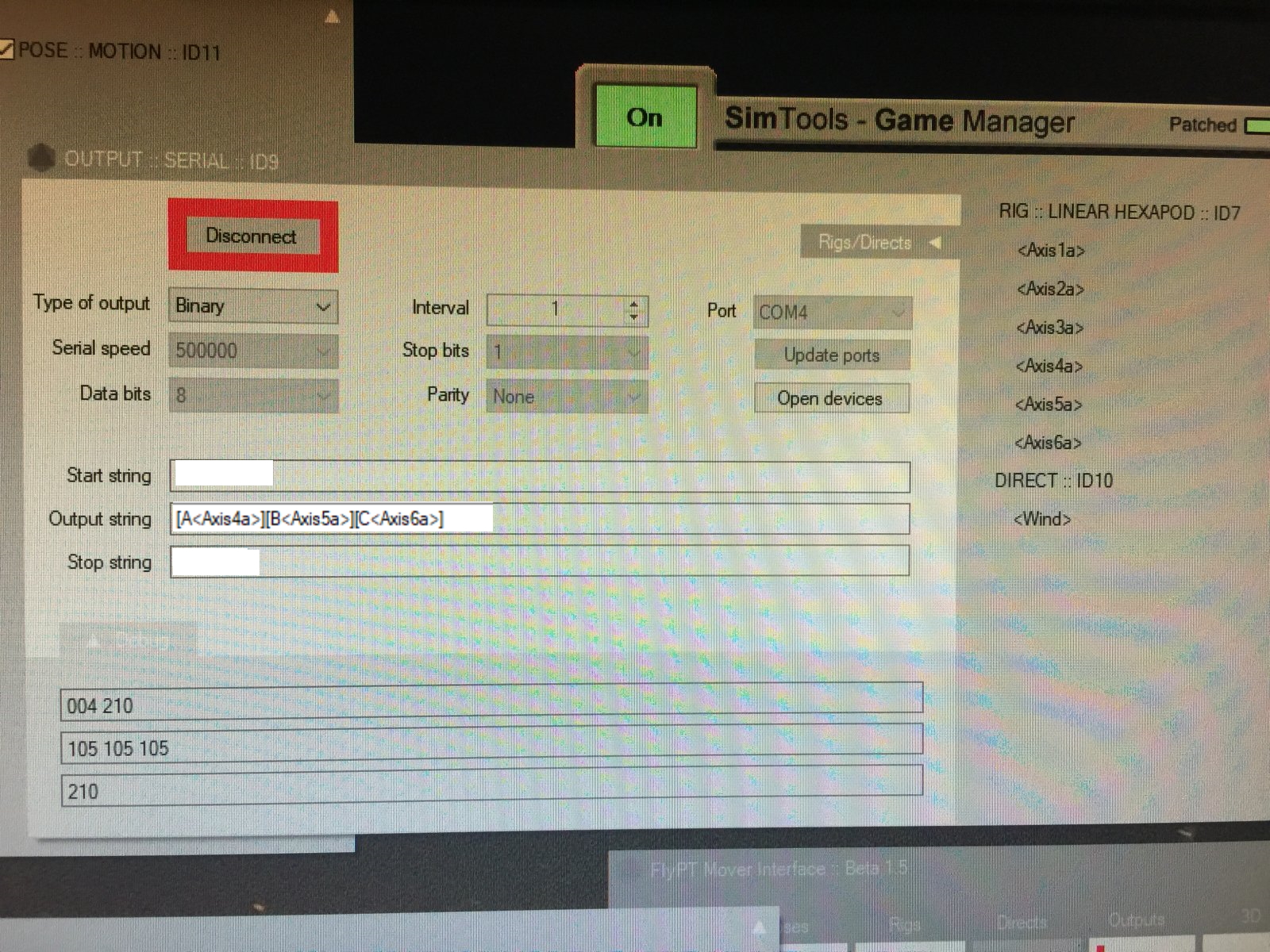

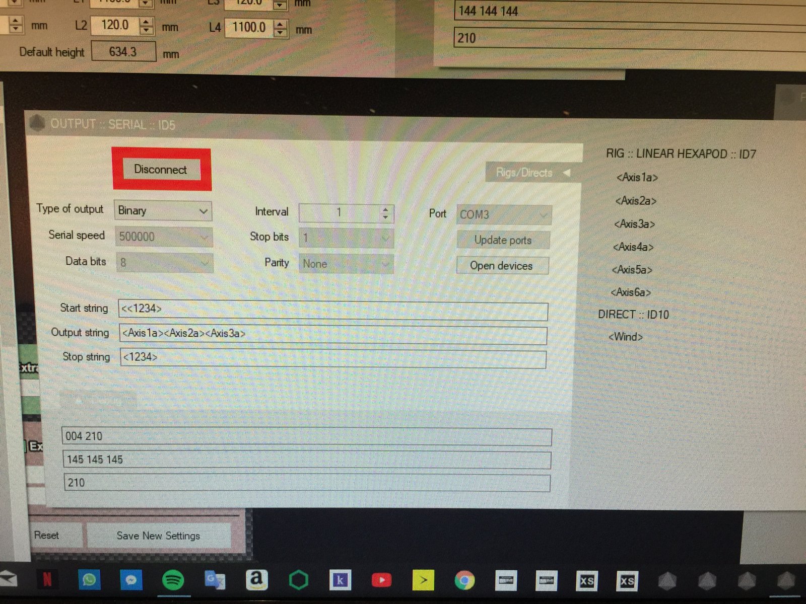

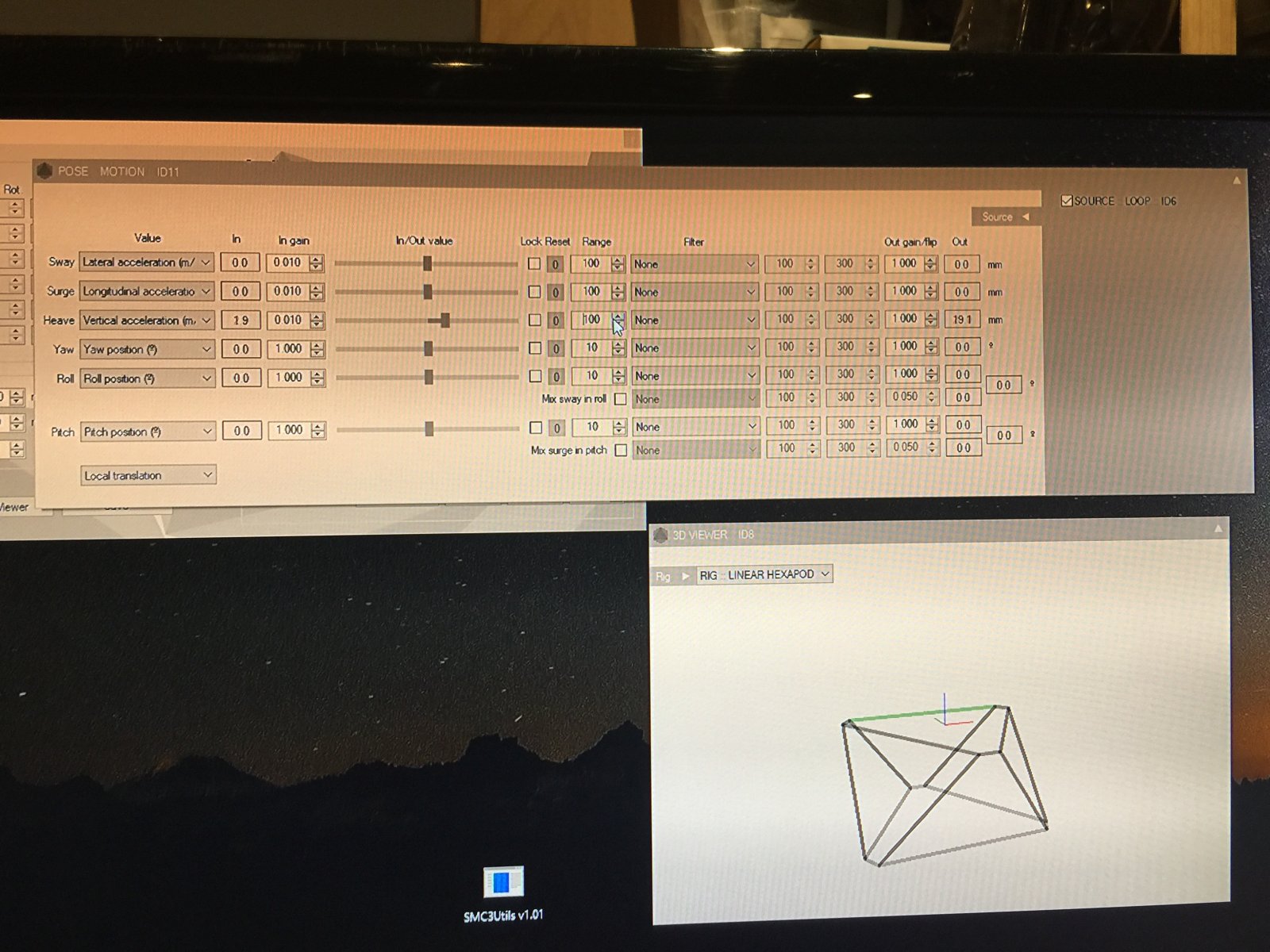

    DC motor, 6DOF
    Hello, missing something ?
    My Rig don't move … but 3D Viewer .. yes , maybe ( start string/ stop string are not good ????)
    Set up is : Pose Motion with only Heave
    thank you !

    What type of rig?
    Is it with AMC? 6 actuators??
    @Flymen Trip wrote this earlier...

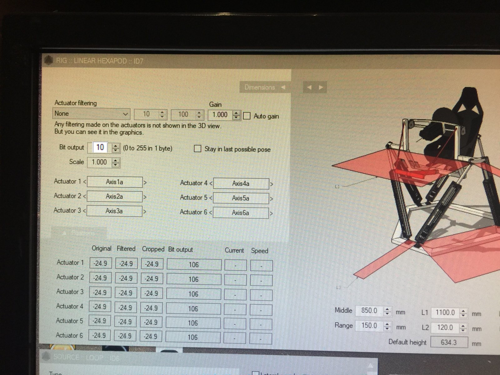

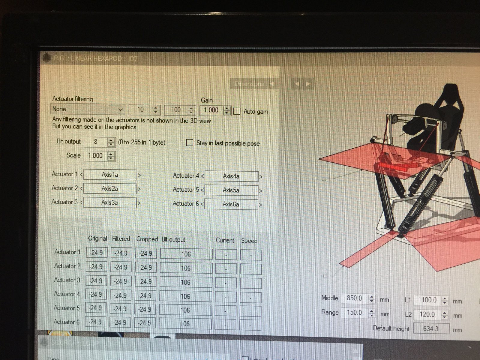

    I'm sorry, but current versions of Mover have many bugs and problems.
    I'm working on a new version with many internal changes. Need some more days.
    But, I think it should work.
    Do you really need the start and stop string?
    If not, remove them (clear the string)
    I see on the rig, that you are using 8bit output. Is that the value of your interface?

    Hi . I m with Arduino uno / 6 actuators
    set up with version FlyPt Hexapod Interface 1.8.7

    Try this:
  10. Flymen
    May 19, 2018
    353
    Montreal, Canada
    2,491Coins
    +195 / 2 / -0
    DC motor, 6DOF
    yessss, ca fonctionne !!! merci beaucoup hug:
    Thanks a lot everything work now !

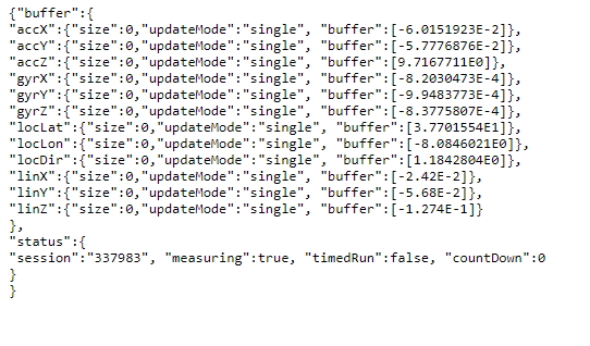

    This is the result of the request.
    Just need to get the info from here:
