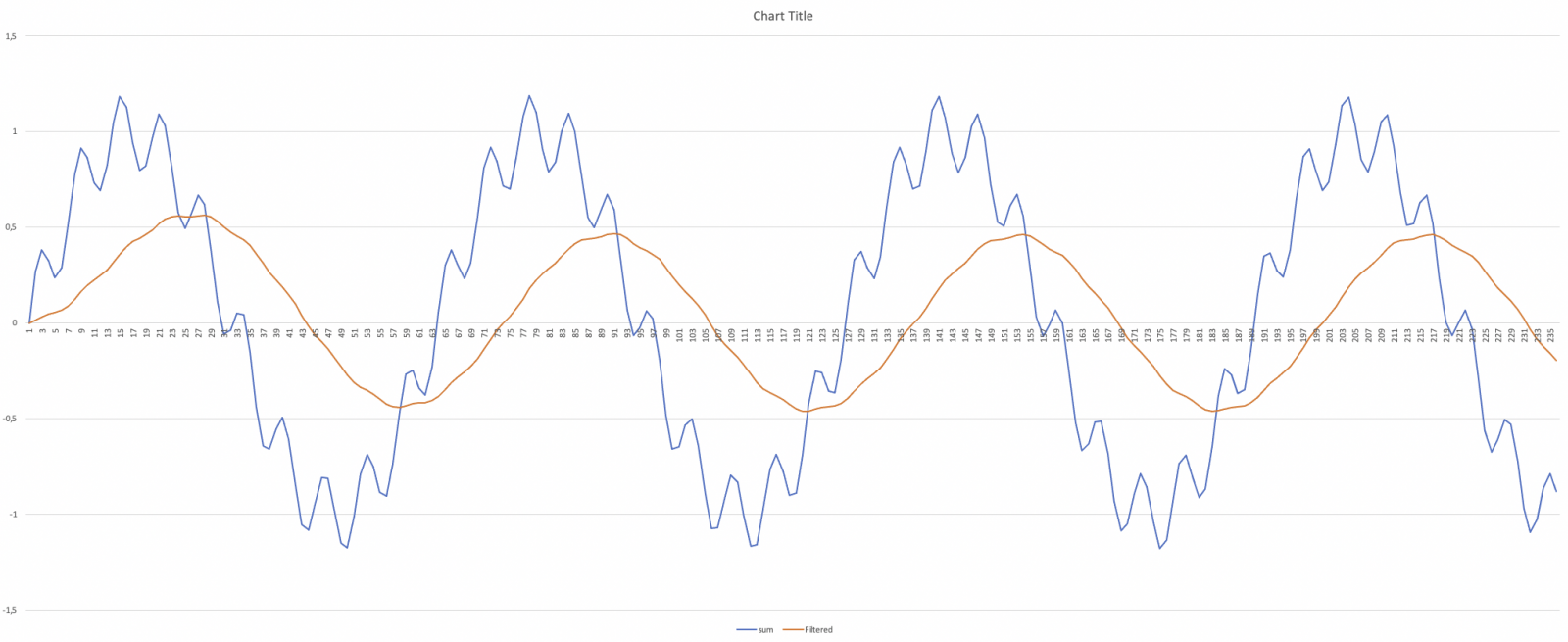

    A few notions I would like to add to the discussion:
    1)

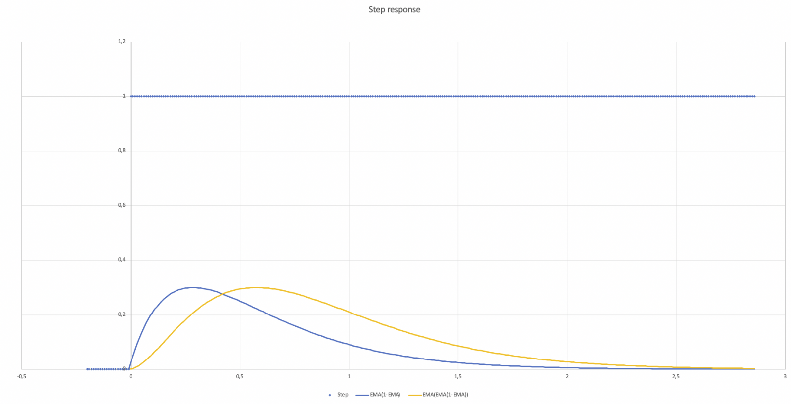

    The "kick" @alex928gt is talking about is not just a kick! It is always a kick and an immediate "kick back". If your actuator creates a displacement it must provide an acceleration AND a deceleration.
    That's why a HP1LP2 (yellow) or HP1LP1 (blue) is being used to filter the acceleration signal. The resulting step response curve will look like this:
    The idea behind this response curve is to allow the start of the motion to be perceptible, but suppress the second (and in this case even a third) kick below the threshold of perception. In this diagram the gradient represents velocity, curvature represents acceleration.

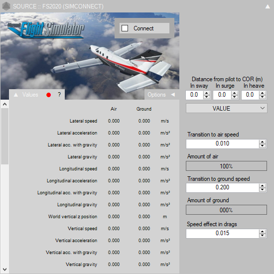

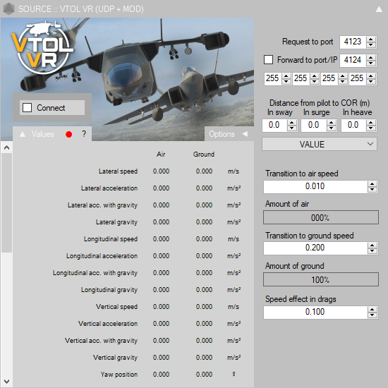

    - Help buttons marked with ?, directing the user to a specific section of the online help at flyptmover.com
    - New sources like VTOL VR, Warthunder and FS2020 (no more need for an extra exe file).

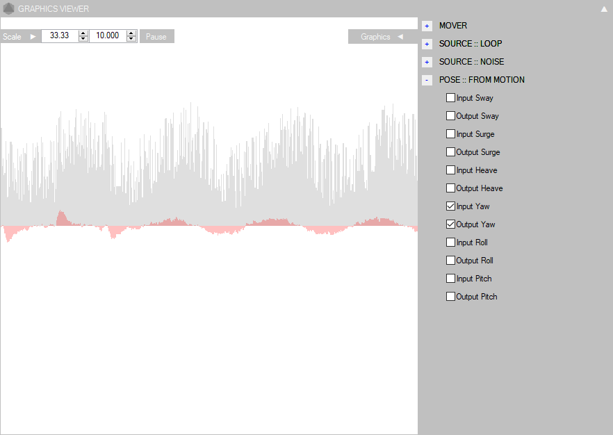

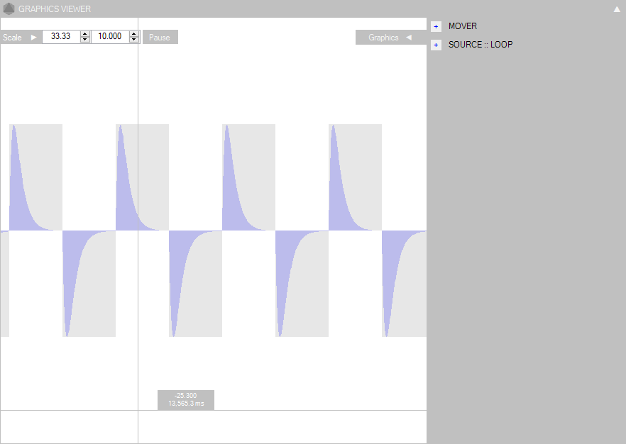

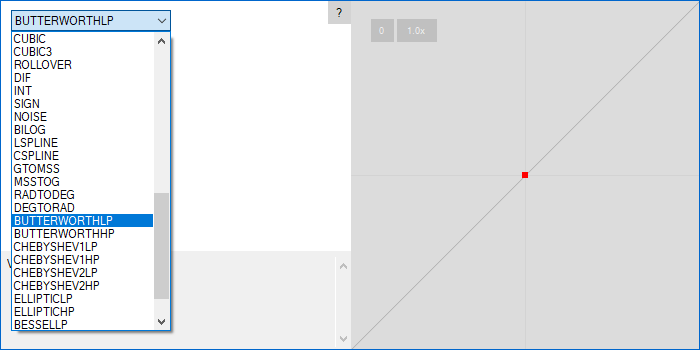

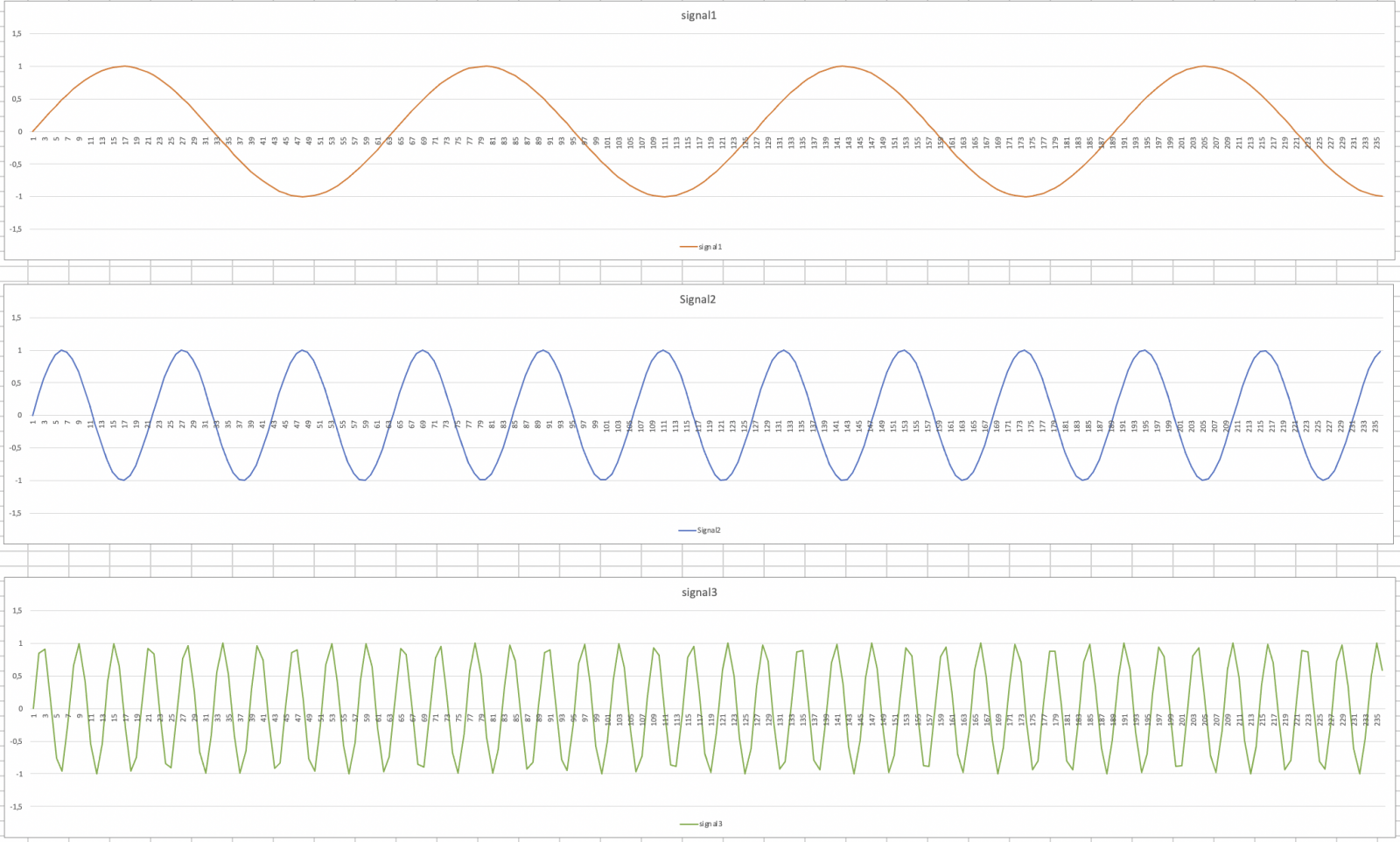

    That's what I do with the high pass and low pass filters.
    This is a square wave with a BUTTERWORTHLP(BUTTERWORTHHP(VALUE;0.5;1);1;1)
    LP=Low pass HP=High pass
    Now with noise:
    There's been some discussion around making a washout filter, but honestly, been trying to make something different, but without good results.
    There's even a WASH filter, just for my testings, but it's not good.
    The problem is that we keep getting data at high rate and we need to deal with it and represent it. Tried the WASH accepting values going away from zero and washing to zero anything lower than the current value. But it's completely wrong.
    I lack ideas to achieve such a filter. Might be to much into the low pass/high pass solution to even see anything else right now.

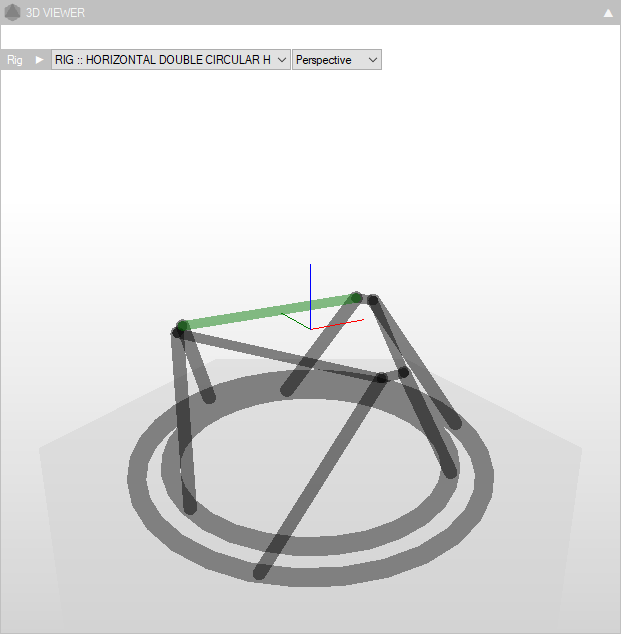

    hi ,
    thanks for your new release
    tested with 6dof rotating hexapod . used the alpha335 setup and recreate a new 6dof rotating hexapod but both surge and sway movement are roll and pitch . I disabled the mixing roll and pitch into sway and surge and the movement aren't flat . there something's wrong

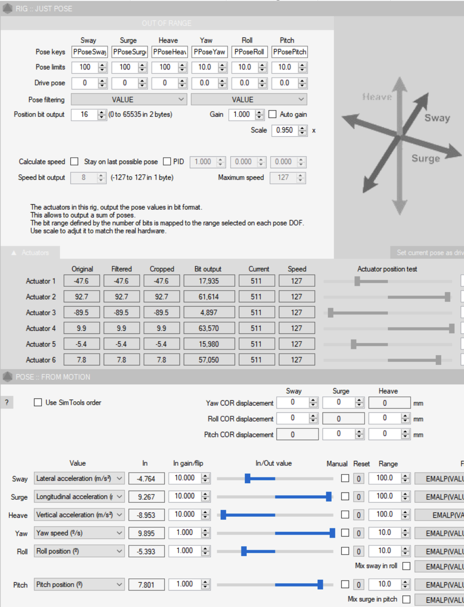

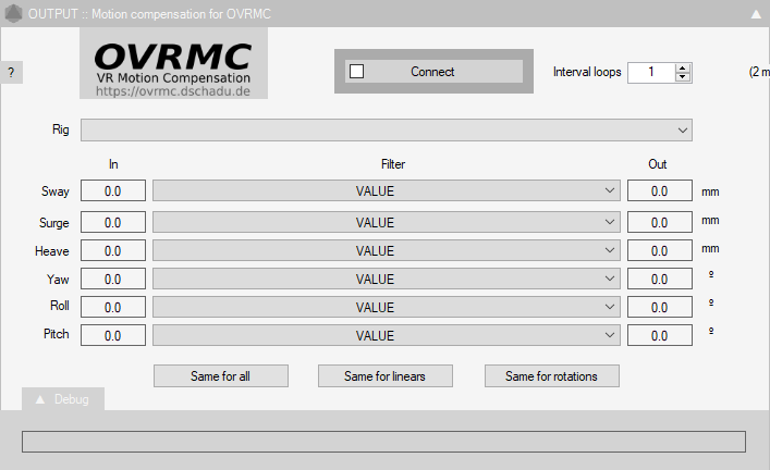

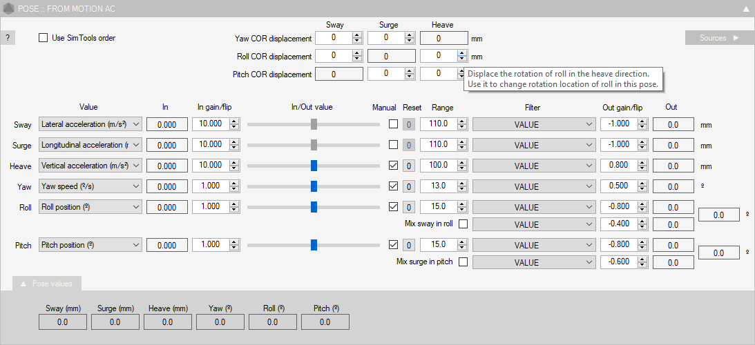

    THANKS so much for your latest release! Thru JUST POSE module Mover is now fully working on with my GForceFactory rig! On all 6 DoF with full envelope! With hardly any tuning (yet!) I could test it with my favourite flightsims.
    I couldn't withstand to try the new MC output module. I wasn't surprised that with compensation applied I drifted far more away in and out of the cockpit than with no compensation at all: @Dschadu on his website warns of an overcompensation issue.
    However I asked myself, how you (or Dschadu?) can do your calculations when you don't know the vectors of how far away my head is from CoR? Or do you? But the JUST POSE module gives no such indication...

    For the virtual tracker to work properly you have to adjust all measurements and check if 100mm in Mover equals to 100mm in real life. Also be sure that the VT is placed at the COR.
    Offset to the HMD is handled in the compensation algorithm.

    Thanks. Are you aware that the RIG::JUST POSE module lacks the "center of rotation" input values and, of course, all rig measurements?
    Would I need to use the "Yaw/Roll/Pitch COR displacement" fields (in the POSE module) instead?
    EDIT: The "range" values are now correct in both modules (not like in screenshot!).
    But maybe I should add that I use a WMR HMD (G2)?
    Using @pmvcda 's new Output module as VT I am no longer asked to interactively place the VT.
    Do I miss something?

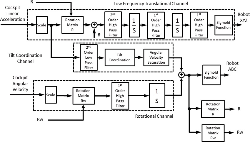

    But...
    This is all the purpose of Mover.
    You can use multiple layers of Poses in one rig.
    And the filtering allows you to make the motion cueing.
    Something similar to this:
    Visually, you almost have the classical motion cueing alghorithm in the pose from motion module:
    By default, filters are not filled, but you can put them however you want. It's customizable, because it all depends on what we have from the sources.
