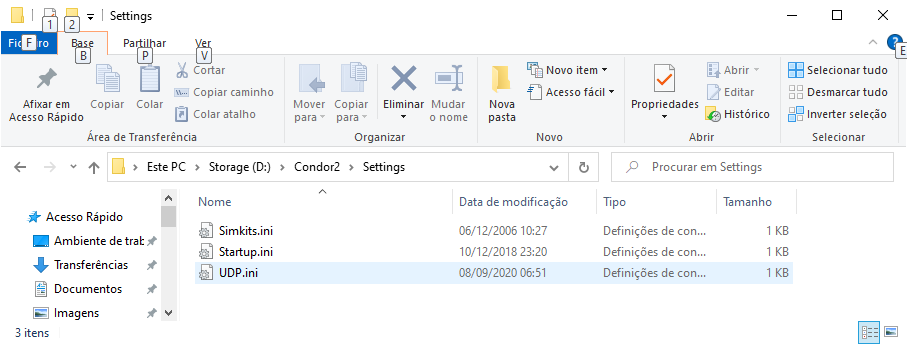

    ok ( It's easy fix) with Simtool , But now with a new version 3.3 I want to follow with source ; Condor 2 ( UDP) .
    I don't know what I do bad , but i no receive signal from Condor2.
    I will see the message ( UDP data) that you have send at Pierre . ) @Pierre Lalancette

    @Flymen what is your <CondorFolder>\settings\UDP.ini content?

    To use Condor, we have to edit the config file:
    Go to the installation folder of condor 2 and enter the setting folder.
    Edit the UDP.ini to match the following:
    Code:
    [General]
    Enabled=1
    [Connection]
    Host=127.0.0.1
    Port=55278
    [Misc]
    SendIntervalMs=1
    ExtendedData=1
    ExtendedData1=1
    LogToFile=1

    @pmvcda In the UDP.ini [Connection] section isnt it better to use 127.0.0.1 (localhost) for the Host ?

    Yes, you are right
    Just made a copy of what I have...
    I'm correcting the IP
