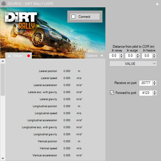

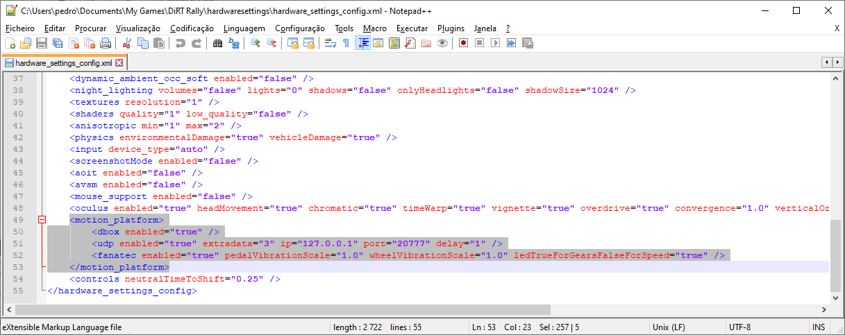

    @Pierre Lalancette ,
    UDP data when received is consumed, and it's not available anymore.
    So, what you are doing, is when getting it with SimTools, she's consumed and Mover is not going to get it.
    But in Mover you can receive it and resend it again (forward).
    Now, we receive data in a port and can send it again on another port (not the same)
    SimTools uses a fixed port, I think it's 4123.
    So what you need to do is to get data into Mover by using another port and then forward it to port 4123 like this:
    To receive the data in Mover (on the port 20777), you have to edit the config file.
    Go here:
    C:\Users\xxxxxxxxxx\Documents\My Games\DiRT Rally\hardwaresettings
    and edit the file: hardware_settings_config.xml
    In the marked text above, you need to have the udp enabled line just like I show above.
    Now you get data in Mover through that port and send it again on 4123 to be used by SimTools.
    Not sure SimTools uses that extradata=3. This makes Dirt send some extra data I use in Mover, and if SimTools doesn't recognise the data, it might be a problem.
    If the idea is to compare values and setups, that's the only way you can do it.
    You can also do it the other way, that is using SimTools, and send the data to Mover by using the SimTools source in Mover. But that way, data received in Mover is already transformed by SimTools, that's not the original game data.

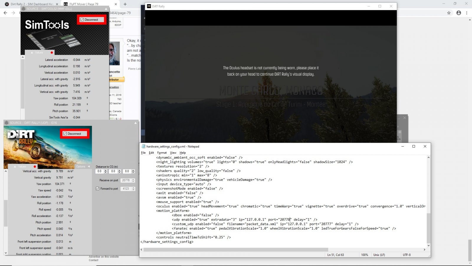

  3. Pierre Lalancette
    Dec 11, 2016
    1,009
    Tech Artist
    Quebec, Canada
    8,043Coins
    +945 / 6 / -0
    3DOF, DC motor, Arduino, 6DOF

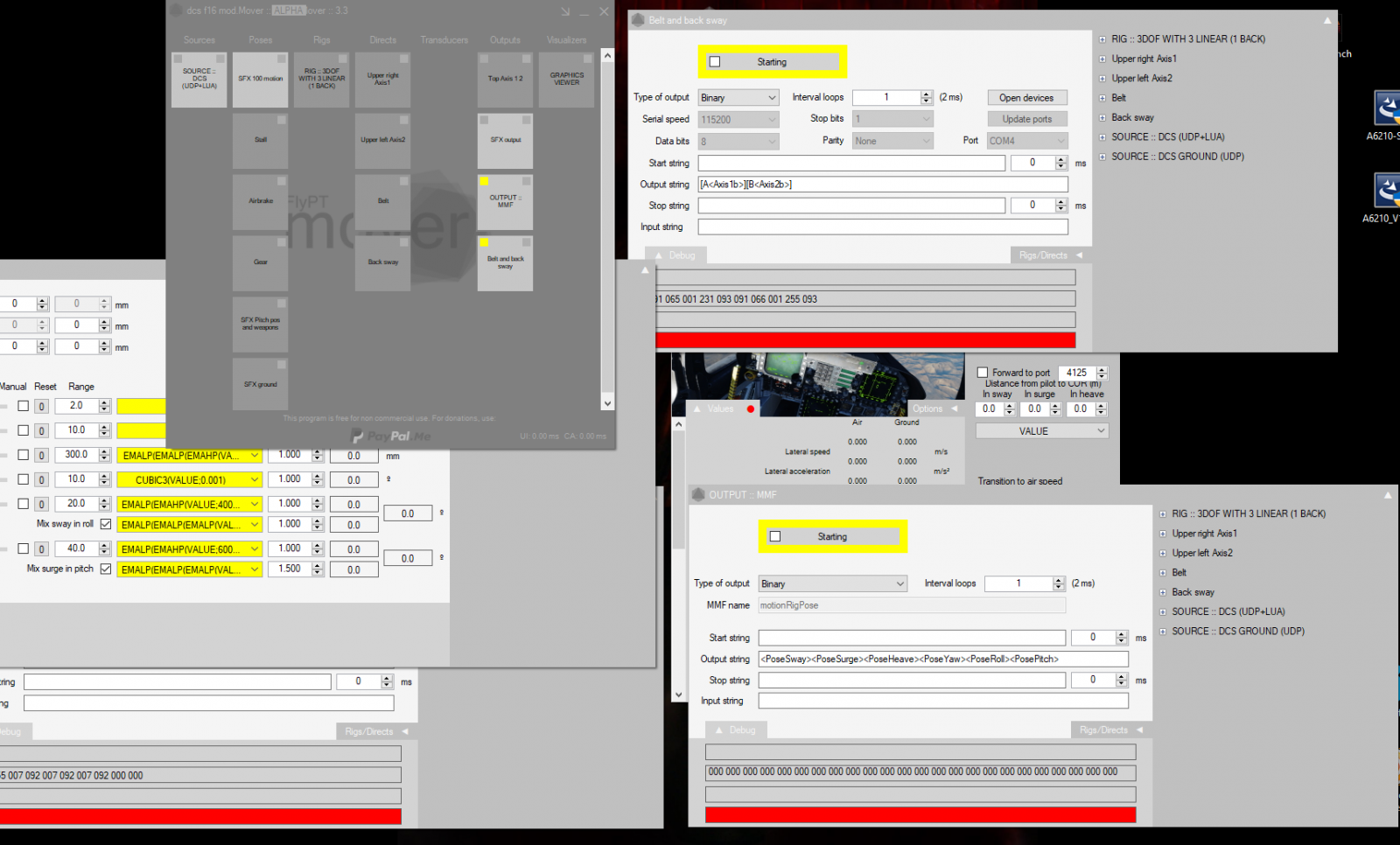

    Yes, I had it figured out. It is exactly what I'm doing. I guess you missed my last picture.
    But thanks for the respond and your good work, as always. Sorry that I took your precious time away from your next version of Mover.

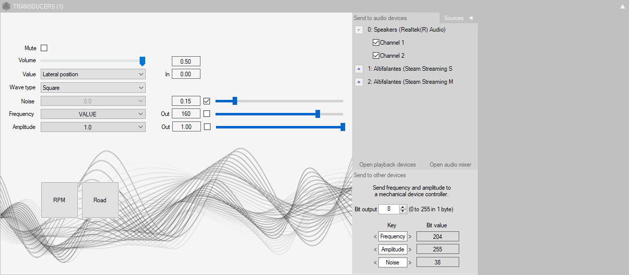

    Transducers almost ready for the first beta:
    Need to add some default effects.
    And it's possible to send the frequency, noise and amplitude of the sound wave through the outputs.
    This allows the creation on the controller side of those effect in the actuators, or the creation of mechanical transducers besides the usual audio transducers.
    We are going to have one window for each effect (for now), and they will show in the main window like this:
    Trying to make a release tomorrow. Let's see if I'm able to do it :confused:.
    But I think I will make multiple releases adding bit by bit and correcting bugs.
    All sources need a good review and the addition of extra data.

    Can you help me understand some practical use cases for "transducers"?
  9. Trigen
    Trigen Active Member
    Nov 25, 2018
    491
    2,891Coins
    +184 / 1 / -0
    2DOF, 3DOF, DC motor, Arduino
    I just use mine for some minor road texture and sometimes grip. There is tons you can do that compliments actuators

    @Mark Pattison and @Trigen ,
    I added the transducers with actuators in mind, but making it allows also the use of it in audio transducers, because the logic is the same.
    Using just serial to send data to actuators, might be a problem to achieve high frequencies, so the idea here is to send the needed data to the actuator and let him handle everything to generate that frequency.
    That way, we can generate that vibration wave perfectly on the actuator controller.
    If you send it by serial, you might end sending always the same value of the wave, or erratic values.
    Making it this way, we might achieve higher frequencies and more detailed. We just need the controllers to support it.
    You can also send the data to control a simple motor that rotates at a speed related to the frequency, with an eccentric mass to generate vibration.
    Or send it to an Arduino or similar connected to a bass shaker.
    Or the usual one, an audio board on the PC, connected to some bass shakers.
    This is still Beta and needs more testing.

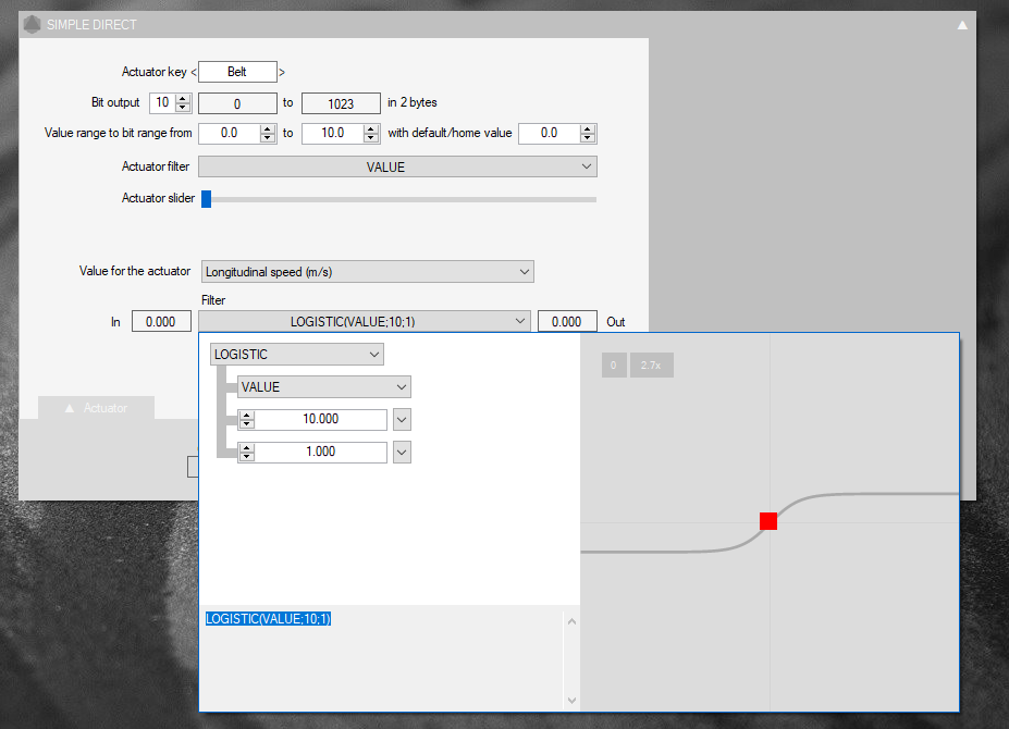

    Starting from a new static rig, I would like to follow a progressive path.
    is there a tutorial for using FlyTP Mover for only 1 DOF?
    like harness tensionner for example?
    Or did someone manage this and would mind to share?
    Thanks! :)
  12. pmvcda
    pmvcda aka FlyPT
    Nov 3, 2010
    2,237
    Portugal
    15,702Coins
    +2,674 / 17 / -0

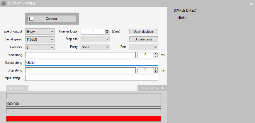

    An example, the scale of values might be wrong, I don't have a seat belt tensionner:
    Add a source, the game you want to use.
    Add a simple direct with:
    -Give a name to the actuator, maybe Belt
    -Put the number of bits used by the controller to position the actuator, I used 10
    -In the value for the actuator, use Longitudinal acceleration
    -In range to bit range, we are going to map the values received to the actuator travel
    I want it to move just for braking, not acceleration, so I would use 0 to 10m/s^2 (+-1g).
    This means that for position zero of the actuator (bit value=0) we have 0 acceleration, and for the maximum bit value we have 10m/s^2.
    -In the filter, use a logistic to limit the values to a range of -10 to 10 with infinitesimal approach to 10.
    Any value above near or above 10, approaches more and more the limit of 10.
    So with this we define how to move the actuator.
    We will never use the -10 on braking, because we crop them on the actuator (remember 0 to 10 in the range)
    -So now that we have an actuator, we need to output it's data with a serial output:
    Just put the name of the actuator there, in this case <Belt>.
    You need to setup it accordingly to your hardware.
    Note: Might have accelerations swapped, maybe it should be 0 to -10
    And the scale of the value might not be the best, but it's a way to start.

    We can map any value to a transducer and work on it through the usual filters of Mover.
    So we can play with frequency, amplitude and noise.

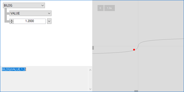

    - Added some extra filters for units conversion (for custom hooks and maybe UDP and shared memory)
    - WIP on special filter to generate custom response (LSPLINE=linear spiline and CSPLINE=cubic spiline) with graphical input (NOT WORKING!)
    - Added BILOG filter. It's a logarithm. I call it BI, because it works has a mirror on the negative values.
