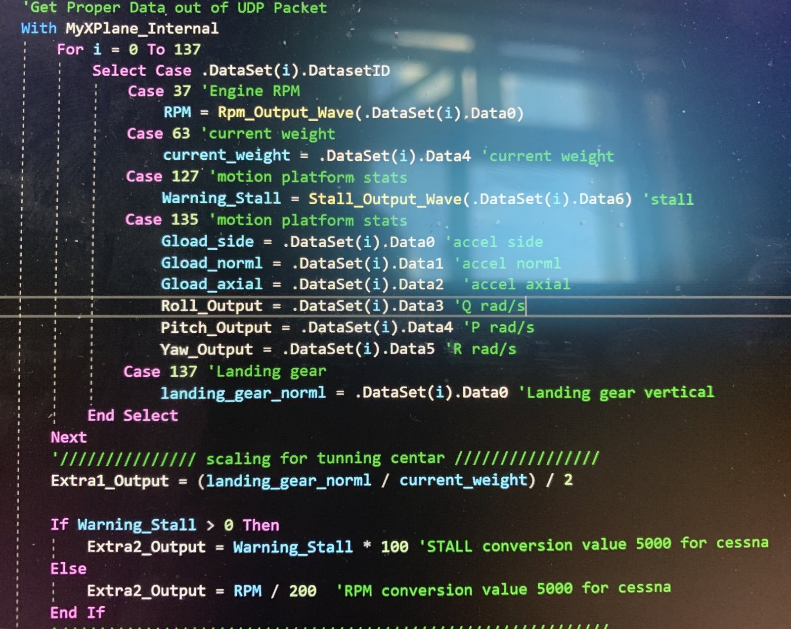

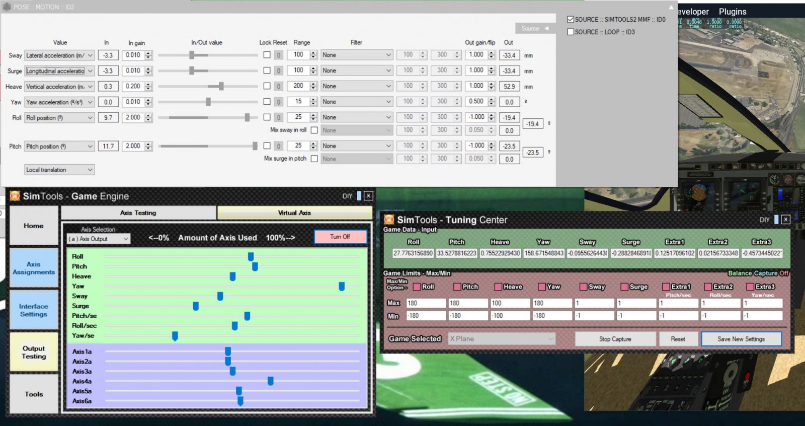

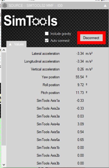

  18. Psionic001
    Psionic001 Active Member Gold Contributor
    Mar 5, 2017
    138
    Sydney
    996Coins
    +59 / 1 / -0
    Motion platform, 6DOF
    @pmvcda
    I've just been doing some X-Plane testing and noticed a couple of things.
    1) In Simtools turning the Extra 1/2/3 must have a value greater than 0 entered so I used 1. I saw you had recommend to use 0 in there, but nothing will pass from Simtools.
    2) <ignore this, I worked it out> On your pose: motion screen: See Sway and surge in the attached image, you can see they match. You probably have Longitudinal Acc mapped to the Lateral Value menu item as they move at the same time.
    3) Extra 3 in the SimTools tuning centre for X-Plane should map to Yaw Acceleration out of simtools. I need this for Yaw cues. Nothing happens here even when I drop the input gain. How do we manually map Tuning centre outputs of Simtools to Pose motion inputs? Is this done in sources? (so I used the yaw source in Simtools and put it to use Extra 3 and it didnt seem top work). Anyway, it would be good to get all 9 values from Simtools.
    4) To get the data from simtools tuning centre I set the Extra 1/2/3 to 1, I notice that the output values are usually way less than 1 (eg 0.02 or less). By increasing the gain in the Pose/Motion window to compensate, are we reducing the resolution of the original input signal to make a low rez output? <actually I just noticed Extra 1/2/3 are not being picked up from Simtools - I think that's what I need to learn>
