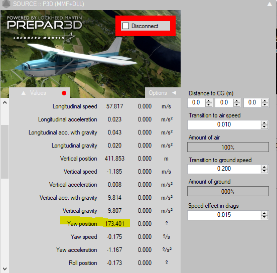

    I'm trying to configure my 6DOF platform for A320 full cockpit for the first time.
    I run the program to connect Mover with FS2020 and notice a pb with yaw ° position value within P3D source.
    The value for yaw is not related to aircraft yaw (eg -15 0 +15) but rather to the heading of the aircraft (0 to 360).
    Is it an error from the small exe for MSFS2020 connection ?
    If yes hope it can be fixed easely, if not then it's rather in MSSFS2020 that could take longer to fix.
    Thanks, Olivier

    I'm using the true heading, not the aircraft yaw.
    But,
    All accelerations and speeds are related to the airplane body, so you get the correct cues, because if you are moving with a yaw of 5 degrees, you get a lateral speed/acceleration besides the longitudinal.
    Hope you understand what I mean.
    In practice, for the motion cueing, the yaw is near useless in aircrafts.

    Thanks for our answer, yes I have since configured yaw acceleration instead of position following excelent post/sample config from @Dirty that help me a lot to undestand all the basic. I look foward to read additional post from him in his thread around Filter Research.

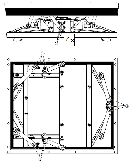

    @pmvcda Newbie question (may be answered by "read thru the 77 pages before and you'll FIND the answers!").
    I have a commercial 6DoF Stewart rig (Gforcefactory) that does all the inverse kinematics calcs in its firmware. So I need to feed not actuator instructions, but rather DOF instructions.
    For further clarification: when I load a Hexapod module and move one of the "Actuator position test" sliders, it acts exactly on ONE AXIS (with coordinated actuator movements).
    Can I setup a RIG module that bypasses the Stewart calcs?

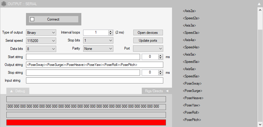

    Yes and no...
    If you setup a rig, you can output the pose of the rig:
    But the values are doubles in degrees and you can't adjust anything.
    This is used for motion compensation.
    If what you need are double values in degrees, then you can do it right now.
    I can add for the next version, a special rig just to output the pose in the desired format, I think it's easy to do it with the current structure.

    Thanks alot @pmvcda! I tried the "Pose" Output string, but with no success.
    However by changing the <mode_Axis> value to a number corresponding to "platform offset" I found a way to bypass the inverse kinematic calcs in the firmware. That looked as at least one solution found!:)
    BUT, when I tried to figure out what values I had to insert in the Rotating Hexapod Module I quickly got the intruiging feeling, that the layout of my GeforceFactory rig differs from the one used in the module.
    Maybe I'm wrong ?
    Anyway, and if it's not too much of hazzle, adding a "Dummy" rig that passes on axis instructions instead of actuator instructions would be great. In the end I may have two functioning solutions, but that makes me more happy than none!;)

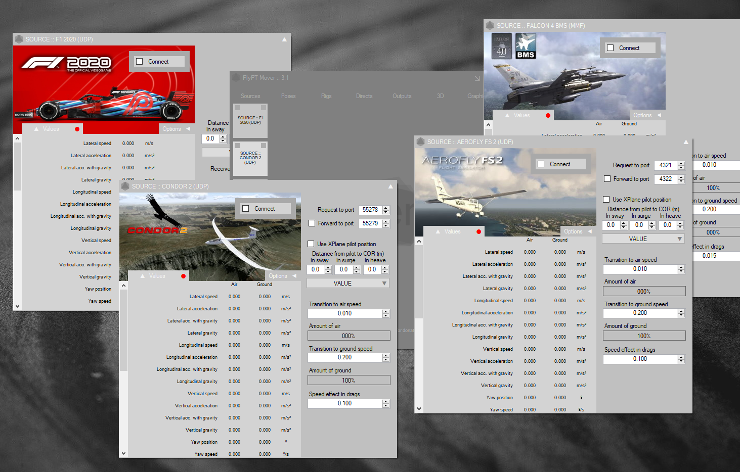

    Some new sources also:
    And others, like:
    - Final FS2020 source
    - VTOL VR (Still WIP)

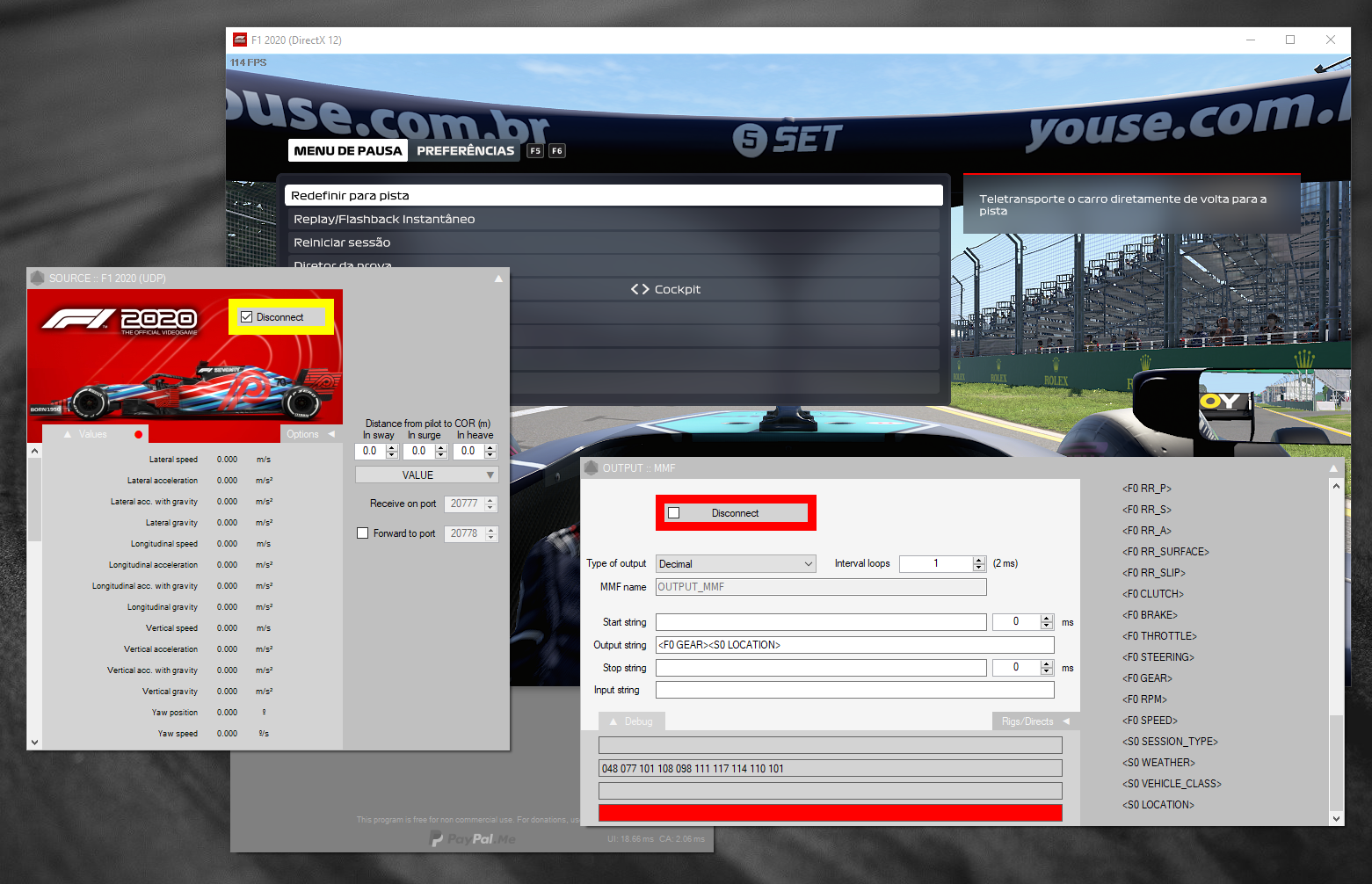

    Another of the updates coming with the new version:
    We can now send to the outputs, all the received values from the game (4 bytes floats).
    And there's way more values possible.
    It's also possible to get strings from the sources, like: location, weather, vehicle, ...... and send the byte array through the outputs.
    Well, sources need an upgrade in the data, but it's already working on some sources.
    And if you noticed it, the outputs can now receive feedback from the hardware (still WIP).
