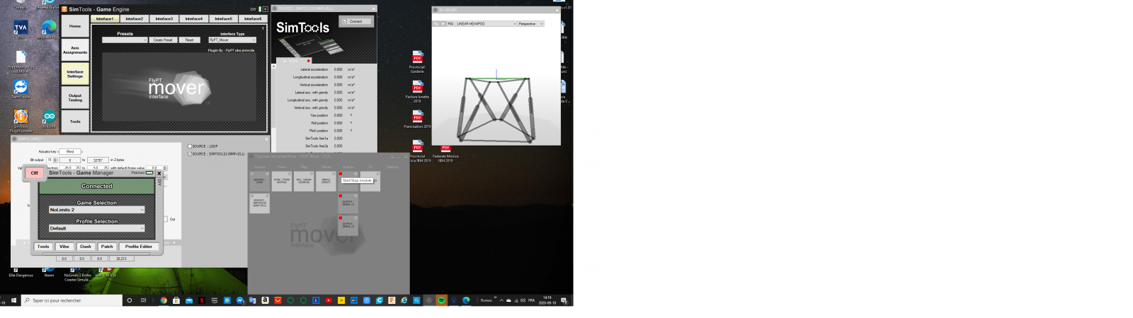

    Hi ,@pmvcda , I have the same problem , No connection , I have this version 1.0 . ( Flypt mover 1.0)
    Is it the last version ? and where they are ?
    Thanks again for your help !

    Hi ,
    Ok , my problem was I had the old version 1.0 , now with 1.1 from last version 2.99 FlyPt everything is ok with simtool.
    Thanks !!!

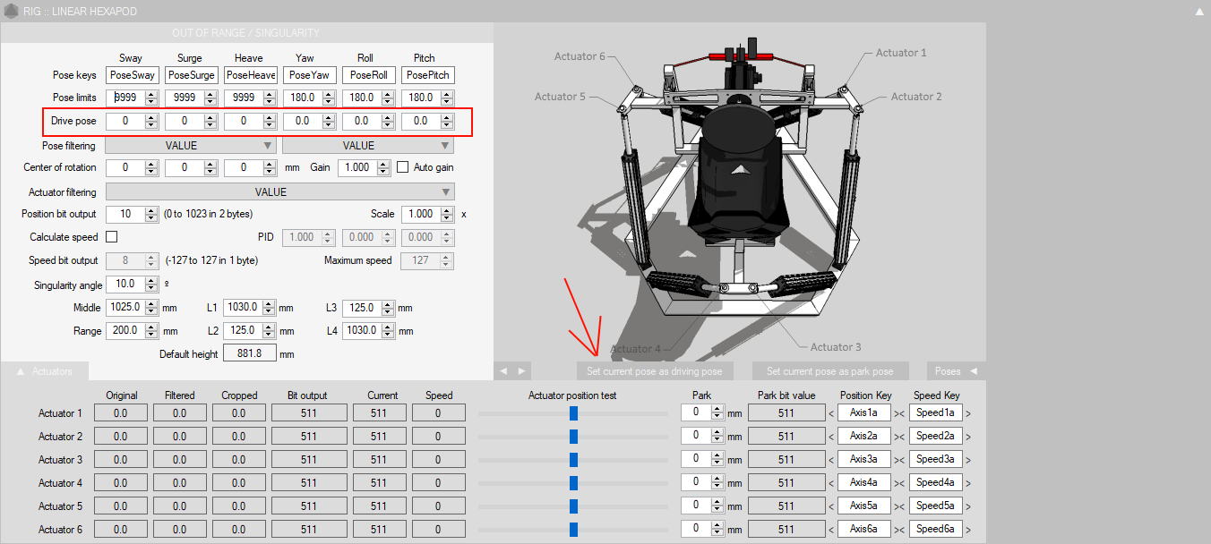

    Hi again !:blush

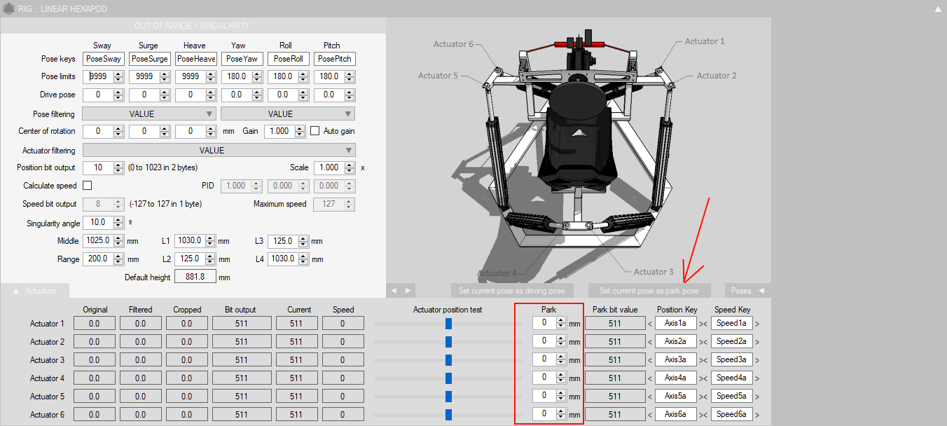

    when you get on in your simulator (low position), you active your outputs and your rig goes in middle position with you. But when you quit the simulator, you cannot do the reverse due to your weight. For me , what I do before going down, I put Drive pose (Heave) at -300 just before the low limits switch (like 5 cm over) then I desactivate the outputs.
    Question ... do you have another solutions for me or what you do if you don't want to hit hard the low switchs ?
    Thanks again !
  7. pmvcda
    pmvcda aka FlyPT
    Nov 3, 2010
    2,180
    Portugal
    15,393Coins
    +2,601 / 17 / -0
    Yes, in the rig module you can set the drive pose and the park pose.
    Park pose is the pose to where the rig moves when you stop the output.
    You can put the rig in the pretended pose and press the button, or since we limit the pose, making impossible to move to the desired one, you can set the actuators positions for the park pose.
    Drive pose is the middle position.
    That one, you set by pressing the button in the pose you want or changing the values manually:
    This is the new version, but I think you can do it already on the current version you have.

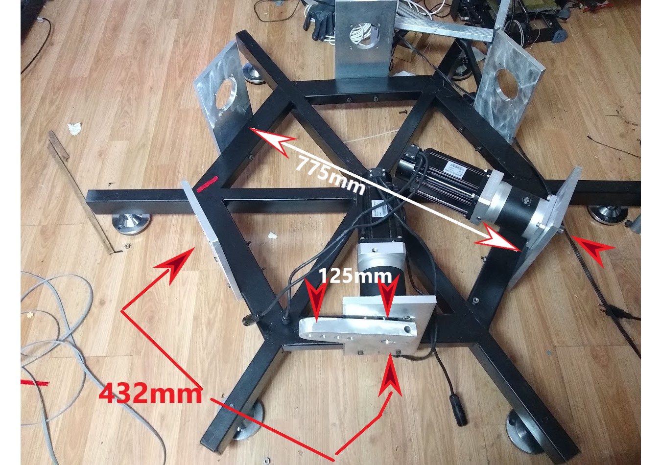

    I hope this is not out of place. I am building a 6 dof rotary. I have built the base and I am trying to figure out the best dimensions for the upper platform. I will most likely use 600mm rods.. I have the latest Mover software installed. Is there a design "helper" to figure out the best dimensions to avoid crashes while maintaining good movement? Or is it just not very critical. Just need some pointers..:o:

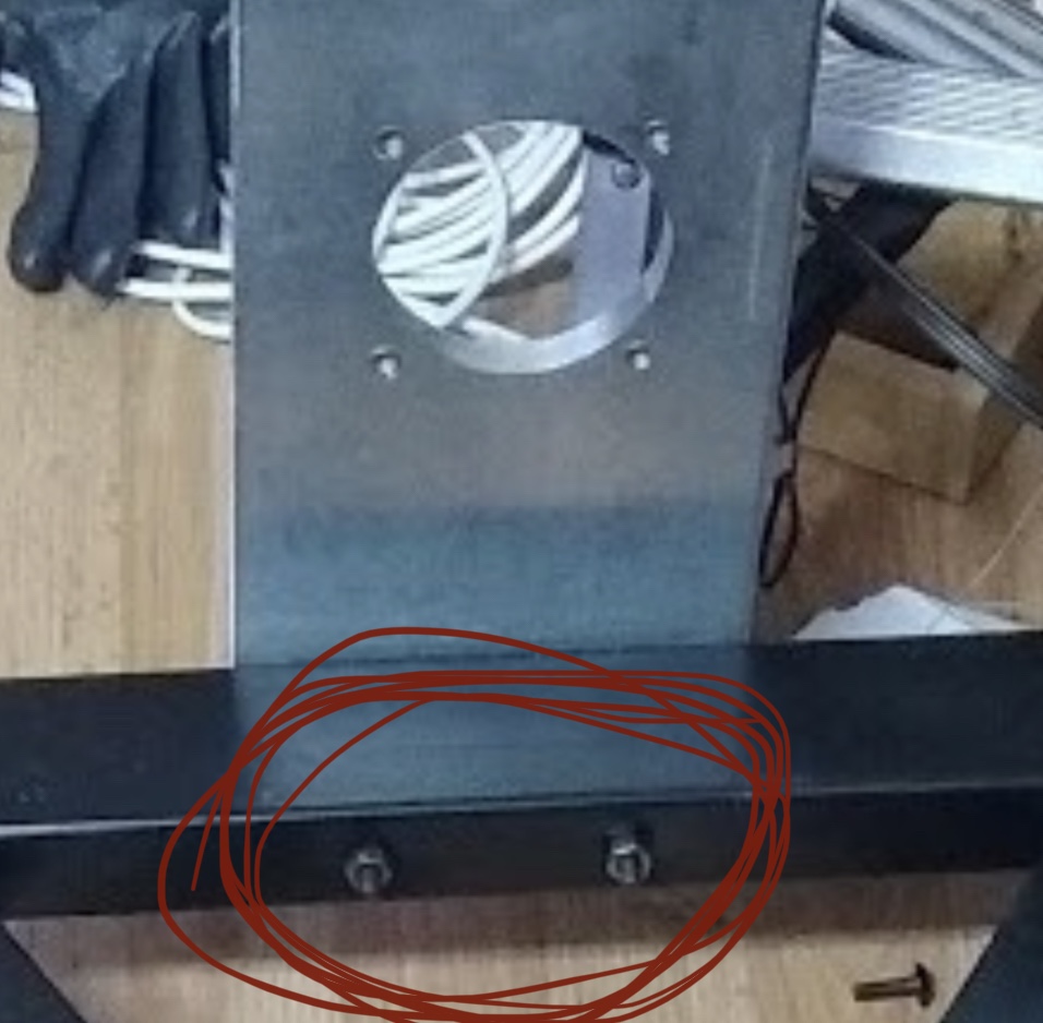

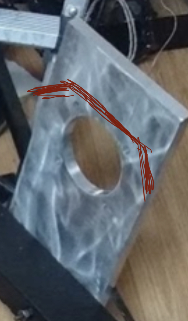

    There is a risk, your legs will collide with the plates. I would reduce the size.
    Also I advise to fix the gearbox to the frame vertically. The attachment of your plates could have rigidity issues

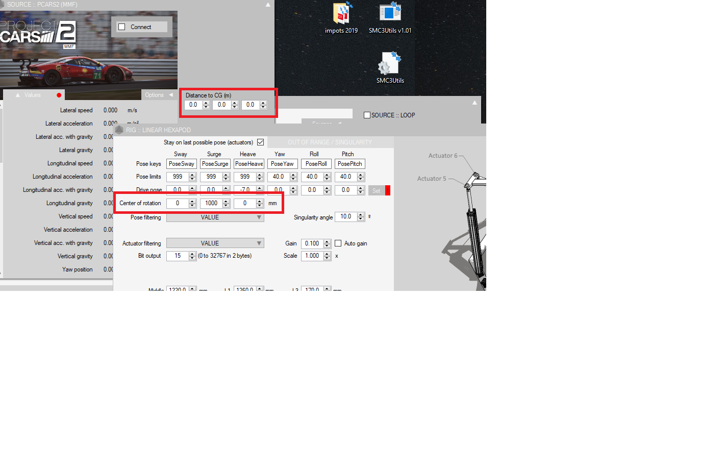

    Hi , @pmvcda
    I would like to know which difference between those two things ( Distance to CG and Center rotation )!
    Thanks !
  18. pmvcda
    pmvcda aka FlyPT
    Nov 3, 2010
    2,180
    Portugal
    15,393Coins
    +2,601 / 17 / -0
    The objective is the same, I would use the cor for small distances, like under 50cm.
    The source distance for larger distances.
    It's the case for air crafts where you can be 15 or more meters ahead of the cg.
    When you use the source one, the accelerations are adjusted for it and include centrifugal and tangential accelerations corrections. So all the filters used in the pose are made taking it into account, while in the cor, you have no idea of the scale of the corrected forces.
    The result is there also, but no way to use the filters.
    Also, the distance depends on the vehicle, and that info might be available in some sources, so it's automatically adjusted in some sources.
    You can use both at the same time also. In the cor you adjust the center to your neck (recommended by some), since it depends on the rig, but be aware, that not all rigs can have the cor adjusted in all directions.
    I'm not good at explaining it. Hope you understand what I mean.

    I understand it this way :
    While “center or rotation” concerns YOUR position on the rig, the “center of rotation displacement” concerns the VIRTUAL center of rotation in the game.
    For me “center of rotation” makes sense if you have a “sinked cockpit” or if due to mass distribution you belly is not exactly above the hexapod center on the longitudinal axis.
    “CoR Displacement” function adds a nice math with slight centrifugal forces on translations.

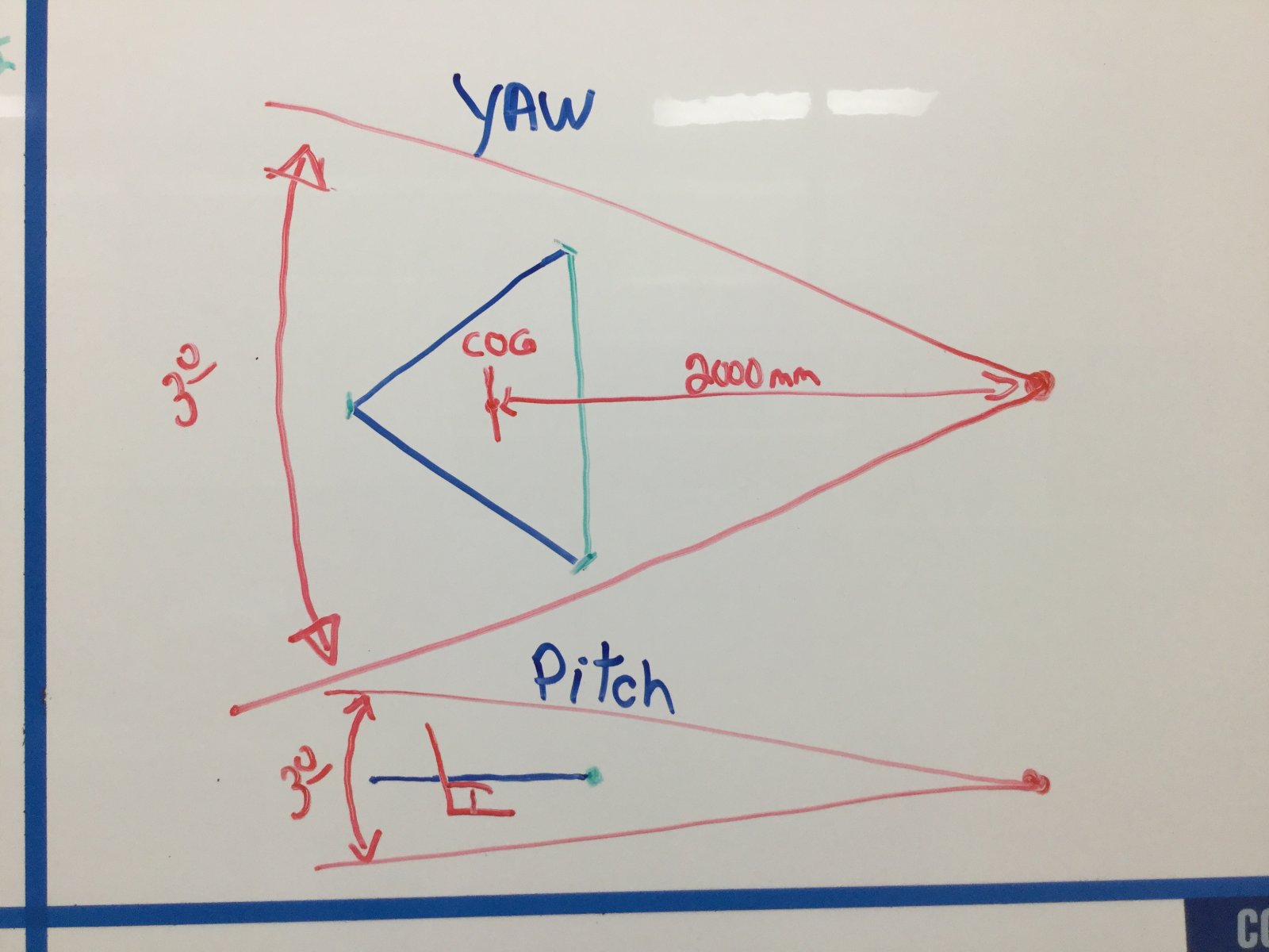

  20. Flymen
    May 19, 2018
    337
    Montreal, Canada
    2,431Coins
    +191 / 2 / -0
    DC motor, 6DOF
    Hi ,@pmvcda
    Exemple with Project Car 2 , I like when I put my COR front of my Rig (2000mm)
    And drift each side like a racing car. But when I push on gaz ( mix surge and pitch), I can’t feel the real pitch like a car does ( COR in middle of Rig) .
    Q- Is it possible to do Both movements with two different COG or COR ?
    See pic for exemple !
    Let me tell you , with 2000mm front of my Rig, when I used 3 degree Pitch it was
    Only up and dowm step :grin
