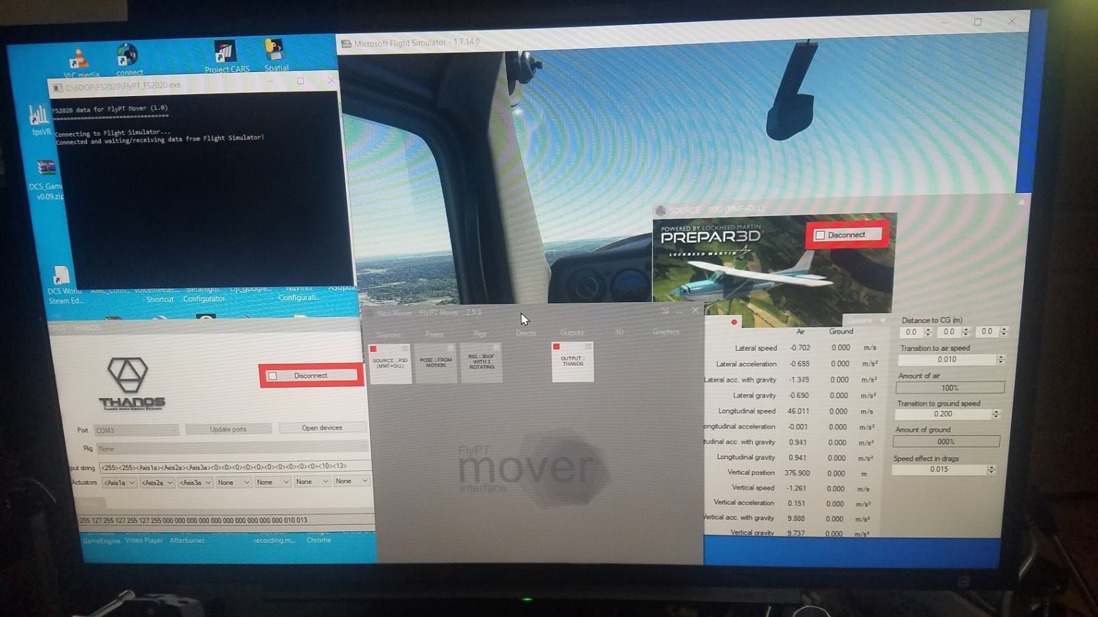

    From the main mover window in the background it looks like you do not have anything set up yet ;)

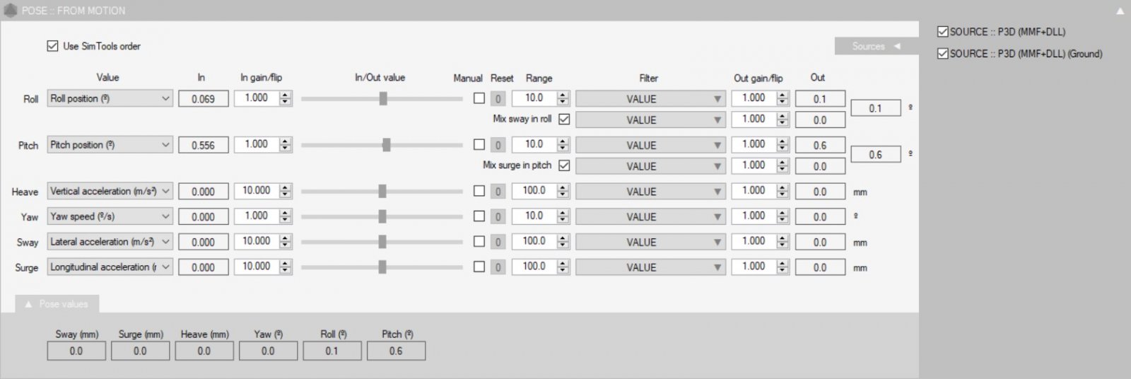

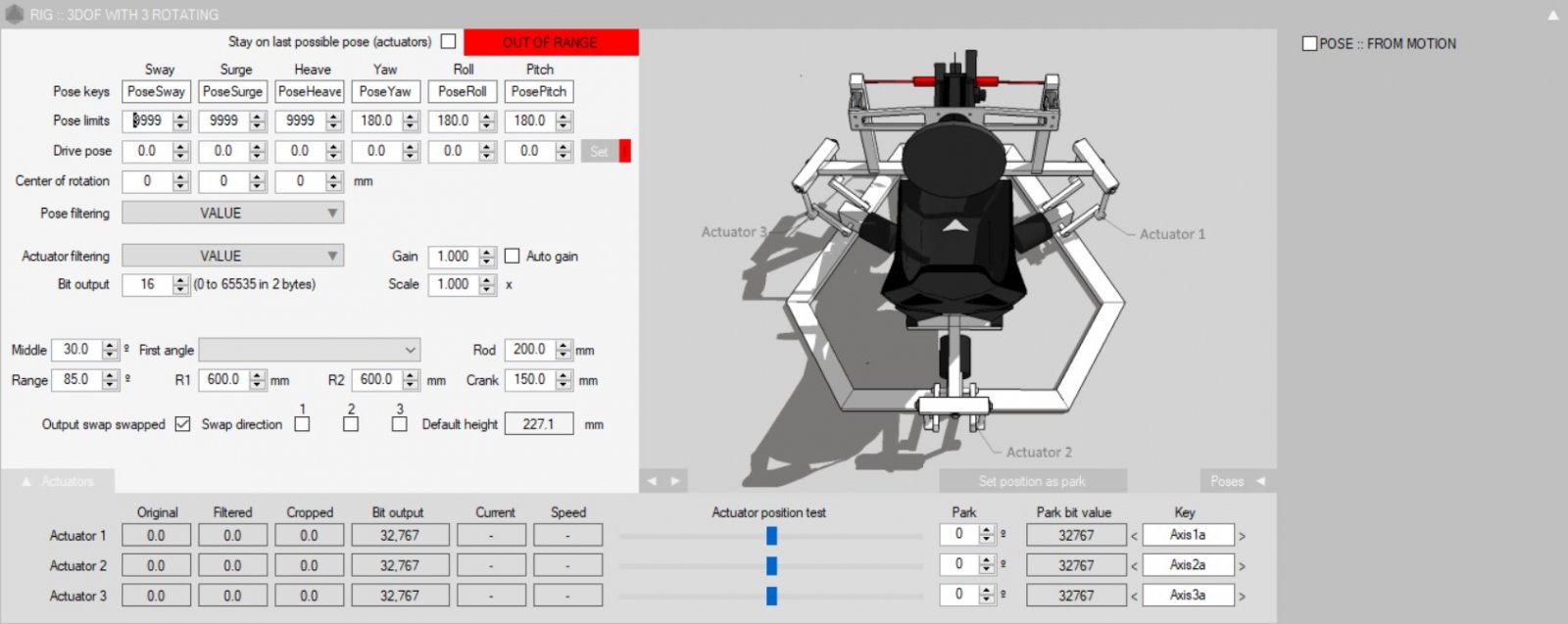

    I am trying... I have plenty of data coming in .. and the Thanos board is seeing a motor connect but I am still not linking it up correctly.. I am close.. But no cigar...

    Can you post the setup file here?

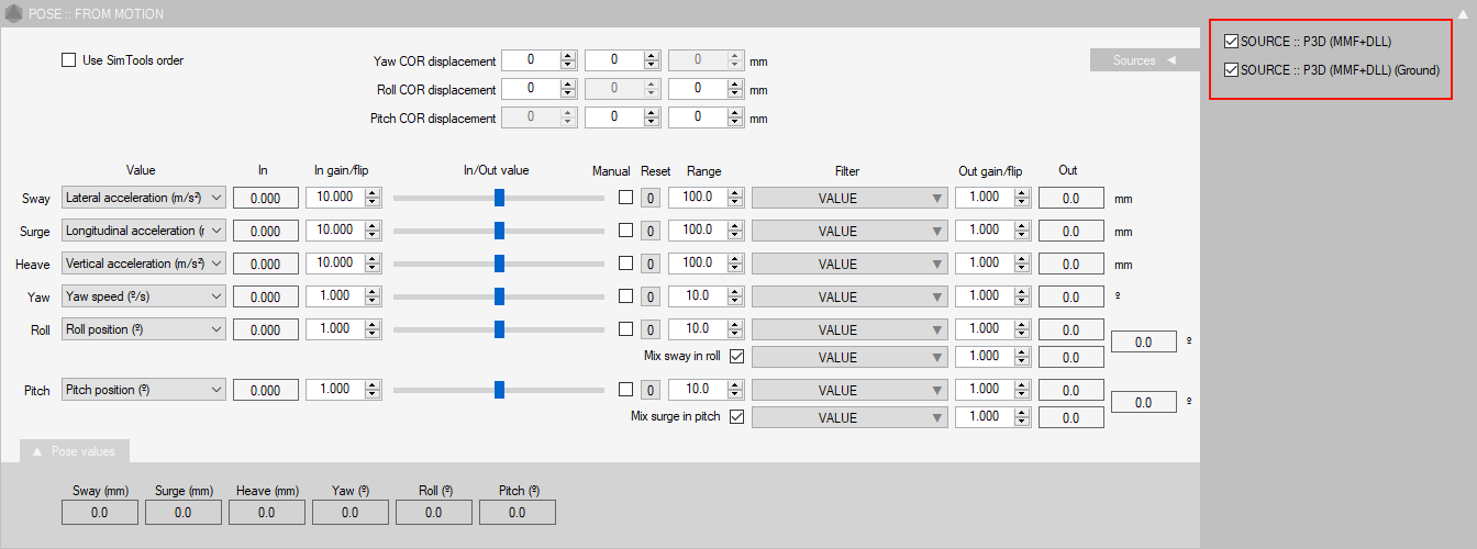

    Did you select the pose to use in the rig module?
    And the source to use in the pose module?

    Is this the info you need?

    In the rig module, on the right, you have to select the pose used by the rig.
    Just check that pose

    Thank you pmvcda that fixed the problem and I now have motion...hug:

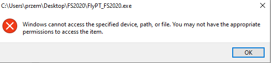

    i get this...

    ok, it's avast antivir. it works again when you change dir name and then quits again. you need to add exception in such case.

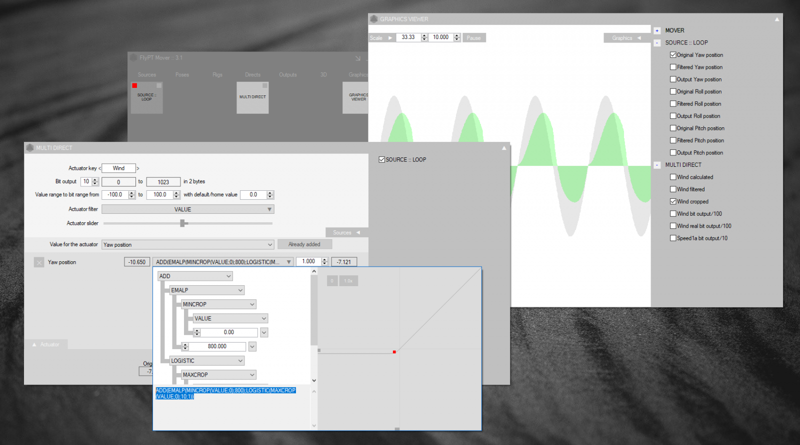

    Hi guys, does anybody know if there is a way to define different values in multidirect for positive and negative numbers? I'm building a gseat and I would like different control based on if a paddle is opening or closing down on the body. I see that I can crop out data but that is not enough control.
    For instance right now the paddles close down as tightly as I would like during acceleration but they don't open enough during deceleration. So I would like to have more gain when surge is negative, but without messing up my positive values. IE a piece wise function. Would be neat to be able to treat positive and negative as completely separate directs. If this was the case then we need a way to sum the directs before they make it to an output.
    Thanks for any clues!

    One way to use one filter for values under zero and another above zero (or other values) is to use a filter like this:
    You add two crops, a mincrop and a maxcrop.
    Now to filter both, you put a filter above the add.
    To filter just the positive, put a filter above the mincrop.
    To filter just the negative, put the filter above the maxcrop.
    In the image, I have a logistic on the maxcrop, so I'm filtering the values under zero with a logistic.
    The values above zero have a emalp filter.
    Something like:
    FILTERALL(ADD(FILTERABOVE(MINCROP);FILTERUNDER(MAXCROP)))
    MINCROP(VALUE;0) means we want just the values above zero.
    MAXCROP(VALUE;0) means we want just the values under zero.

    Ah ha, very cool! Thanks fly you're the man!
