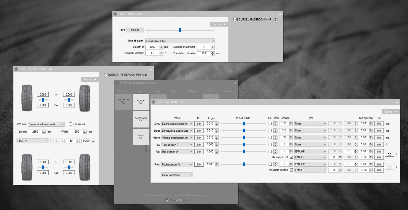

    You can already:
    That's a pose generated from rpm.
    It can be added to the final rig output, like motion or suspension.

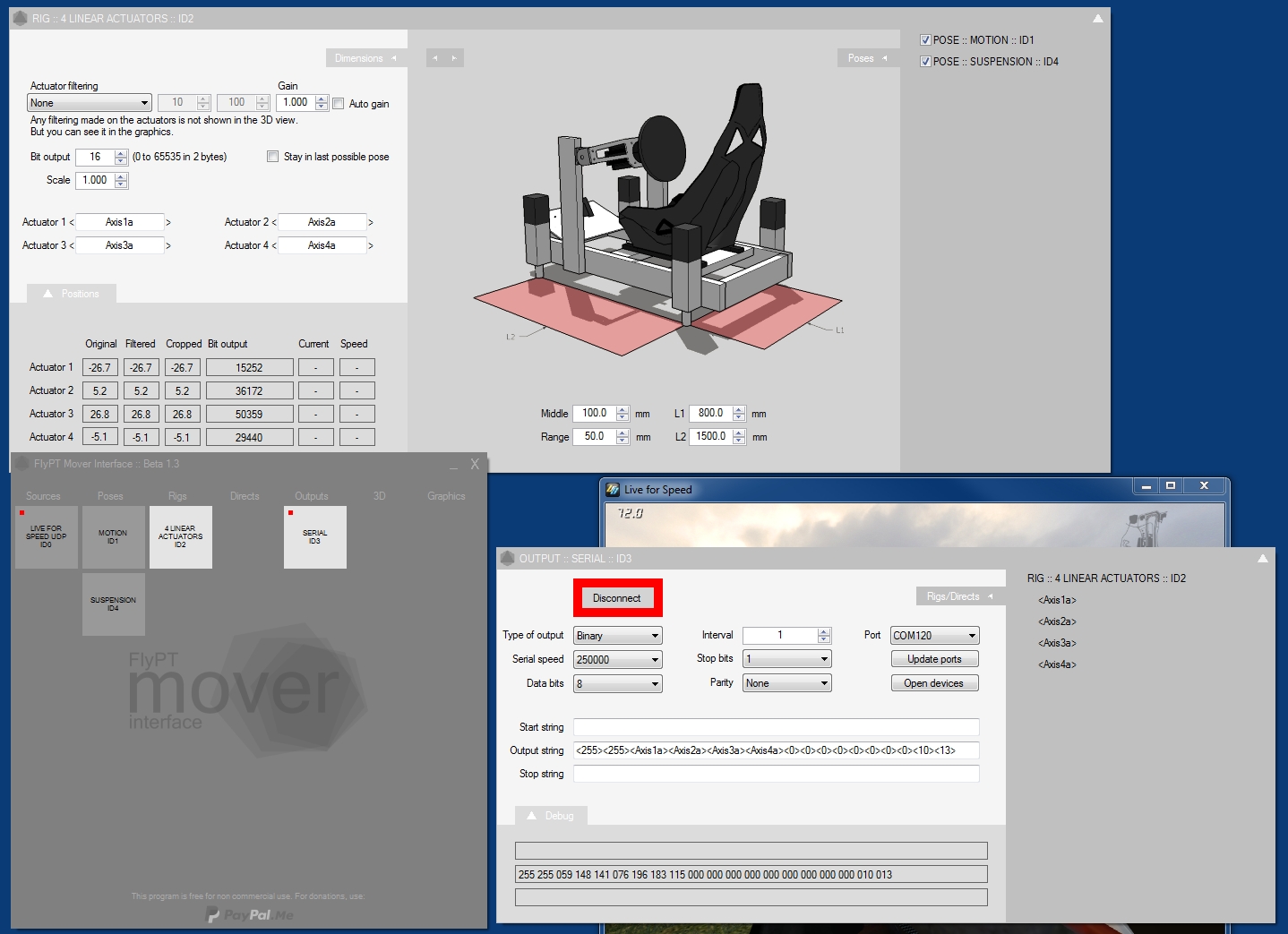

    Ok, I tried but it was missing bytes from the string... Here is the correct string for 16bit values for 4 axis platform (AMC-AASD15A with 4 axis SFX100 actuators):
    <255><255><Axis1a><Axis2a><Axis3a><Axis4a><0><0><0><0><0><0><0><0><10><13>
    The issue is that is the Axis5a and Axis6a are not defined, they transmit as one byte (0) that is wrong. Otherwise for 6DOF platforms the other string above works fine.

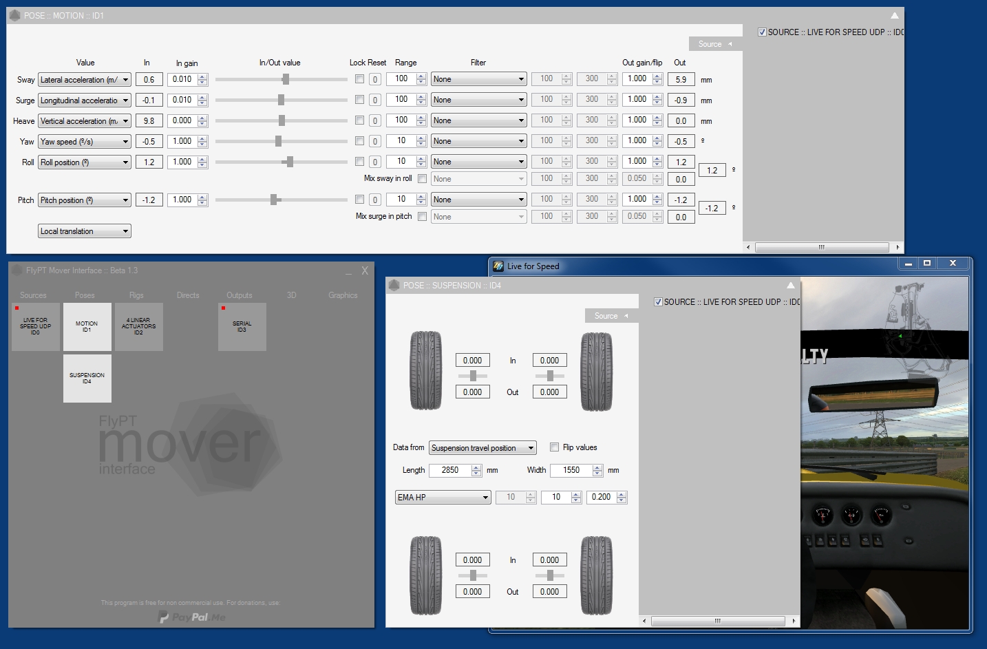

    I had to "Hide" all windows otherwise the output is like steps....
    Of course this is with unfiltered motion data. I should try with some actuator filtering perhaps?
    Also LFS seems that it does not support suspension data.... bummer... I couldn't try that.

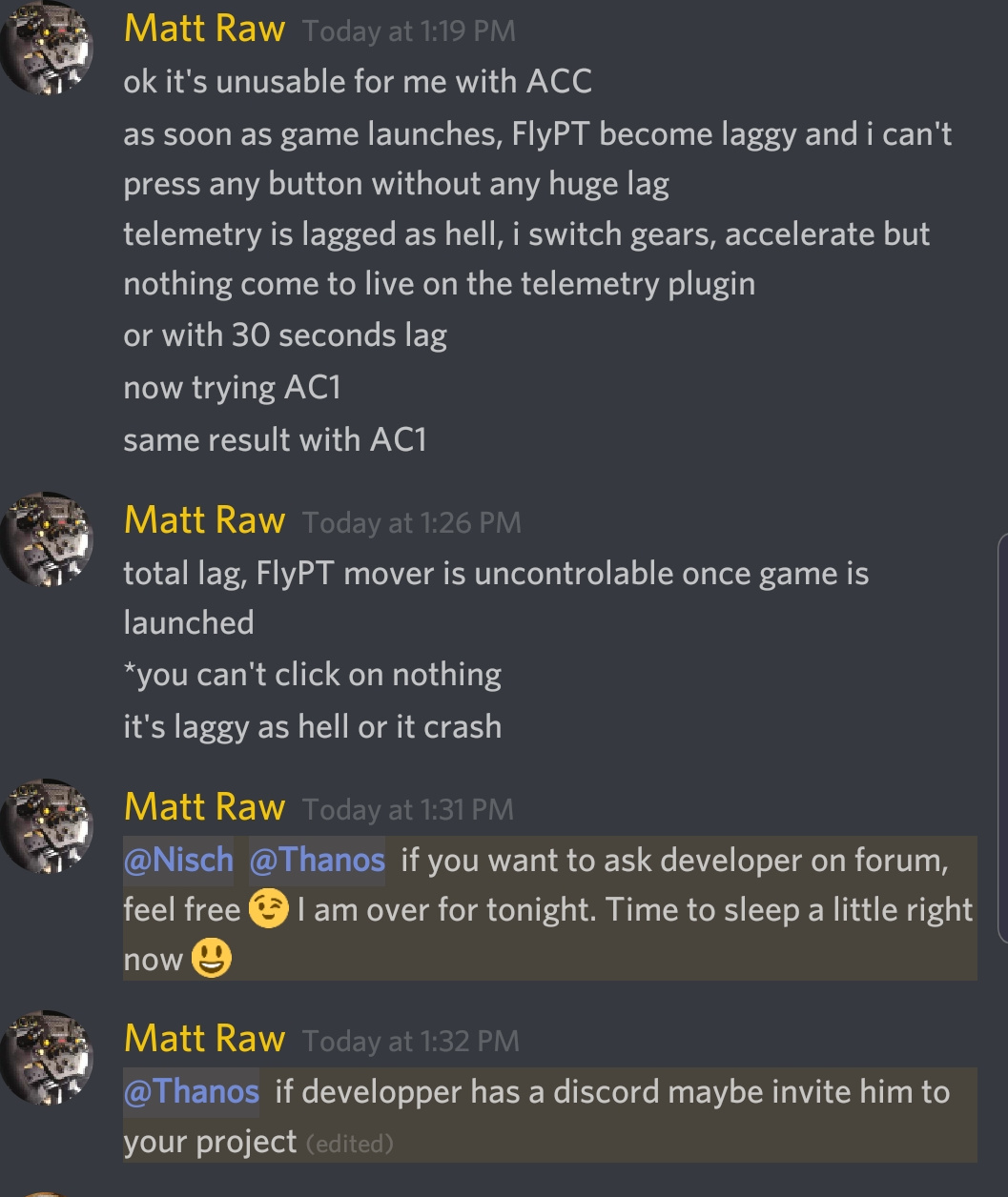

    Hello, i am the one having problem with your FlyPT Software :)
    I made some deeper testing and i finaly narrowed when the problem occurs. I am running a 4 actuators SFX100 setup and everything is working fine with Simfeedback or Simtool.
    I was finaly able to connect to ACC telemetry but with Serial module window closed, and running on virtual 3D viewer. Telemetry is okay, no lag, and rig is moving in the viewer window. But as soon as i turn on the Serial module, FlyPT becomes slow, full of lag, telemetry not moving at all or with 30 seconds delay and it finaly crash. i am not even able to try to connect to the controler because the serial module window is crashed.
    I have tried with controler hooked up or not to the pc and results are the same.
    I am able to connect to the AMC controler and AASD15A drivers and moving the rig with a testing loop. Movements are not fluid but jerky, like with poor resolution.
    I don't know if you can help or point me in the right direction...

    HI Matt,
    Thanks for the feedback.
    I will make some tests and try to find the problem. Should be something simple I hope.
    I have two serials in my rig and did not have any problem...
