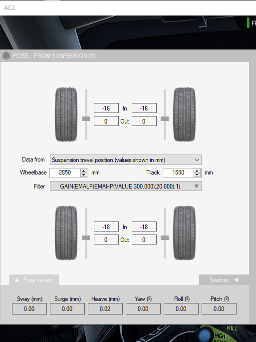

    4DOF

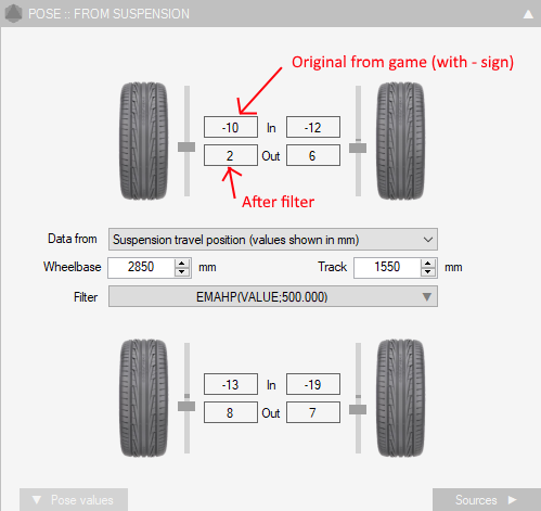

    In version 2.9.9 using the PT rig and AC/ACC as the source, the Suspension pose has the rear suspension all the way to the bottom -96 when AC is running but is centred correctly for ACC.

    AC and ACC send the position of the suspension travel (not speed or acceleration).
    In a soft car, like the old formula Ferrari in AC, we get high values. That's why we should use a high pass filter.
    Those suspensions have lot's of travel.
    ACC with th GT3, has way less travel, so you don't notice it so much. But even so, you should use the EMAHP filter (it's there by default).
    I'm testing and I don't see anything wrong. Was it different in 2.9.8?
    Between the Z3(AC) and M6 GT3(ACC) cars, there's still some difference, but that's the info we get from the game.
    There was a bug already solved, that made the connection to AC and ACC start and stop constantly, the correction is going in the next build. I hope today.

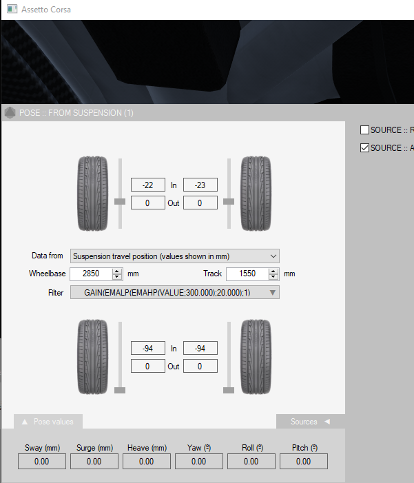

    4DOF
    This is with the vehicle stationary and nothing running.

  7. pmvcda
    pmvcda aka FlyPT
    Nov 3, 2010
    2,183
    Portugal
    15,403Coins
    +2,617 / 17 / -0
    Exactly, what you see is the suspension travel.
    I don't know what is the reference they use. Is zero when the car is at maximum or minimum travel?
    Because zero is not at default travel.

    Well, default depends on weight...
  9. kparkin
    kparkin Member
    Oct 6, 2018
    92
    United Kingdom
    236Coins
    +13 / 0 / -0
    4DOF
    OK with 2.9.8 it's the same in AC doesn't matter what I do with the HP filter.
    This is the Porche 911 GT3.
    With the Ferrari F138 the rear drops to -213

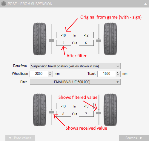

  10. pmvcda
    pmvcda aka FlyPT
    Nov 3, 2010
    2,183
    Portugal
    15,403Coins
    +2,617 / 17 / -0
    @kparkin ,
    Just took a look at the data again.
    Those are the received values, and I'm inverting the signal to minus. So travel=0 is when the suspension is at maximum travel.
    When we lift the car, the suspension goes down. That should be the zero.
    Because with the car stationary, those values seem realistic.
    When you compress the suspension, the value increases (if you ignore the minus sign).
    That would explain why the old AC Ferrari has almost 10 cm default travel.
    If you notice, beside each wheel in the suspension module, you have two values.
    The top one is the value received from the game.
    The lower one is after the filter.
    The hp filter makes it go to zero, and all the variations are made around zero.
    Edit: Values are in mm, and in that picture, I was driving, because if I was stationary, result of filter would be zero

    Just to clarify some more:
    The sliders show both values. The slider button is the received value and the bar behind the filtered value.
    But since the sliders have fixed range of 100 mm up/ 100 mm down, if the values go beyond that value, they become red. It's just a warning to know the value is above what the slider shows

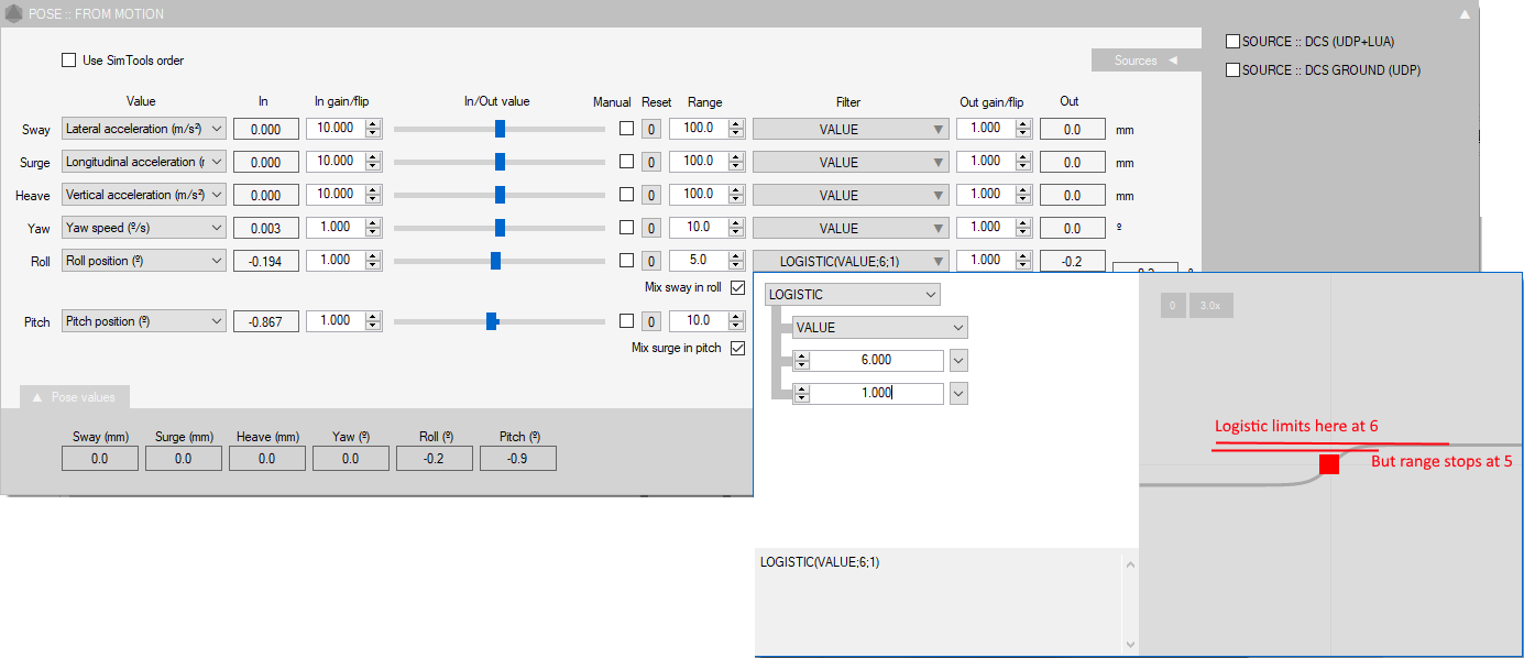

  13. pmvcda
    pmvcda aka FlyPT
    Nov 3, 2010
    2,183
    Portugal
    15,403Coins
    +2,617 / 17 / -0
    @hannibal ,
    This is the setup you sent me in discord:
    Some doubts:
    Do you use both poses in the rig? (we can't see)
    One of the poses uses the air source, and the other? Are you sure you use the ground.
    You have the logistic, so you should have no problem. But I notice something:
    In roll you set range to 5 and use LOGISTIC(VALUE;6;1)
    This means the rig goes only to 5º, but the logistic limits on 6º. This might not be the cause, but you should use the same value in both.
    If it's near the limit of the rig, that can be the reason, becuse you might be activating the limit switch causing that oscilation.
    Well, this is first thoughts, I'm going to test the received data now.
    Just tell me the plane you used.
    Edit:
    If both poses use air, they are going to be added in the rig, and the values become double of what it's supposed.
    Also, the range might disappear in the future from the pose window.
    It causes some confusion.
    Because now, we can limit the rig movement in the rig module

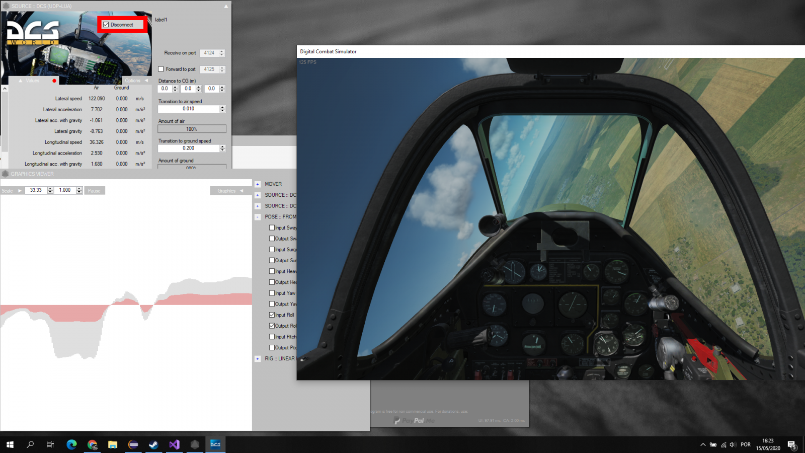

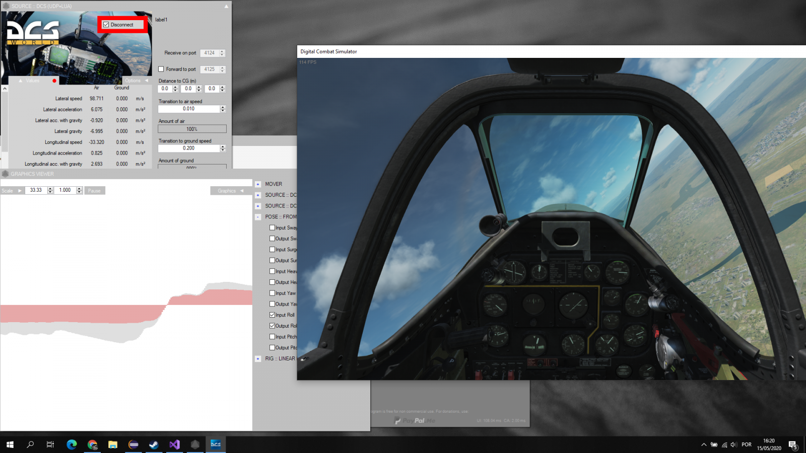

  15. pmvcda
    pmvcda aka FlyPT
    Nov 3, 2010
    2,183
    Portugal
    15,403Coins
    +2,617 / 17 / -0
    @hannibal
    I used a logistic with 45º just for testing.
    You can see in the graphic:
    Gray, the original value
    Red After the filter
    It's smooth, no oscillations, it follows the original, but smooth limited to the 45º
    Just a side note, if the discrepancy between the limit and the maximum value we receive is to big, you can use a logistic(VALUE;max;0.5)
    Use 0.5 instead of 1.0, and it gives you a gain.
    It means the output is not going to increase so fast and when values are above limit, you still get movement on the variations.
    Hope you understand what I mean.
    The bellow graph increase is slower relative to the above one, and we still get variation with values above range. It works like a gain of 0.5, but with a soft limit.
