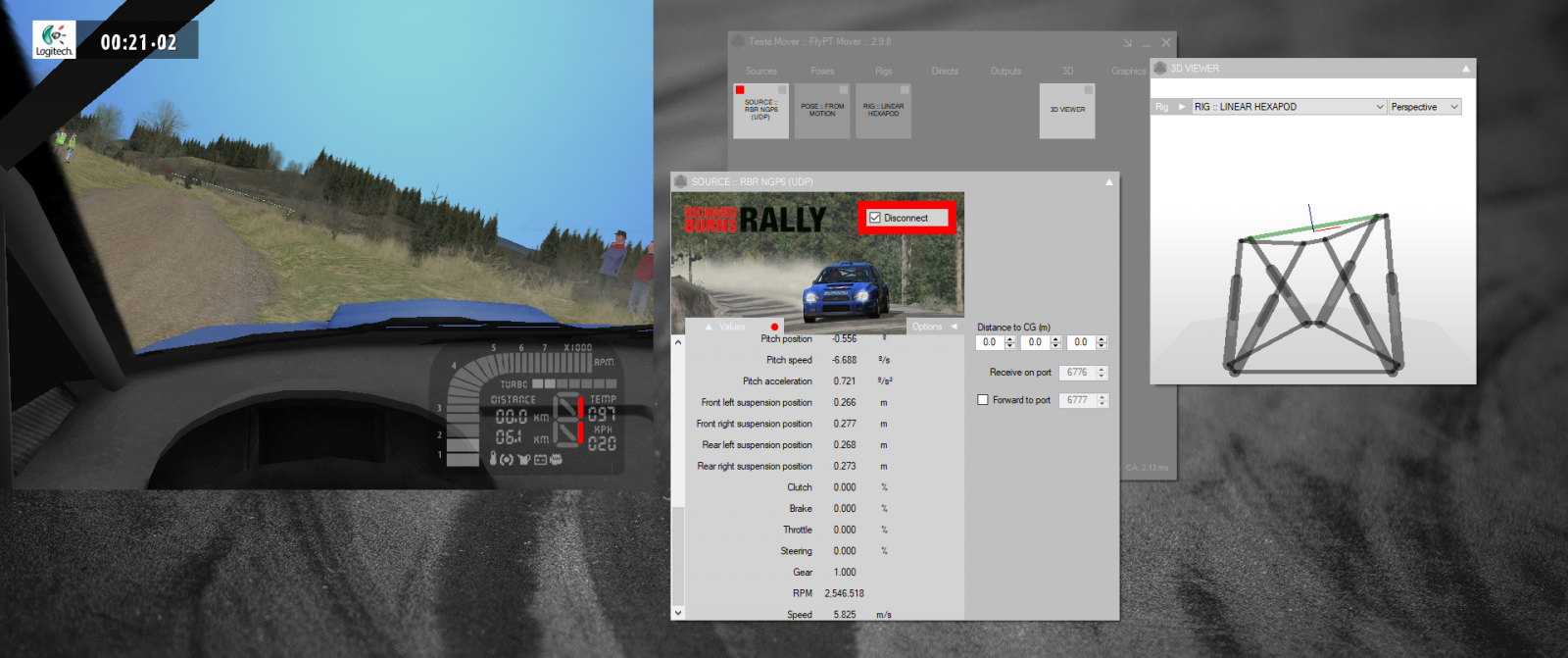

  7. OneDadz
    OneDadz New Member
    Feb 24, 2020
    12
    87Coins
    Hi FlyPT,
    I got a feedback from WorkerBee for RSRBR, he said to me:
    "No hooks required, RBR has a UDP telemetry interface.
    See readme of NGP plugin."
    Hoping to help you."
    Good luck: D
    NGP RSRBR

    @OneDadz , in the next build:
    Already working. Seems good.
  13. OneDadz
    OneDadz New Member
    Feb 24, 2020
    12
    87Coins
    Awesome!
    This will make people happy :)

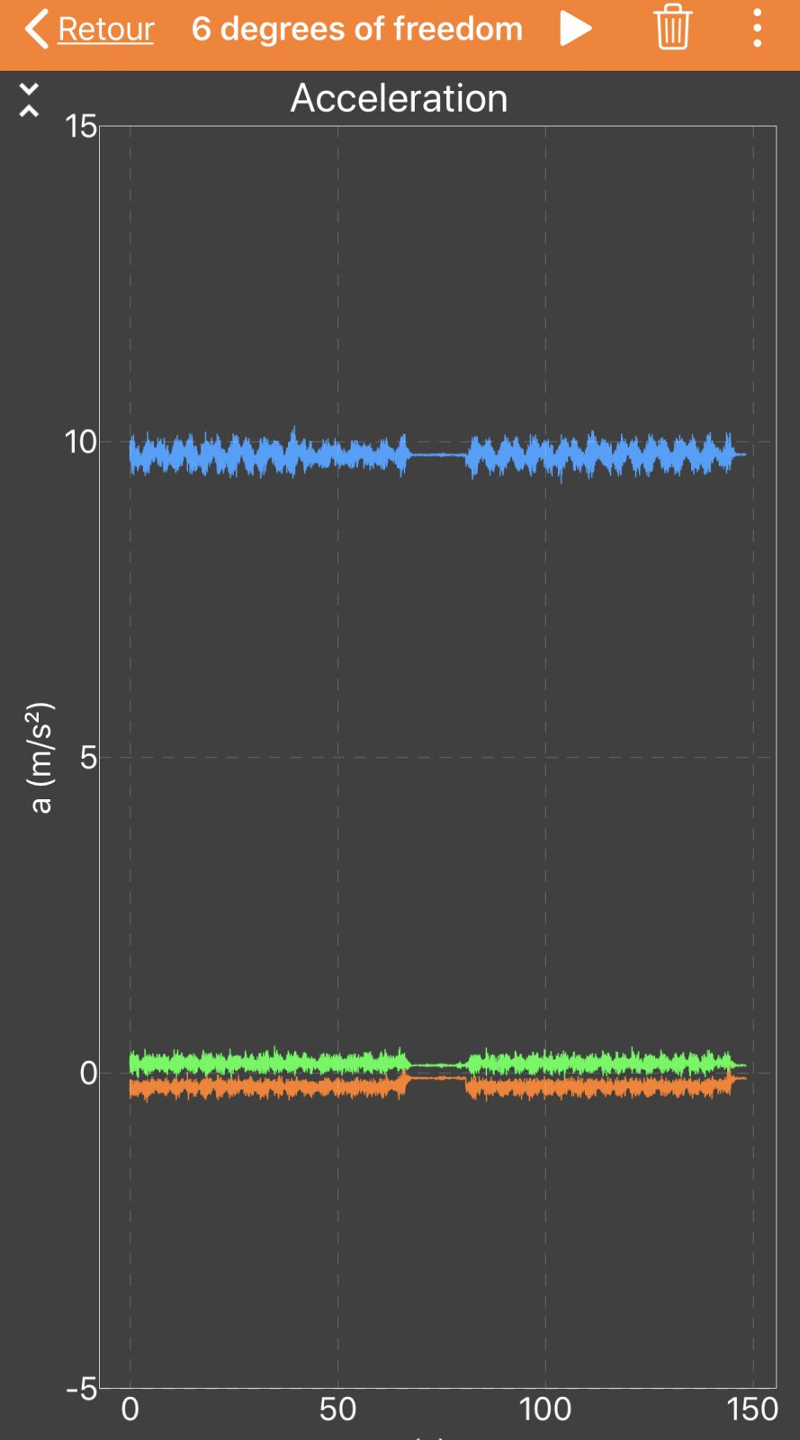

  19. Gabor Pittner
    Gabor Pittner Active Member
    Oct 25, 2018
    203
    Szekesfehervar Hungary
    1,395Coins
    +89 / 0 / -0
    I made some test with it, thank you once again, it feels very very good and realistic. (I would say Its good for warbird too in gain 100%)
    However unfortunately the small and slow movements are not smooth enough because of my actuators. Especialy cause heave is always working, its realistic and feels good, but now it feels like a grinder :rolleyes:
    I tried different PID values, but I lost some movements, especially in car racing. (I hope with the new ESP32 code with PID control will be the solution. :roll)
    Do you have an idea how I can wash out those small movements? Without lose much movements.
  20. hexpod
    hexpod http://heXpod.xyz
    Apr 18, 2016
    1,207
    berlin
    7,770Coins
    +375 / 5 / -0
    DC motor, 6DOF
    This is the phyphox response of a heave sine loop In mover. Amplitude 8 period 7000ms. It’s moving the rig 8cm up and down (16cm)
    You see a noise coming from mechanical parts but I would call it smooth. You could do the same experience and compare
    Applying a LPF doesn’t reduce this noise at all. The sine itself is smooth enough.
