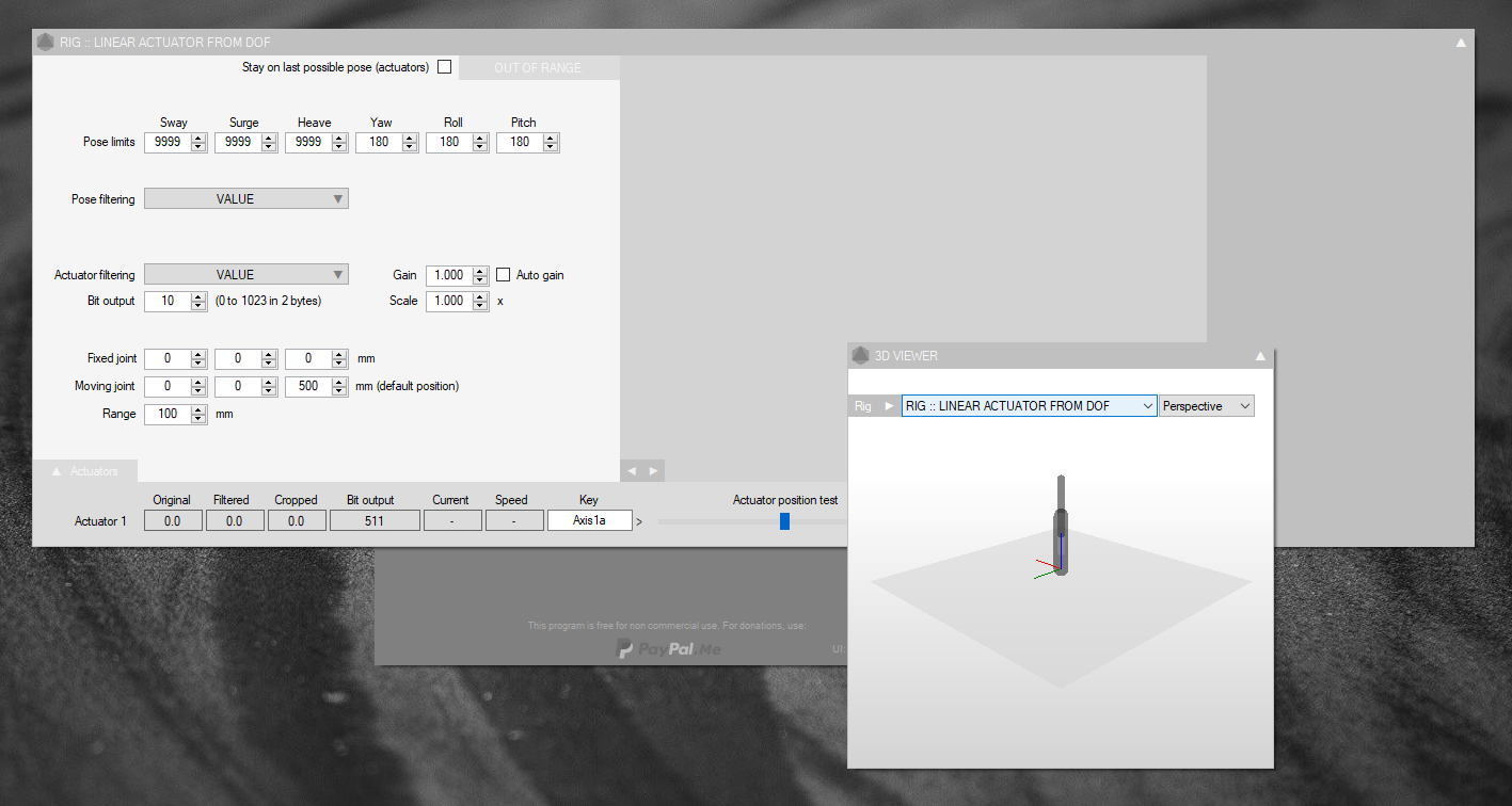

    hi fflypt ,
    first setup and great . I put the 6dof rotating actuators dimensions and first test perfect . No need to use scaling factor to get travel real = travel soft ( Before scaling was 1,971 ).
    my questions /notices :
    1- what are the values into 6dof rotating actuators you ask for pose limits . Is it the comlplete travel ? into setup you mention travel = 2 range . For exemple I setup 85 degres for range that means the travel is 85 x 2 = 170 degres .
    Is the crank arm travel or , fort exemple i won't have pitch = 30 degres .did i put for exemple 30 degres and is is the complete travel or half ? same question for sway , surg , heave .

    For rotating actuators:
    Travel is 2xRange. Range=85 means travel is 170 degrees, between -85 and 85, being 0 the middle.
    You can set the middle angle for example to 20º. that means the rotation goes between -85+20 to 85+20º being 0º the horizontal plane.
    It's a bit confusing...
    Pose is the position and orientation of the top platform.
    When that data reaches the actuators calculation, it can be a sum of multiple poses.
    So I added to the rig a way to limit the pose movements to avoid collisions or be sure the rig works inside a specific envelope.
    If you say sway is limited to 200mm, you are saying sway works only inside -200 to 200.
    Actuators are not limited by it directly, but they wont move to a position that requires less than -200 or more than 200 of sway.
    Again, pose defines orientation and position of the platform and actuators are calculated to reproduce that pose.
    But! The pose is made relative to the platform. Sway, surge and heave are generated from the rotated platform.
    So if you have the rig with 45º roll, sway is going in that direction, not horizontally.

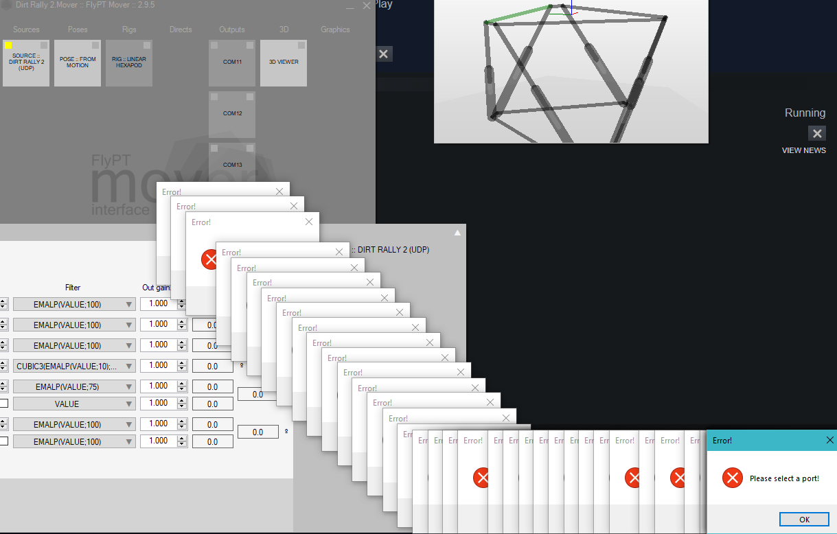

    Just a minor bug report.
    If com port is empty in outputs, then you get this cascade of error messages.
    Easy to overcome at the moment with repetitive presses of the enter key.
    Not a show stopper right now so fix at your leisure.

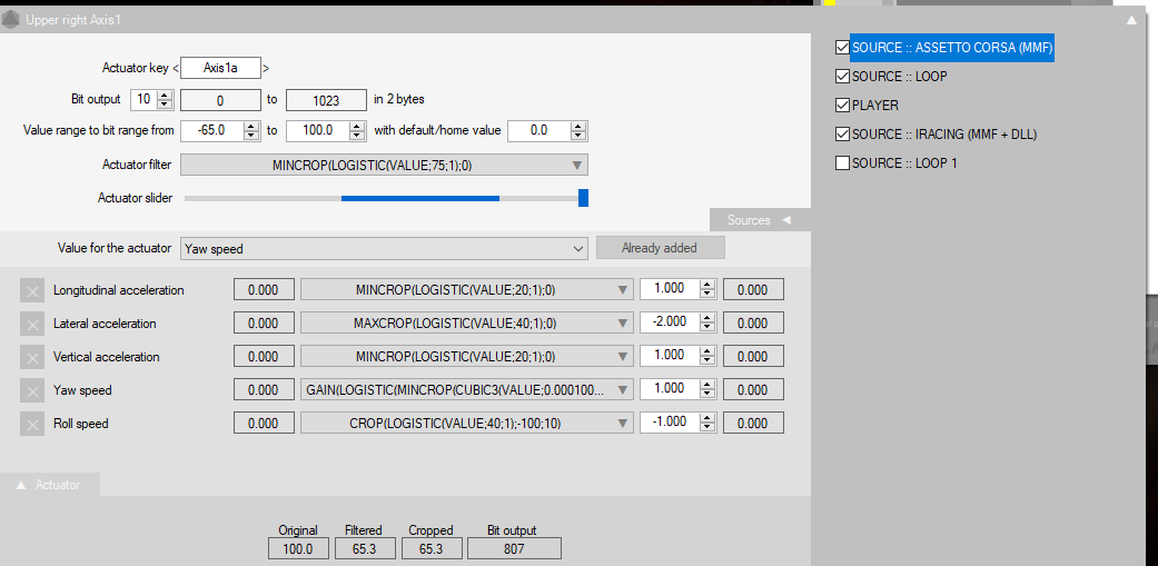

    I have another question.
    I wish to have my center point at 380 bit output and my max at 800. Now what ive done to get the center point is to add a -60 (ignore the pic nr) to 100 on the range. This works to get the center to 380 but the max range is still 1024. I can add a logistic filter at 75 to get it to stop at 800 but as far as i know its no longer linear? I'm mostly assuming this is the way to do it but is there another way of limiting (you can calculate logistics for 80% on the dofs of course) the range?

    @Trigen,
    Did you try the remap filter, to displace the values and scale them. Might solve the issue.
