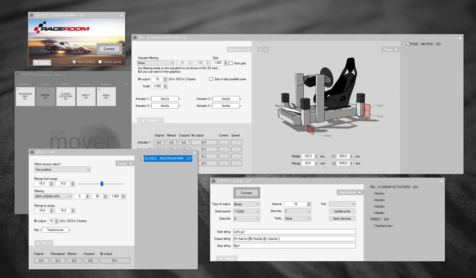

    - New rig type.
    I want to add more, but I wanted this one to be the first:
    It's a kind of rig that can also benefit from the motion cuing.
    I know, there's no traction loss. But you can add it with a direct module to control that actuator as a workaround:
    And a video with the rig in action (not the real one, I don't have one...):
    Keyboard driving and my laptop at his knees... Sorry for video quality.

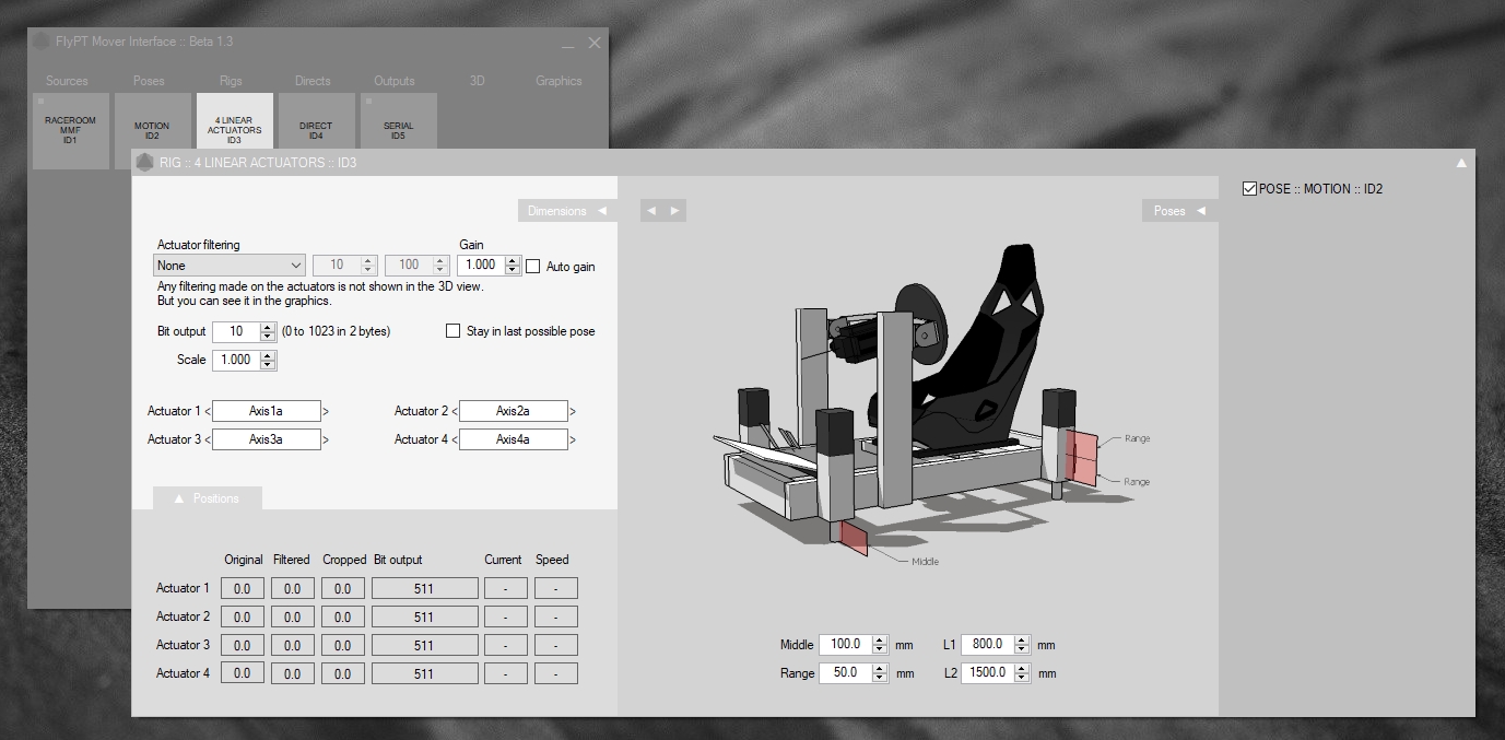

    Motion platform, 6DOF
    Once I changed the Interval to 2 and the serial speed to 250000 and the Rig bit output to 16, I was able to connect and get some loop testing going.
    That feature alone helped a ton with tuning my servos.

    Hi ,
    Ok tested in the 1.3 release and it’s ok .
    Mix pitch in surge OK
    Mix roll in sway KO , the rig doesn’t tilt correctly ( the opposite) .
    I checked in the Flypt hexpod interface and to get it working i had checked for mix roll in sway the checkbox flip. For the pitch in surge only the checkbox to activate the feature .
    In this new interface i didn’t find the flip checkbox .
    When sway goes from , for exemple , left to right ( right curve , you want that the seat push your body on the left ) , you have to tilt the rig on the left also to increase the pressure on your body left side.

    Yes, there are some that might be swapped.
    I removed the flip to use less memory and have a simpler interface.
    To flip, use negative gain.

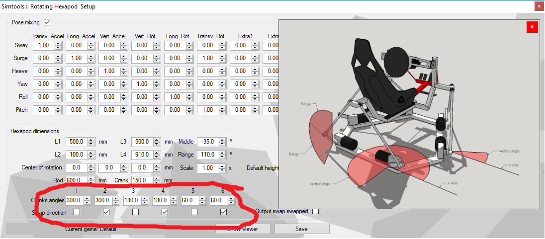

    @pmvcda Regarding the Rotating Hexapod plugin for Simtools packaged with this:
    If I close out of Game Engine, I lose my crank angles and have to redo them every time I load into Simtools. It also appears I sometimes lose my rig dimensions in that plugin, but that has been sporadic.
    That's the only issue I've run across so far in 1.3
