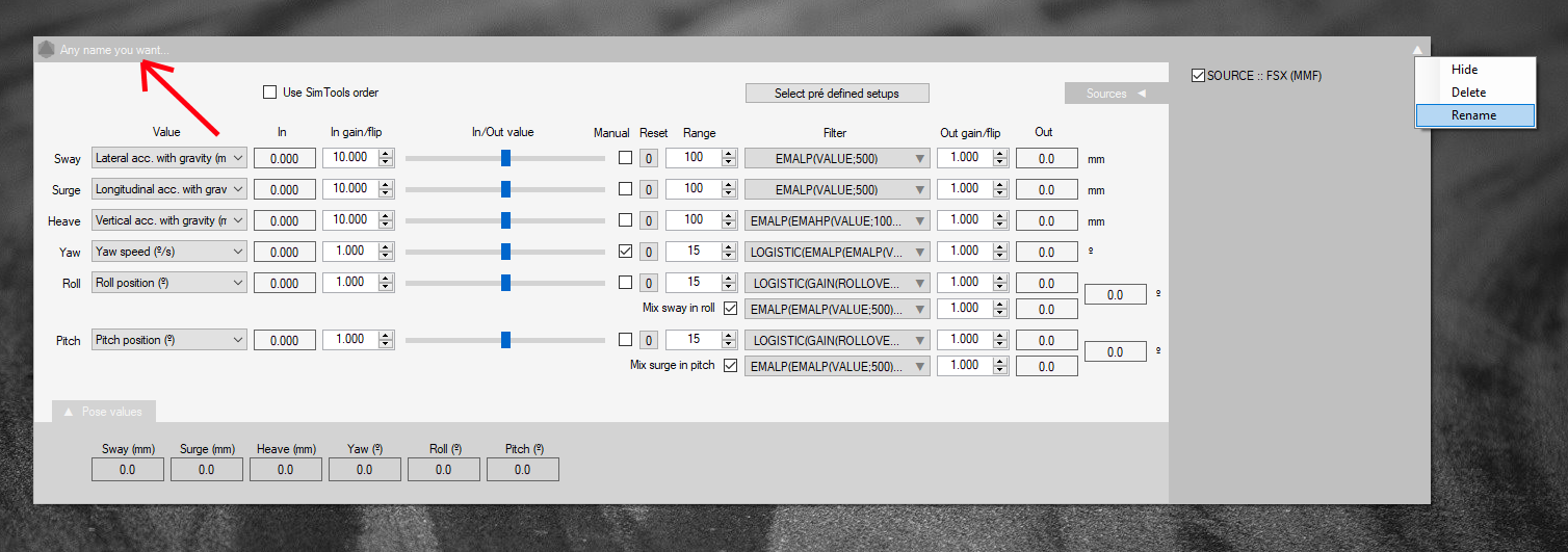

    Now we can rename all the modules:
    Edit: This is not the final pose window!

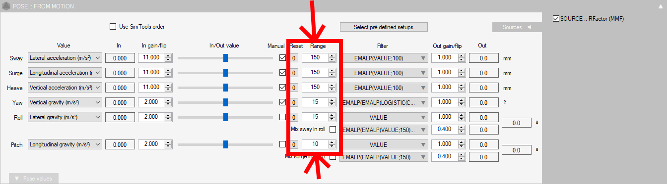

    I see in Mike’s setup the max value 10 for Axis123b and max value 100 for translations coming in the mover.
    1.)
    Small explanation why the Simtools slider 100 % doesn’t show 100 as well for axisb’s ?
    2.)
    Small explanation about the reason why the range is modifying the percentage of response ? See picture.
    Why not having the same scale for all dofs AND the range which doesn’t affects the scaling but only the range ?

    Simtools puts data in 18 values we have available in the drop downs.
    It fills all the axis a and b with values between -10 and 10
    It also fills those values:
    Lateral acceleration from -100 to 100 (kind of %) -> The value of Axis1a but in another range
    Longitudinal acceleration -100 to 100-> The value of Axis2a but in another range
    Vertical acceleration -100 to 100-> The value of Axis3a but in another range
    Yaw position -180 to 180 (it's an angle)-> The value of Axis4a but in another range
    Roll position -180 to 180-> The value of Axis5a but in another range
    Pitch position -180 to 180-> The value of Axis6a but in another range
    So if you have Axis1a=5, lateral acceleration is 50
    And so on...
    Might not be the most correct, but when I made it, I wanted to have different scales for testing and I leaved it that way.
    But I can change it all to 100, maybe leave the angles?
    I'm not understanding the ranges. Are you speaking of the Range values in the pose window of Mover?
    If so, they are going to disappear (50% sure). Those ranges are just the limit for the value that goes out of the pose to the rig. Anything above is cropped.
    If you change them, they also change the range of the slider (reason I might leave the ranges here instead of moving them to the rig window, still in doubt)

    That’s something a bit confusing.
    As first I was thinking that the « in-gains » values are factors (1 = 100%). Of course they are not. Thanks for explanation.
    1.)
    It wouldn’t be more simple if we would have everything coming in in percentage ? Than the gains could work as a factor, (0,5 = 50%) right?
    2.)
    The fact you have to compensate the slider response with gains after changing the range is also a bit confusing.
    Ex. I increase the range limitation of my heave from 100 to 150. In order to fulfill the axis I have to put the « in gain » at 1.5
    My question is: do we need this additional step ?
    Axis Range limitation is a part of geometry, it make sense to put it in there where you define the rig IMO.
    Best.

    « Those ranges are just the limit for the value that goes out of the pose to the rig. (...)
    If you change them, they also change the range of the slider«
    Yes and no ;-) if you take the slider manually you can indeed use the increased or decreased range with the slider BUT in game mode, if you for ex. reduce your « range limit », the signal will not auto-adapt, you will have to reduce the in-gain to avoid the axis clipping.
    Edit:
    Ex: in the scenario when you link mover with Simtools, in order to have your heave axis fulfilled, (gain 1 fulfilling 100mm translational range OR gain 1 = 10deg for rotations).
    Each time you change the axis range limit, you have to correct the gain.

    Wait, the in gain is a "percent" of the received value.
    This is the first operation made over the received value.
    After that we apply the filter to the value.
    Next the out gain.
    If the resulting value is outside of the range, the value is cropped to the range.
    In reality it's a filter like that:
    CROP(GAIN(FILTER(GAIN(VALUE;ingain));outgain);range)
    I think the confusion here is that what we receive from Simtools is something between -1 and 1. It's never more than that.
    To generate some movement, I multiplied the values by 100 in translations and 180 in rotations.
    That's why I say that in the tuning center we should use min/max of -100 to 100 and -180 to 180 to match the values received in Mover.
    Now, if I remove the range from the pose window (still in doubt), we just remove the crop.
    I'm going to keep the gains, but it's just to simplify the filter definition, because we can write them in the filter, just like we can write the crop if we want to.

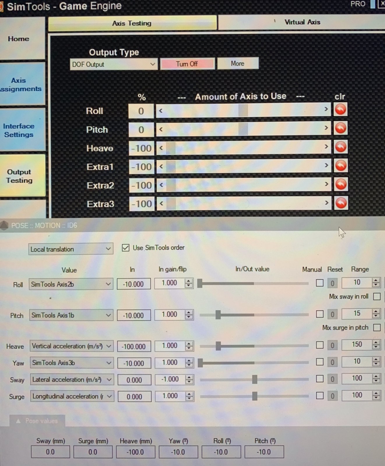

    Ok, but Mike uses the extras for rotations.
    What’s the value which has to be put for angular velocities (extras) in the Tuning center in this case ???
    I guess the velocities are in deg/s
    I advised to Mike a quiet different approach which was the following:
    Tuning Center -> Filtering -> Out-gains
    1.)
    Leaving the “in gains” at 1 (actually that was a mistake because it works only when the angular AXIS RANGE is 10 and the translational 100)
    As soon as you change the range you have to tune back the “in-gains” in order to get 1:1 response.
    2.)
    Than limit the intensities directly in Tuning center.
    Consider what could be the max values in real life in a 737 (they should be similar in P3D) and set them in the Tuning Center
    I would expect that with 15m/ss for accels (1.5G) and 20deg/s (0,35rad) you will clip your signal only in extreme scenarios.”
    Obviously I created an additional confusion as it seems that several different approaches can be considered to reach similar goal. Apologies.
    I believe yours could be more comprehensive.
    Best
