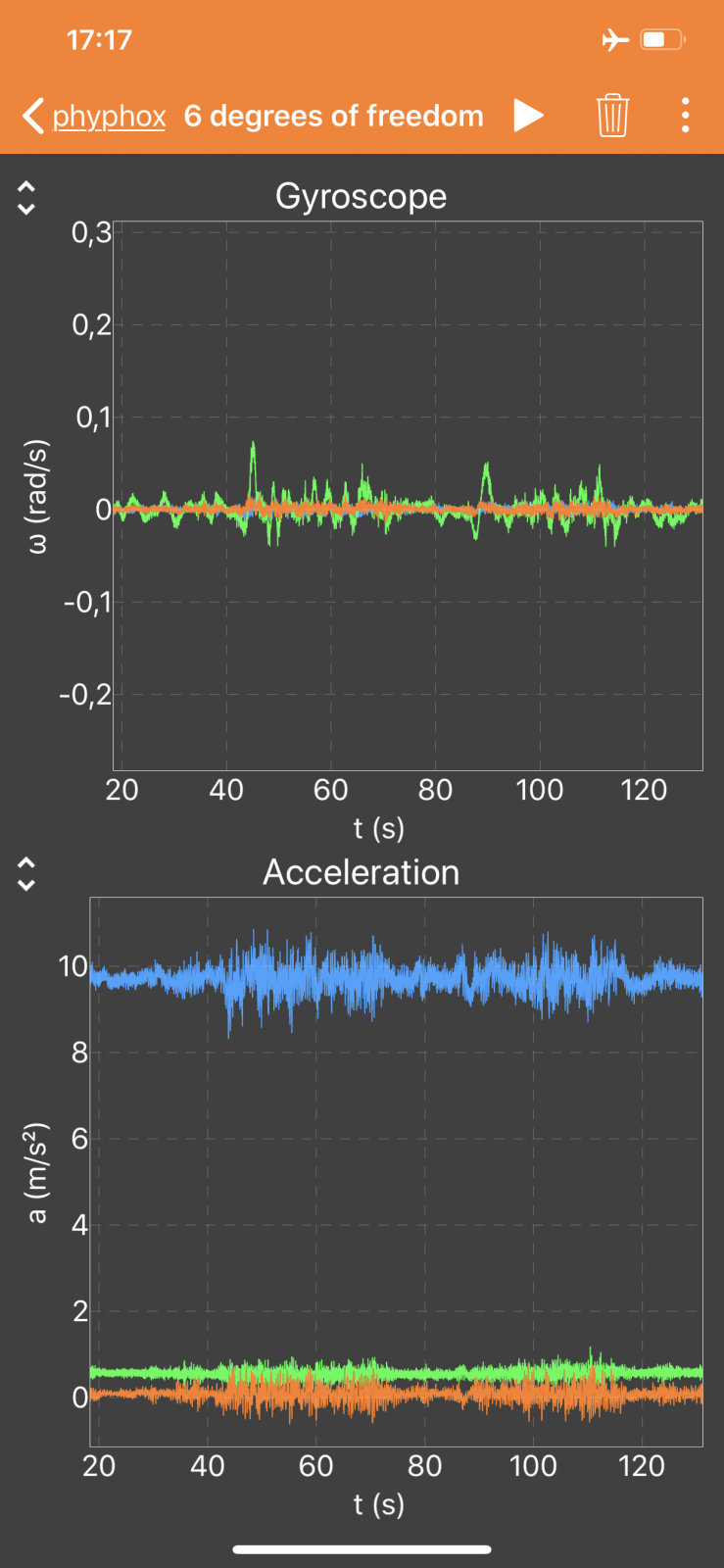

    This is how moderate turbulence can look like. I just recorded it in this beast:

    My experience contains only accelerometer with g and gyro.
    Not sure it will work.
