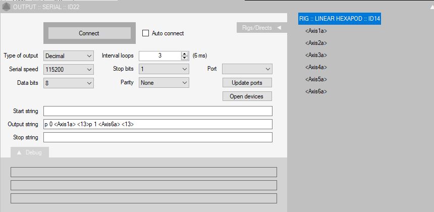

    Hi again @pmvcda
    your serial string for the Odrive works!!!! Many thanks for your great and fast support!
    For documentations reasons here is my screenshot of the output serial window:
    Wickie

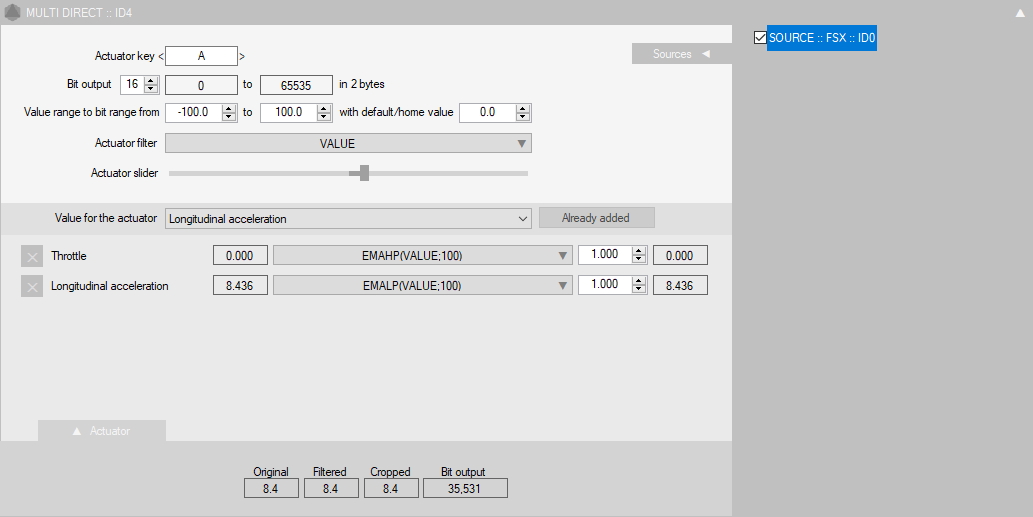

    @pmvcda hopefully in about two months I'm going to be working on setting up a non-standard motion sim, it should be interesting! I have to see what updates you've made so far to rig types. What I'm planning is two parts. First an advanced G-seat running on three motors. One is heave, one is pitch and surge, and one is roll and sway. The whole seat will pitch and roll a bit in addition to the usual G-seat features. Then that whole assembly and my cockpit are going on an "elevator" platform that will go only straight up and down and will have somewhere around 24-36" (600mm to 900mm) of travel, as much as possible without the overhead cockpit panels hitting the ceiling.
    I expect to use just my Thanos AMC1280 AASD-15, three different output channels for the G-seat, and the other three will all be working together to raise and lower the elevator so three channels with the same exact heave only output. Again, if this seems odd it's because I already bought the six servos so I'm using what I have.
    Anyway, it should be interesting to see how we might set this up in FlyPT Mover.

    Just use the direct or multi direct modules.
    With this module, you set the values you want to use for one actuator.
    You can select the filter to use for each value and the result is the sum of the filtered values.
    In the end,you can apply a filter to the actuator.
    The range defines the relation between the actuator travel and the calculated value.
    In the image -100 to 100 means the lower position of the actuator corresponds to a value of -100, while the upper one is 100.
    This is for one actuator. You can add the amount of those modules you want. So for 6 actuators, use 6 modules.
    I want to see that rig working. :thumbs
    EDIT: This module, allows the use of Mover in any rig.Not the use of the motion cuing algorithm. For that you have to wait for the custom rig module.

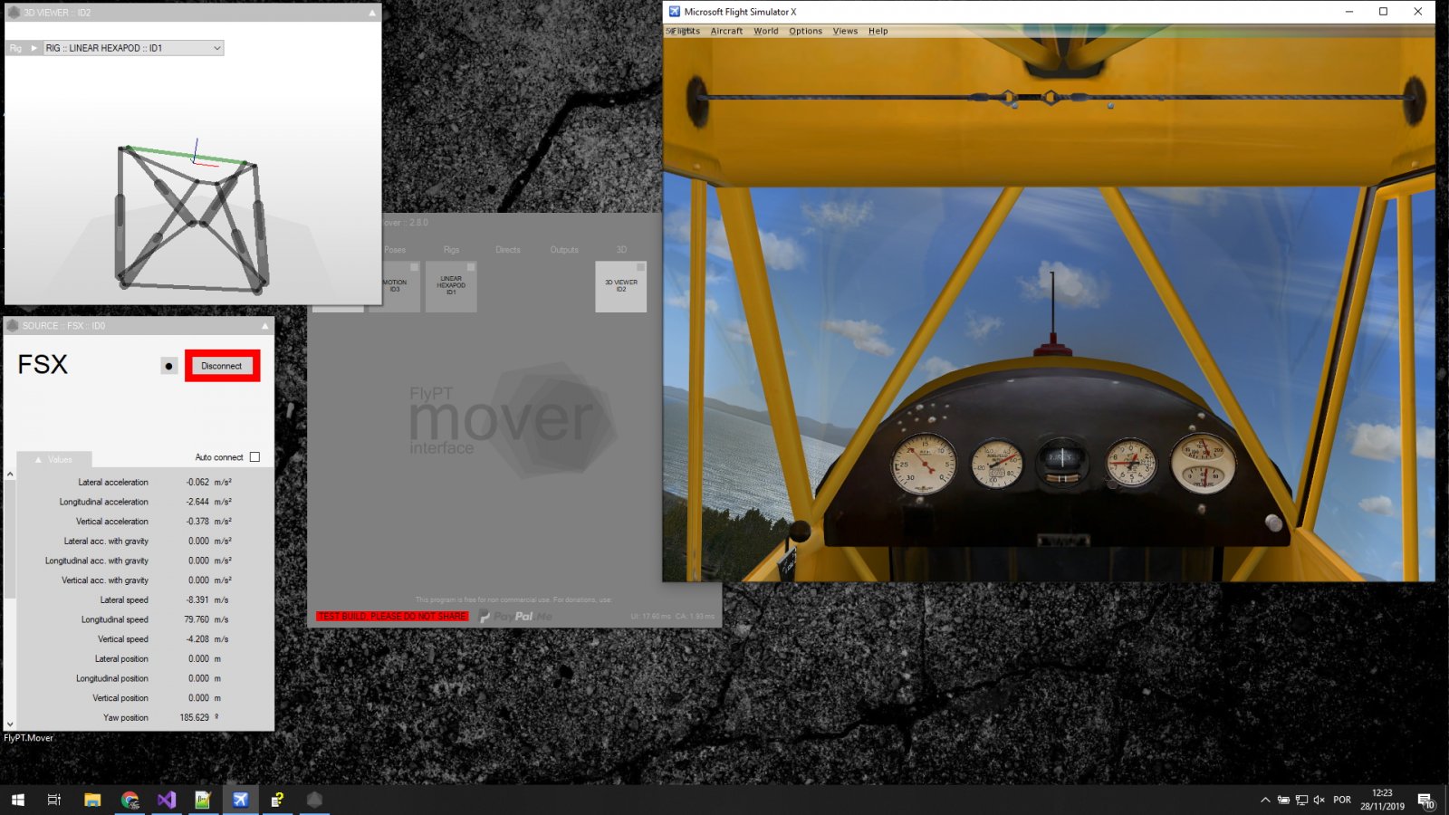

    Next build is almost ready. Not perfect, but comes already with the first implementation for FSX that should be compatible with P3D.
  20. pmvcda
    pmvcda aka FlyPT
    Nov 3, 2010
    2,237
    Portugal
    15,702Coins
    +2,669 / 17 / -0

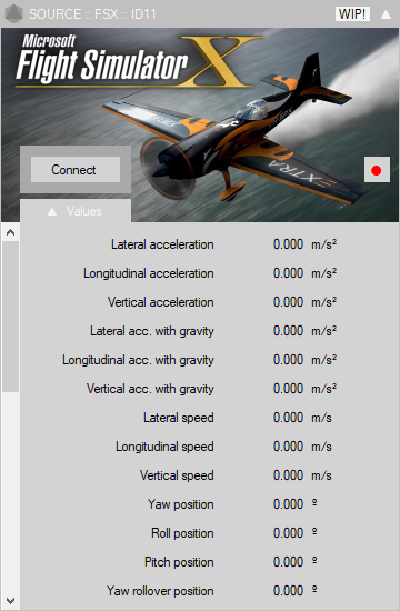

    FlyPT Mover 2.8.0
    New version with:
    -Executable for 64 bits and for 32 bits (please compare).
    -First pass on FSX source (still WIP).
    Port to P3D is easy, but will be done when this one is more stable.
    Works only in the 32 bit version of Mover.
    -We can now record all the received data in the sources.
    Press the square with the red circle in the sources.

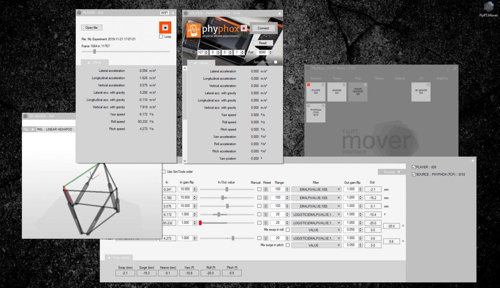

    -To play a PhyPhox file or use the PhyPhox source directly with the phone, use the recommended filters.
    The above setup is available in the samples folder (not the phyphox file).
