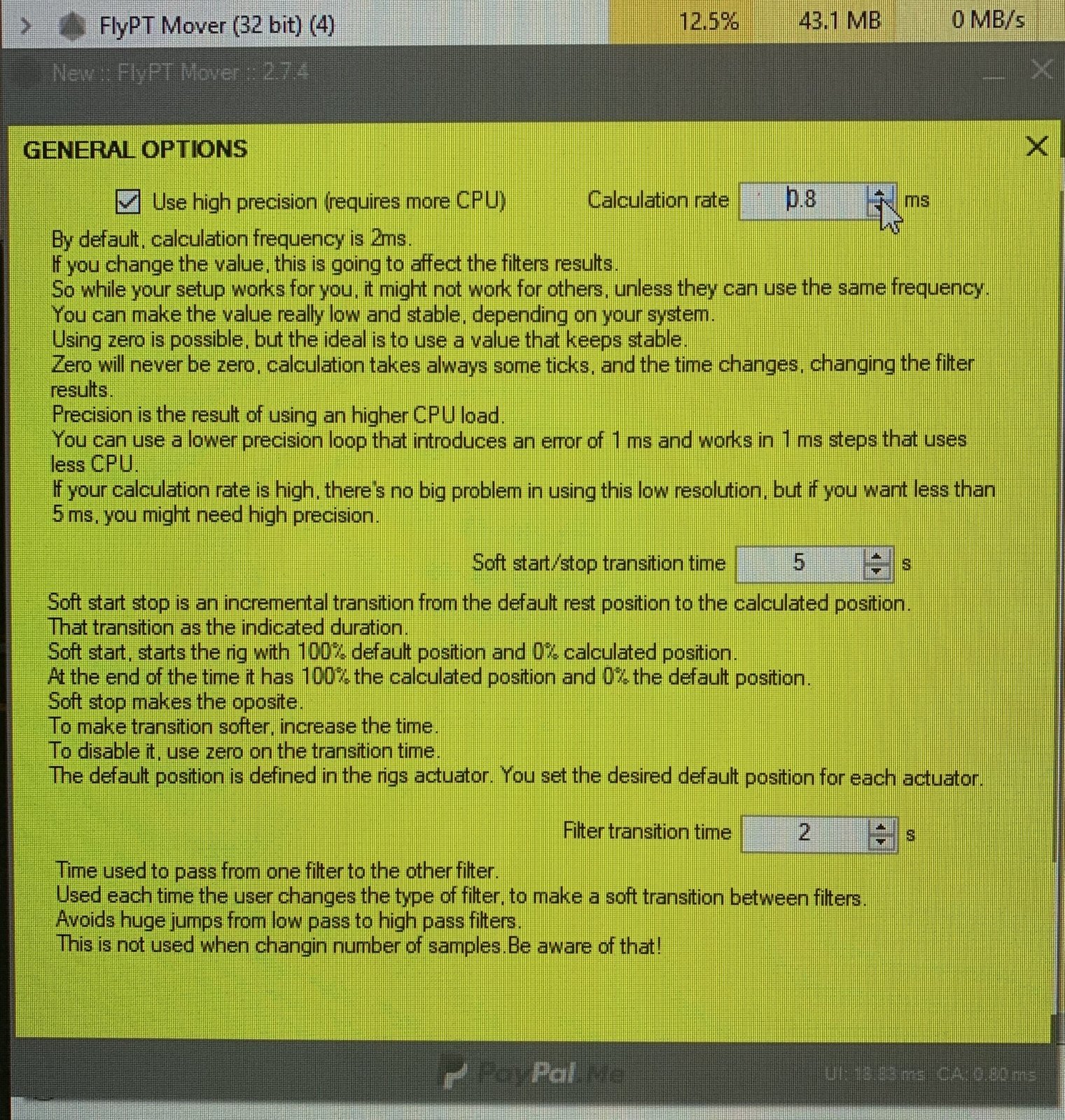

    That’s what we have now:
    Dependency with other software eradicated.
    39D25F2B-A226-4CCA-B435-9F2C9AE1E361.jpeg 3CD9260B-C70E-47E4-9497-4F2002FB8BA6.jpeg F9CFB7CE-12E3-4578-98FF-3683B00EE8B4.jpeg

    The low resolution works in 1 ms steps, so anything under 1, rounds to 1.
    1.1 rounds to 2 ms.
    For now, can't do better. Maybe a 64 bit build, don't see big advantages, but everyone is on 64 bits now, so next one will be 64 bits.

    It’s looks good !
    You have not to forget to diminish the modules to the GUI. Than the consumption is dropping to 0~ 0.5%
    Diminish the main window is not enough
    Good.
    Now I have to retune all the filters

    This was changing the filters behaviour, it's now way more stable. If you hide everything, it really becomes lighter.
    Updating the interface is really heavy. It's Windows... The worst is the graphics.

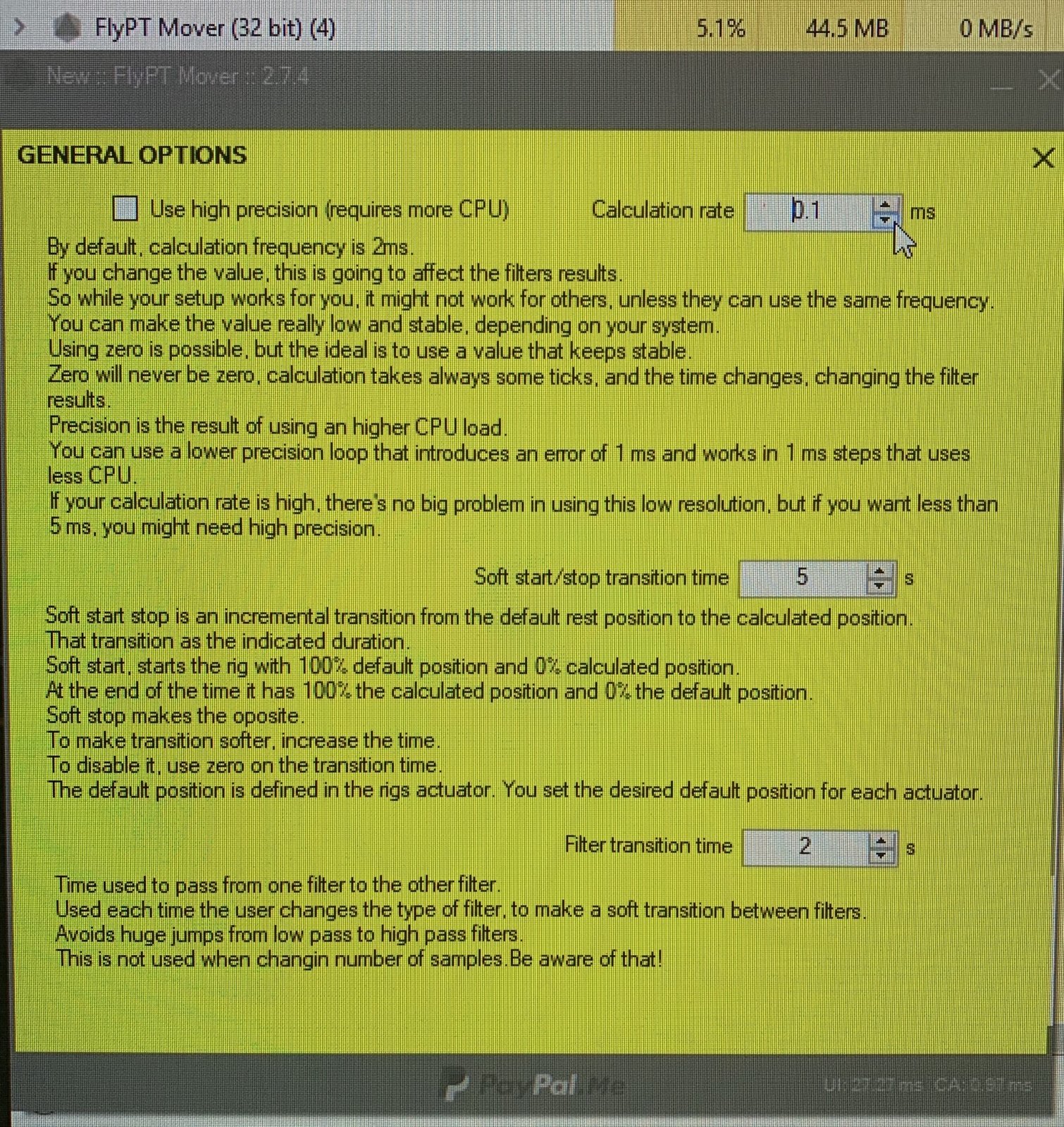

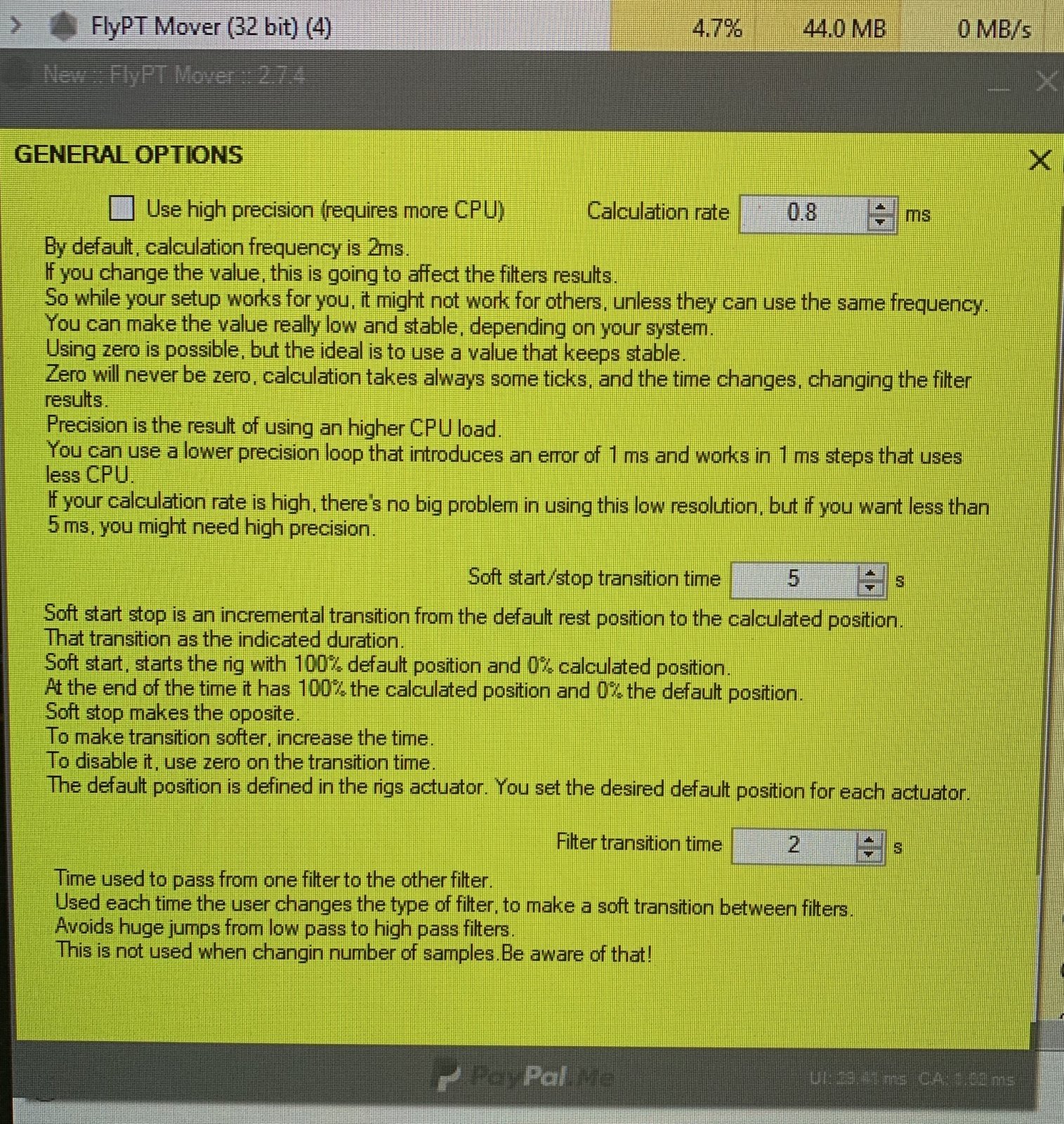

    I mean there is no difference in consumption if the GUI is reduced or not. The modules have to be hidden. That is the trick !
    High precision doesn’t work in my setup under 1 ms. where the motion is extremely jerky.
    With 1ms the consumption is around 10% load.
    By unchecking the “high precision” it drops almost to 0% load and honestly I can’t feel any difference in behavior.
    So I am leaving 1ms in the settings with “high precision” unchecked.
    If the calculations are made, like displayed, under 1ms for almost 0% load, it’s a fantastic score I think.
    Good job !
