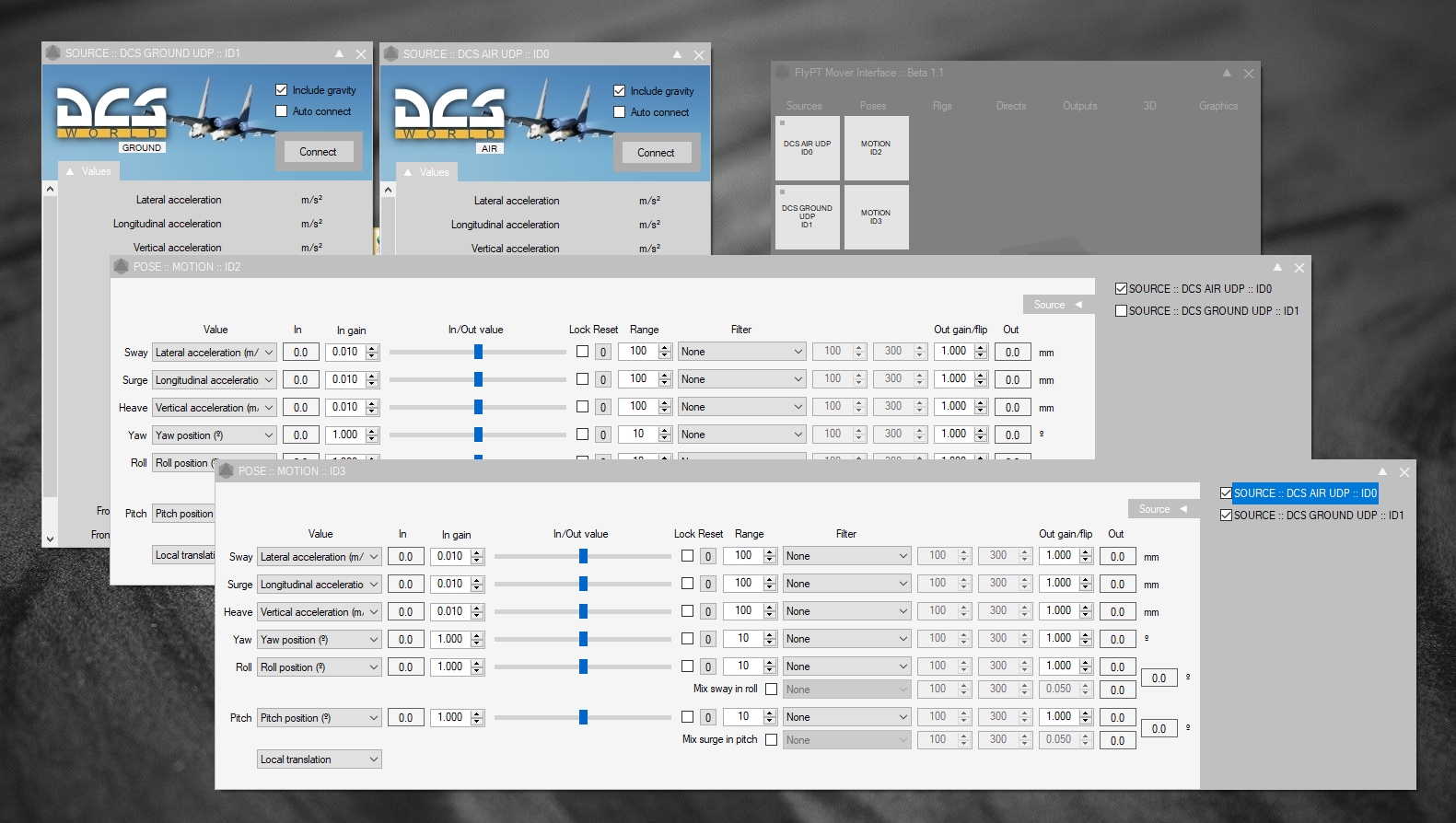

    We now have two sources for DCS.
    An Air source that uses UDP port 4123 and a ground source in port 4124.
    Add the two in FlyPT Mover and make specific poses.
    The Lua file sends data to one of the sources only.
    Inside the Lua, I make a test to the gear suspension. If there's info, data is sent to grounded source, else it's sent to air source.
    Don't forget to replace the Lua script!
    And be careful, to select only one source for each pose.
    In the image above, one of the poses uses the two sources and in this case it's wrong, since we want to separate them.

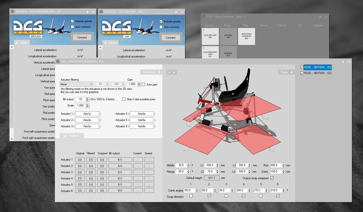

    Now that you have two poses, one for ground, another for air, go to the rig and select both on the right.
    The rig now uses the sum of the two to generate a pose:

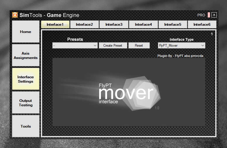

    New SimTools plugin:
    What is the difference?
    It works and sends data in doubles to FlyPT Mover using a memory mapped file.
    Install it just like the other SimTools plugins.

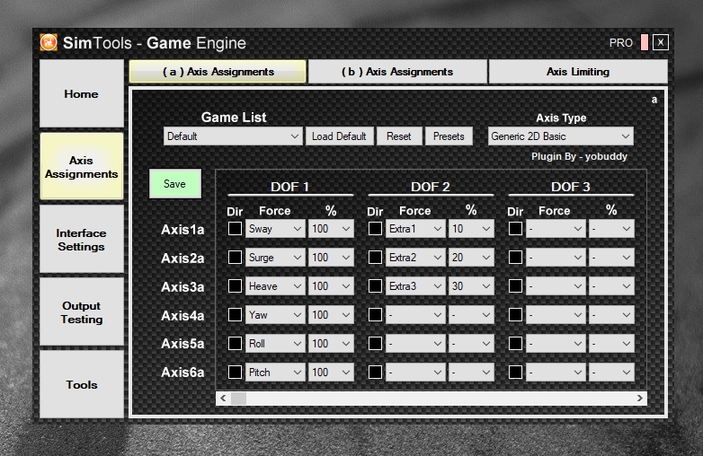

    It's sending the 12 axis generated by SimTools:
    - Axis1a, Axis2a....
    - Axis1b, Axis2b....​
    So now we can send:
    - Sway
    - Surge
    - Heave
    - Yaw
    - Roll
    - Pitch
    - Extra1
    - Extra2
    - Extra3​
    in it's "pure" value or mixed by the axis assignments:

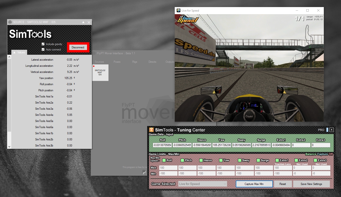

    The values show in FlyPT Mover this way:
    - Lateral acceleration equal to Axis1a (-100 to 100 m/s^2)
    - Longitudinal acceleration equal to Axis2a (-100 to 100 m/s^2)
    - Vertical acceleration equal to Axis3a (-100 to 100 m/s^2)
    - Yaw position equal to Axis4a (-180 to 180º)
    - Roll position equal to Axis5a (-180 to 180º)
    - Pitch position equal to Axis6a (-180 to 180º)
    - SimTools Axis1a equal to Axis1a (-10 to 10)
    - SimTools Axis2a equal to Axis2a (-10 to 10)
    - SimTools Axis3a equal to Axis3a (-10 to 10)
    - SimTools Axis4a equal to Axis4a (-10 to 10)
    - SimTools Axis5a equal to Axis5a (-10 to 10)
    - SimTools Axis6a equal to Axis6a (-10 to 10)
    - SimTools Axis1b equal to Axis1b (-10 to 10)
    - SimTools Axis2b equal to Axis2b (-10 to 10)
    - SimTools Axis3b equal to Axis3b (-10 to 10)
    - SimTools Axis4b equal to Axis4b (-10 to 10)
    - SimTools Axis5b equal to Axis5b (-10 to 10)
    - SimTools Axis6b equal to Axis6b (-10 to 10)​

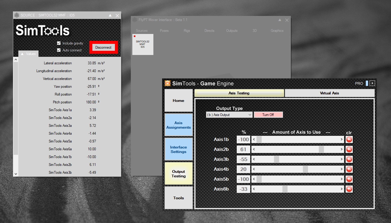

    So if you want "pure" sway, use 100% sway only in Axis1a. Make the same for others.
    The values are received between -1 and 1 and multiplied by scallers to generate the values presented above.
    If you want a relation 1:1 with the games, you have to use the following values in the tunning center of SimTools:
