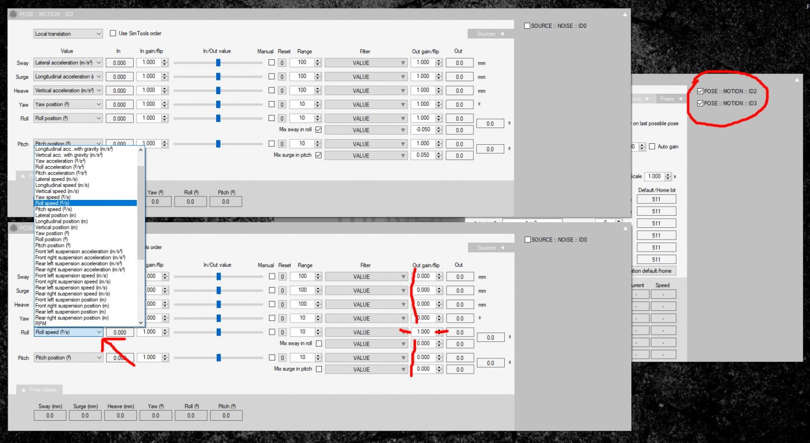

    Hi guys, sorry,
    thought I would get a free weekend for my rig and mover... :( well, got a free weekend for family it's also good!
    So will get some moments out of work during the week to solve all those problems and try to answer everyone.
    That problem with the IP... Are you sure that's your IP?
    Do you have an anti virus or did you allow Mover on the firewall, on the first run.
    That's strange, because I have no problems. Just tested it and can use it even in a remote PC.
    To mix the values, do like @hexpod said.
    Add two motion modules.
    In the left select the values you want for each DOF.
    In the rig use both modules.
    The result motion is the sum of both modules. So if you want just to add a value to roll, keep the others with zero (change gain to zero).

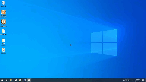

  8. TSHracing
    TSHracing New Member
    Dec 14, 2017
    26
    Canada
    299Coins
    Also here is a video showing the procedure and the settings I'm using to launch and move the rig (but with no good results at the motors themselves).
    As I mentioned earlier
    I will test with these values later today.
    As for the USB, I'll double check, but all I can say is that SMC3 Windows utility was able to drive all motors so the USB port works fine.
    I recorded a video showing the settings and steps I did to launch and start the software but I was unable to upload here to the post (it is a gif file and the size is about 11MB), any idea hot to send to you?

    Ok, I made the video again with less resolution and less frame rate.

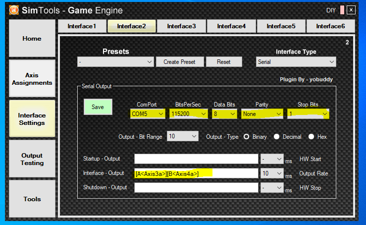

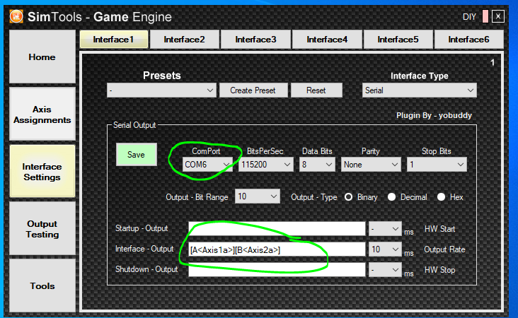

  19. noorbeast
    21,720
    152,027Coins
    +11,062 / 56 / -2
    Please post a picture of your SimTools Interface Settings.
  20. TSHracing
    Dec 14, 2017
    26
    Canada
    299Coins
    Thank you for your interst in helping @noorbeast , here are the three serial interfaces I have, these are what I used when tried to connect directly from simtool without MOVER:
