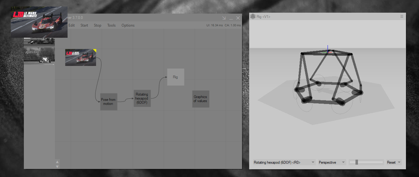

    Beta really soon for all to try:
    Decided to cut some features to have a release. They will come with the updates that will follow.
    Many bugs that I hope to have some feedback/help to solve them.
    Release: 20 September 2024, so keep an eye on it.
    User manual will slowlly be updated to the new release. Priority is the bug squashing and implementation of the incomplete features. So it's my itention to have a good rate on the updates.
    I think it will be better to have a new topic for the new release. There's many changes in filters/operations and actuators. Setups for old Mover are not compatible, but can be imported in a future release (feature to be implemented yet).
    EDIT: Need to sleep, writed October and I meant September :blush

    Why not record a small test...
