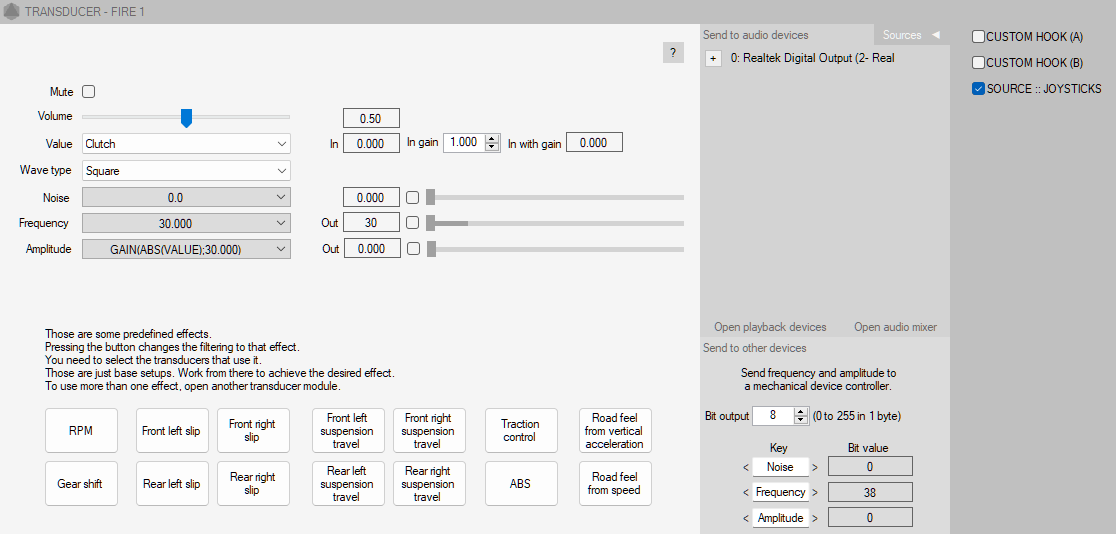

    I have another issue/question - with the vibration feedback. I use 3 different sound-generating functions in Elite Dangerous - fire1, fire2 and throttle. I also use engine RPM and Gear shift in Euro Truck Simulator. They all work fine, but they share the same behaviour: when the profile is loaded they all generate loud continuos noise/vibration by default. It disappears after all sources for the sounds are triggered once. I.e. I need to press both joystick fire buttons and move the throttle a bit - and then it's all quiet and works perfectly from that point. Throttle on 0 is quiet, same for joystick - only vibrating on pressing buttons.
    What could be the reason for that? Is there any way to prevent it from vibrating on initial load, and why is it doing that? Here's how a typical transducer function looks on my profiles:

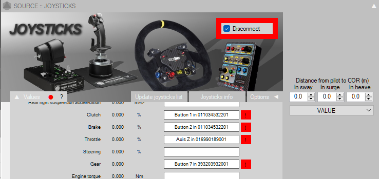

    Joystick buttons and axes are mapped to otherwise unused variables - clutch in this case:
  18. sallerding
