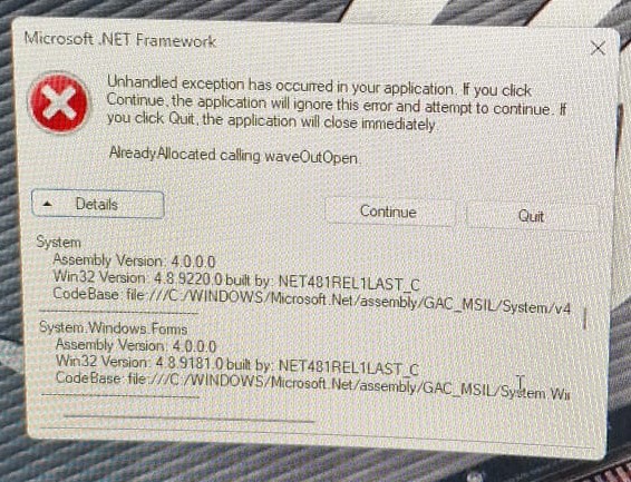

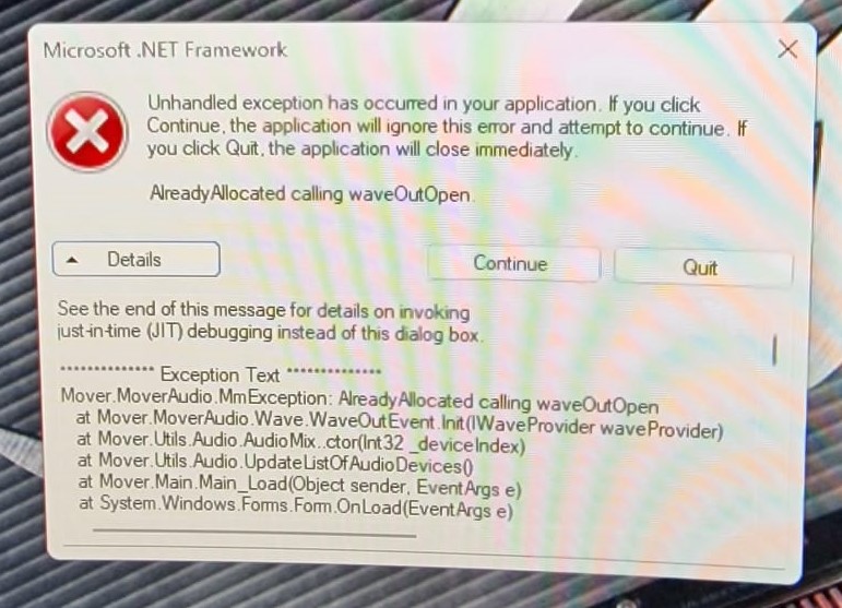

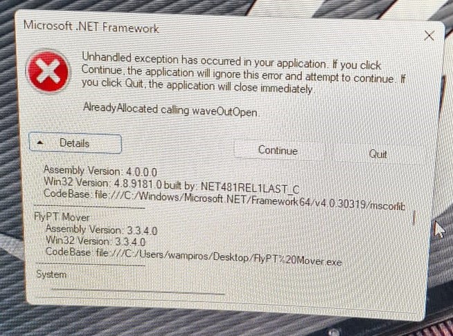

    Hi guys... I have a problem:
    I'm trying to use FlyPt on a recently installed PC (Win11 23H2) but when I open FlyPt I get this error:
    6f793a64-c1c4-442b-990d-7ccacef8a0bc.jpg 56e84b9c-6fd7-401a-80d5-3e3e9cc2842d.jpg 68c7d08a-5ab6-41b3-bda8-fd54346e720d.jpg
    if I try to select 'continue' the software starts but 'UI' and 'CA' remain fixed at 0.0
    If I try to load a profile it apparently loads it but when I connect the button stays solid yellow and never turns red.
    Trying to open the profile (after having set the options to open .mover files with FlyPt), the software starts but only the main screen is empty without actually loading the profile.
    The .NET Framework 3.5 and 4.8 appear to be installed.
    Trying the program on another apparently identical machine, FlyPt mover works perfectly.
    Can you help me?

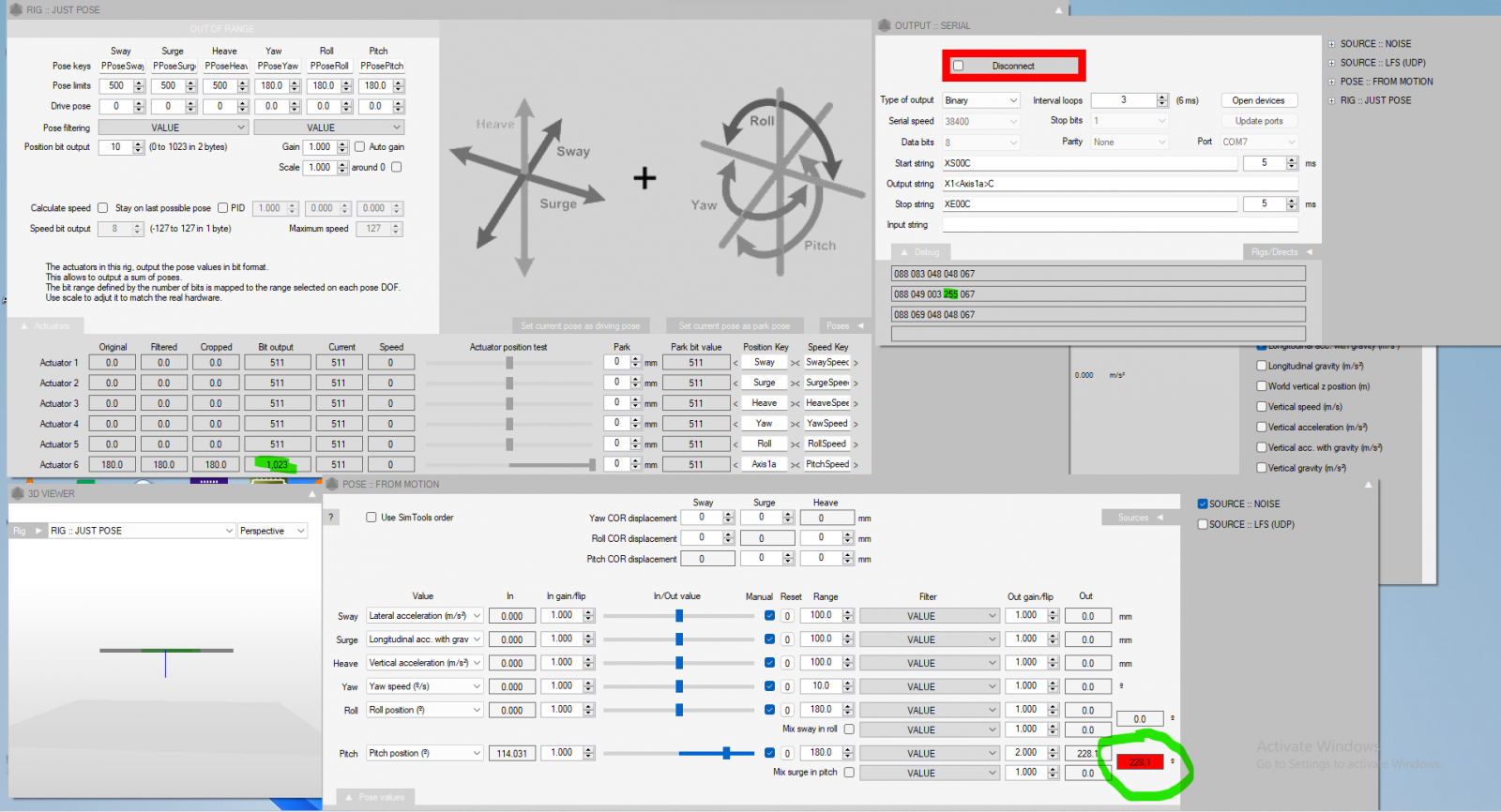

  18. Grucho
    Grucho Member
    Jan 3, 2023
    48
    232Coins
    +10 / 1 / -0
    I modified the code on arduino to be able to get past 360. Now I think the problem still remain with flypt. In the screenshot below I try to manually set the simulator to go over +180 in one direction. The problem is that once I pass the 180 flypt does't send any signal anymore to the hardware but it is stucked at it's limit of 255 bit or 180°. Not sure how to pass the data to arduino from here.
    Here the screenshot:
  19. pmvcda
    pmvcda aka FlyPT
    Nov 3, 2010
    2,237
    Portugal
    15,702Coins
    +2,674 / 17 / -0
    Do you have a multichannel audio installed?
    The problem might be there.
    Try to remove the transducer module from the setup if you have if
  20. pmvcda
    pmvcda aka FlyPT
    Nov 3, 2010
    2,237
    Portugal
    15,702Coins
    +2,674 / 17 / -0
    Why do you have a gain of 2 in the pitch?
    Please remove it.
    When a game sends pitch, it will come from -180 to 180 (and even that is not correct it should be -90 to 90).
