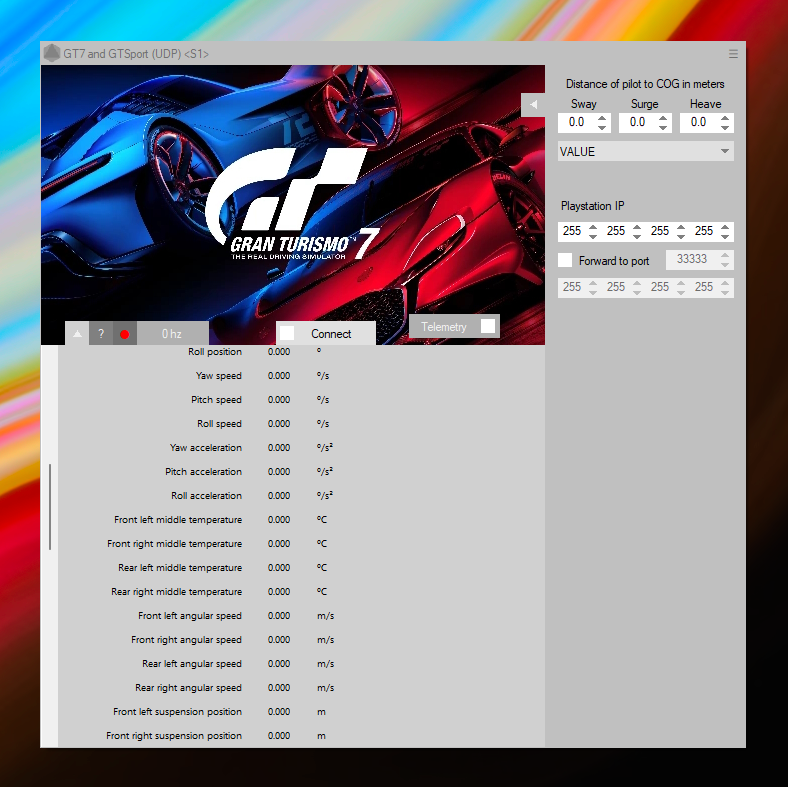

    That's great news, any idea when this release 4 is ready? I'm trying really hard to get my belt tensioner to work with FlyPT and GT7. But to no success yet. I hoped that I could use simtools3 with GT7 support as a source in FlyPT. But I only see support for v2.
    And I have no clue on how to make GT7 work with the v2. Do you have any advice maybe?

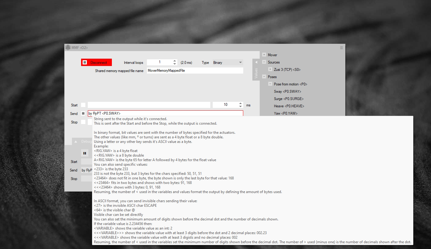

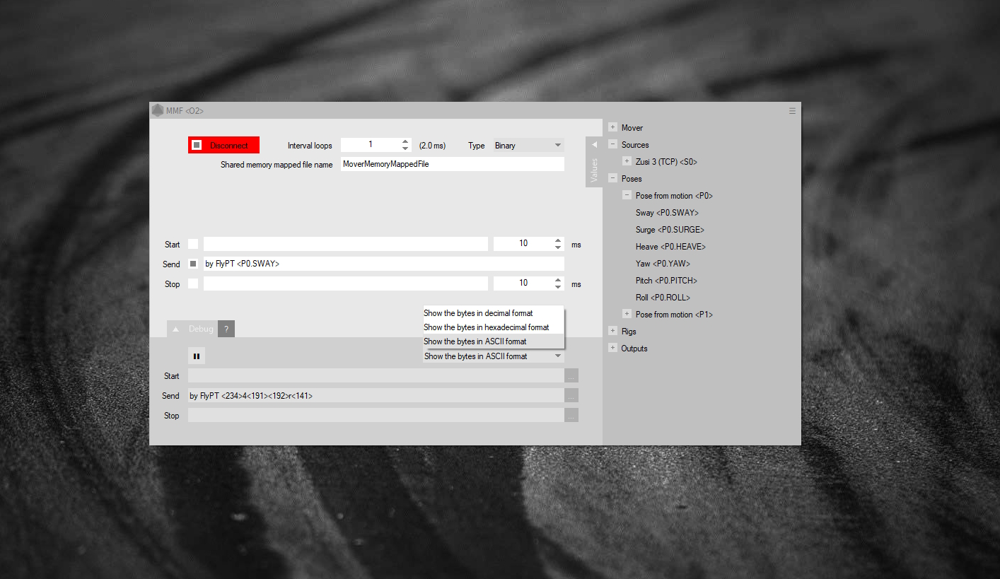

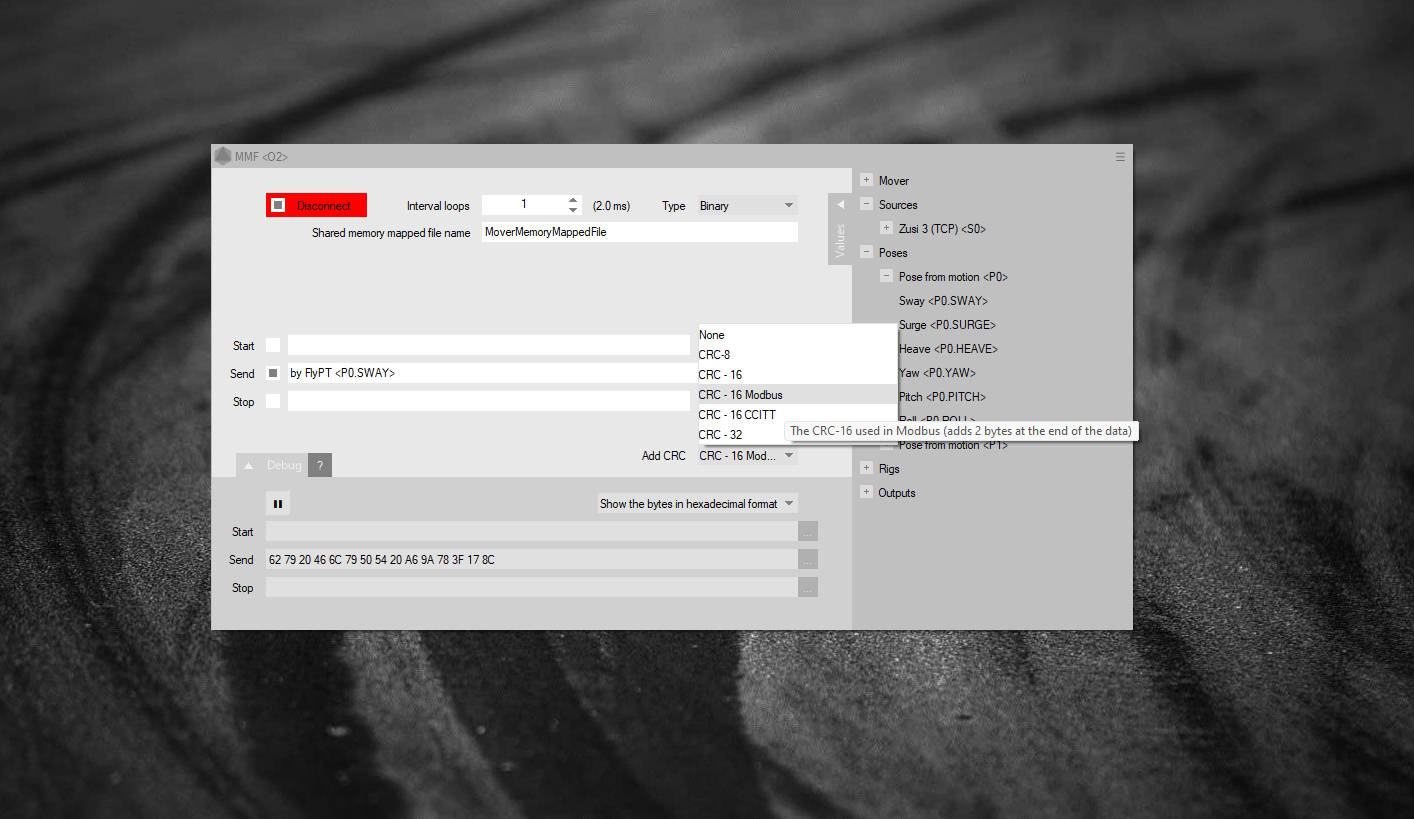

    Just some news...
    Working on some output bugs and took the chance to take some images:
    Now we can add CRC check to the output.
    We can also debug the bytes in 3 formats. We can also pause the output to check the values in the debug.
    The string is now more advanced. We access any variable in mover and use the < to indicate the number of bytes. That's why the tooltip is so big...
    Need to correct the spelling.
    Almost there, but so many bugs :eek:

    MODBUS ??? Does it mean that we can avoid using controller boards ?!?! Could be enough of a USB Hub with serial converters? Woooowww :grin:grin:grin

    I think it's possible. I still have to test it.
    If you send the correct data with the crc for modbus, it should work.
    But let me test to be sure it's possible
