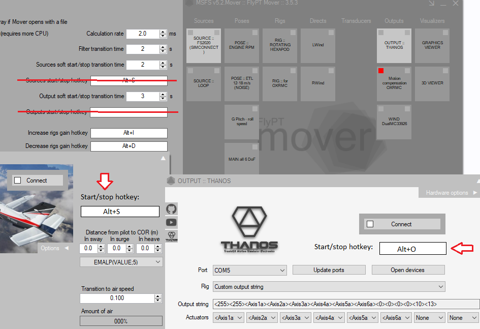

    Hi Pedro, wondering if this enhancement could make it to the next version - Currently the hotkeys for sources and outputs apply to ALL sources and outputs. I have a test loop stored that i don't need to toggle, and some of my outputs I would rather just stay enabled when stopping thanos output. Could this key assignment move separately to the sources and outputs themselves?

    I think we have to leave it for later.
    The mess is so big right now, that I just want it to work... :confused:
    But it would be great to have it. I think it might be easy to add with the new code for input.
    The way I have it and adding the feature you could keeep a key for all and specific keys for each one (two keys for each).
    One of the problems is the behaviour when you have some connected and others disconnected, would a general key disable/enable all or invert the states (think the first one is the solution).
    Maybe it would be better to have a key to enable and another to disable :think.
    Kind of rich people problems....
    By the way, you can use joystick buttons already, instead of keyboard keys

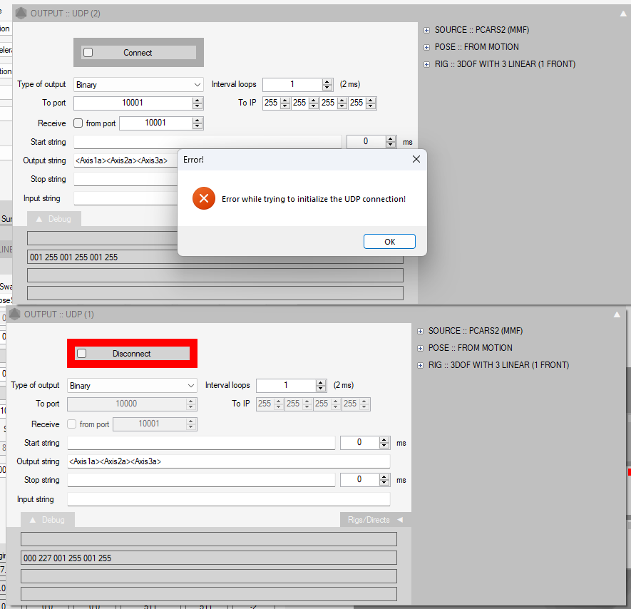

    Third question: With simtools I was able to use 2 UDP interfaces, it seems it's not the case with Mover. I must use 2 serials instead.
    Any plan to support 2 UDP output modules at the same time in the future ?

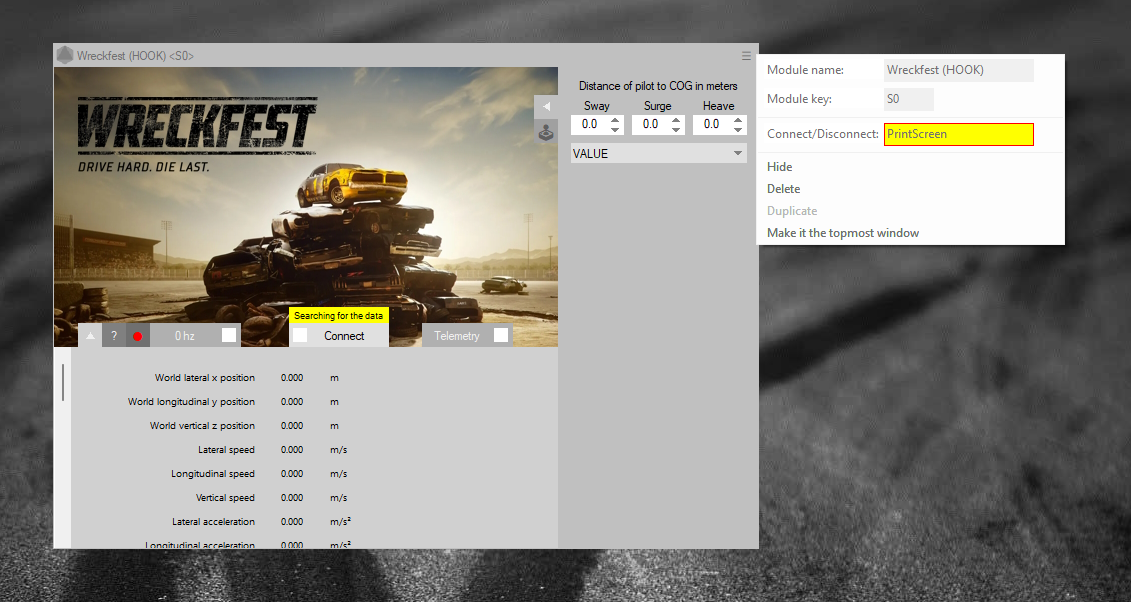

    Well I just found it would be easier than I thought:
    It will show on the menu instead of the window (easier), but I have a problem with the ALT colosing the menu. I will solve it.
    It shows PrintScreen because I was detecting the hot control and pressed that key.

    Yes, that's good, but filters on the actuator don't shown in the 3d view. For that I would need forward kinematics.
    You can add multiple UDP outputs. Not with the same port.

    I did try to use another UDP module with another port but it gave an error about initializing the UPD stuff. I can enable then independently but not at the same time.
    You can try to repro this even without a controller with you.

    I missed that. That's a strange one. It should work.
    I will test for the new release.
    Thank's
    Edit:
    Can you try to change the port on the receive to be different from all the others also.

    I'm not near my rig but now I can activate both on another computer, it is a good sign. But I guess normally it shouldn't be needed when "Receive from port" is unchecked.
    Edit seems to have to do with the check box, I ticked and untick it and the port selection became gray. Probably some bad initial condition with the checkbox.
