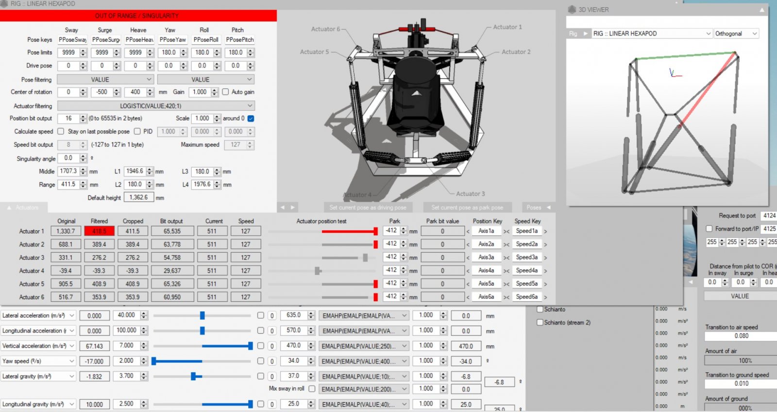

    Hello, I need some advice, In the "OUTPUT :: Motion compensation for OVRMC" I need to have the rig's position after the actuators filtering. I'm using logistic filtering in "Actuator filtering" so that, when the actuators approach the limit, the speed slows down in order not to have a brusque stop but a smooth, amortized, stop but in the Motion Compensation I see the 6DOF positions bypassing the actuators filtering.
    In theory, I would need to have the positions that I see in the "OUTPUT :: UDP" module but unfortunately from this module, there are the positions of the axes not of the 6DOF
    Does anyone have a solution to my issue? Maybe there is another way to smooth the actuators' limit reaching to avoid MC problems?

    For that we need to have forward kinematics.
    And Althought the code is already prepared to add it, the cpu load is high and for now I don't have a solution.
    Resuming, we need to calculate the pose from the actuators position and it's easy on some basic rigs, but in hexapods there's many solutions and complex calculations that take to much time.
    I tried going with iterations but it was not working and was also slow.
    Some faster solutions exist, but we need to know some extra measures and for that we need more actuators....
    So for now I recomend you to use filtering in the pose instead of actuators. Sorry.
    The next release is also ready to add it and has some features intended for it, but I will look at it after the release.

    Thanks a lot, Pedro, meanwhile I'm solving with the level of logistic filter in the actuators, like in the picture, where the final pose is much further than the actual physique limit, as you can see the actuators on the mover overcome much their stroke but are cropped by the logistic, this is a workaround solution. This way works quite well but the issue is the motion compensation with the virtual tracker, with a physics tracker I would solve but I can't use this solution.
    Unfortunately, I can't filter the pose because when I reach more DOFs limit at the same time, for example, Pitch and heave, if I have already reached the limit of pitch and come a quick heave the actuator more extended get a brusque stop.
    Thank you very much.

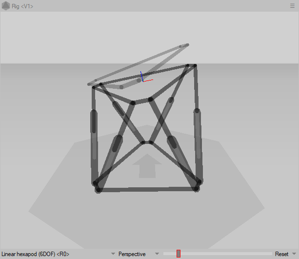

    For the next release I have another solution.
    We can choose 3 types of motion for the rig:
    First one is a follow alghorithm. It follows the requested pose even if she's out of range. It might induce some false cues, but keeps track of the pose for motion compensation and the rig is always moving.
    Second one stops moving the rig when she's out of range and when the rig goes back to range it transitions to the new valid pose. This avoids sudden movements on the rig and keeps track of the pose for motion compensation..
    Third one is what we have right now, actuators move while there's range but if one goes out of range we loose track of the pose for motion compensation.
    I think that using the first one might be the better solution
    In the viewer, we can see the ghost showing the requested pose and the rig in the possible pose, following the requested one.

    Yes right Pedro the first option looks the best. Thank you very much for all your efforts.
