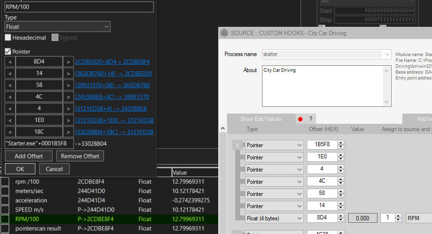

    I too am getting these jolts on ground to air switching.. try some filtering on the Rig page, in the Actuators field. That catches everything sent by the poses. Also the transition speed on the Source page can be slowed down. I havent figured it out completely but they are much smaller jolts
  4. smitty
    smitty Active Member
    Aug 24, 2021
    148
    916Coins
    +207 / 2 / -0

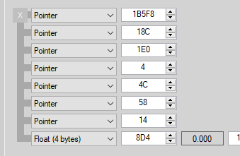

    I am trying to get Custom Hooks going for City Car Driving. I believe i have found the pointers correctly in cheatengine, but in flypt i get no data. I also tried running Mover as admin. Is there something else i am doing wrong?
  5. smitty
    Aug 24, 2021
    148
    916Coins
    +207 / 2 / -0
    i noticed i missed a pointer 18C in the above but it still is not getting a value
  6. pmvcda
    pmvcda aka FlyPT
    Nov 3, 2010
    2,180
    Portugal
    15,391Coins
    +2,601 / 17 / -0
    Is the game 32bits or 64?
    Mover should be running with administrator privilege
